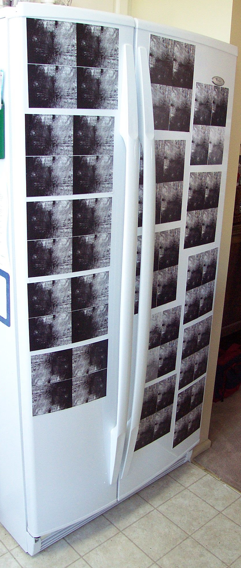

For RC, I air dry my prints by standing them in racks. You can also roll them on to a smooth surface and let them air dry. Here is my refrigerator performing that task with some submissions for a Postcard exchange from a few years ago.:
Well I'm just learning the site. Roll them with what? And how did you stick the prints to the fridge? I'm going to get dozens of suggestions on how to dry my prints. Someone said towel and someone said no towel. So I'm confused. That's the problem here too many suggestions it's confuses my brain. I don't have money for racks. Right now I have rope to hang across with wooden clothes pins. I have a towel and I also have a squeegee that you use for negatives. Would that also work for paper? The rubber from the squeegee scratched my negatives so I stopped using them. And yes my towels have lint of course. I'm just looking to wipe water off before I hang them. I just need one answer. How do I remove water from my prints? I was told a towel and now no towel. I know how to hang them I just need to know what to use without scratching the paper. I'm trying not to spend money. Can I use a new dish squeegee? Thanks!
I like this fridge idea. I'd like to know what you roll your prints with. I think this would eliminate risks of marking up my paper corners.

A squeegee, I use a Libman window squeegee, about 5 bucks. Don't use directly on the print face, I have a poly squeegee board, lay the print face down then squeegee it from the backside, keep your fingers ahold of a corner to keep the print from sticking.
Then use a rack or hang dry. I have an Ilfospeed dryer that will dry an 8x10 in about 10 seconds, pretty slick.
As far as a squeegee board goes, it needs to be immaculately clean, able to take pressure. Matt's fridge worked, needs to be smooth not textured metal, glass window would work, or maybe a sliding glass door. Again I don't leave the prints stuck to anything.

Ohh, I reckon Matt stuck those postcards on the fridge wet, rather than rolled them on with some device (could be wrong). Once they drop off, they're dry.
