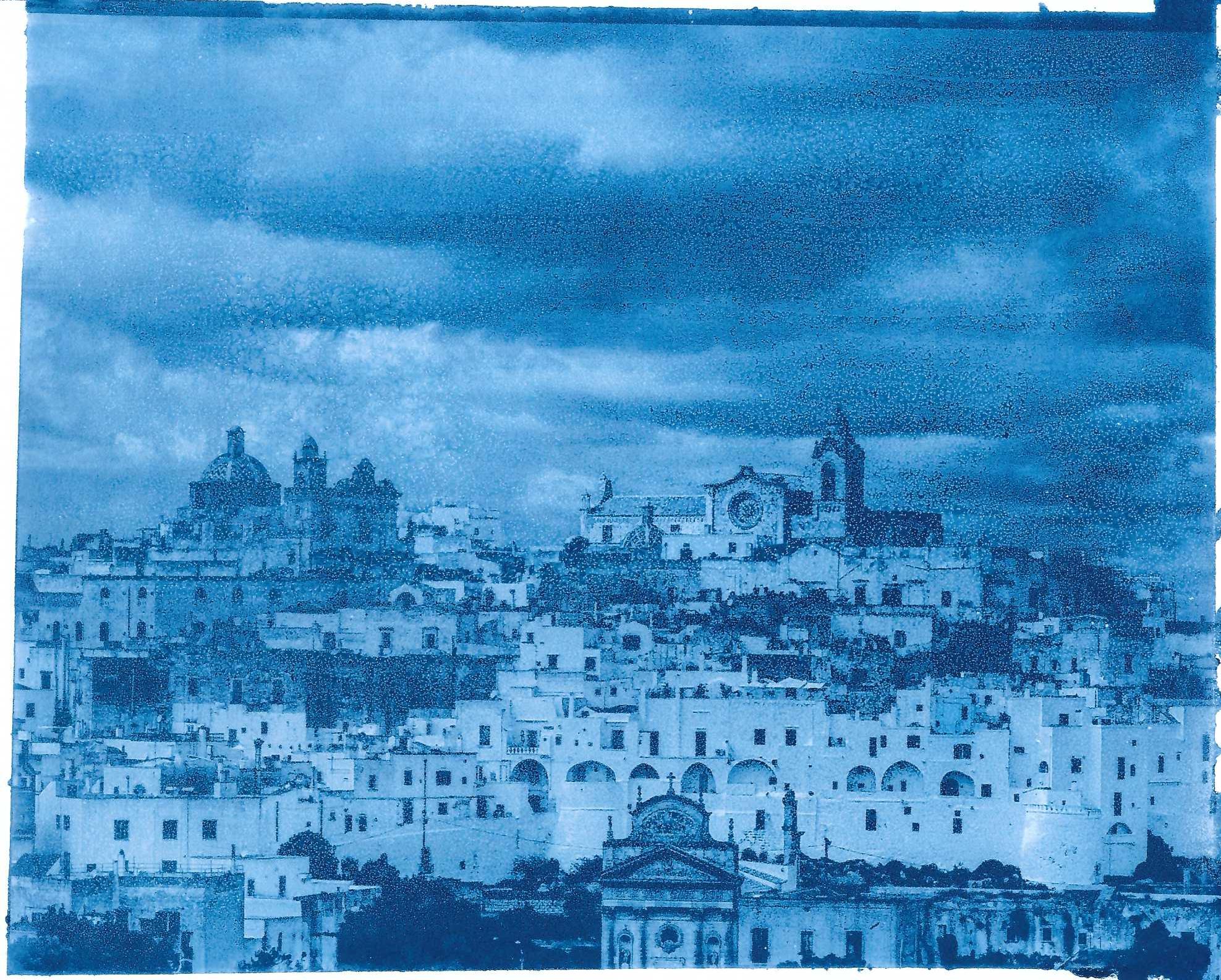

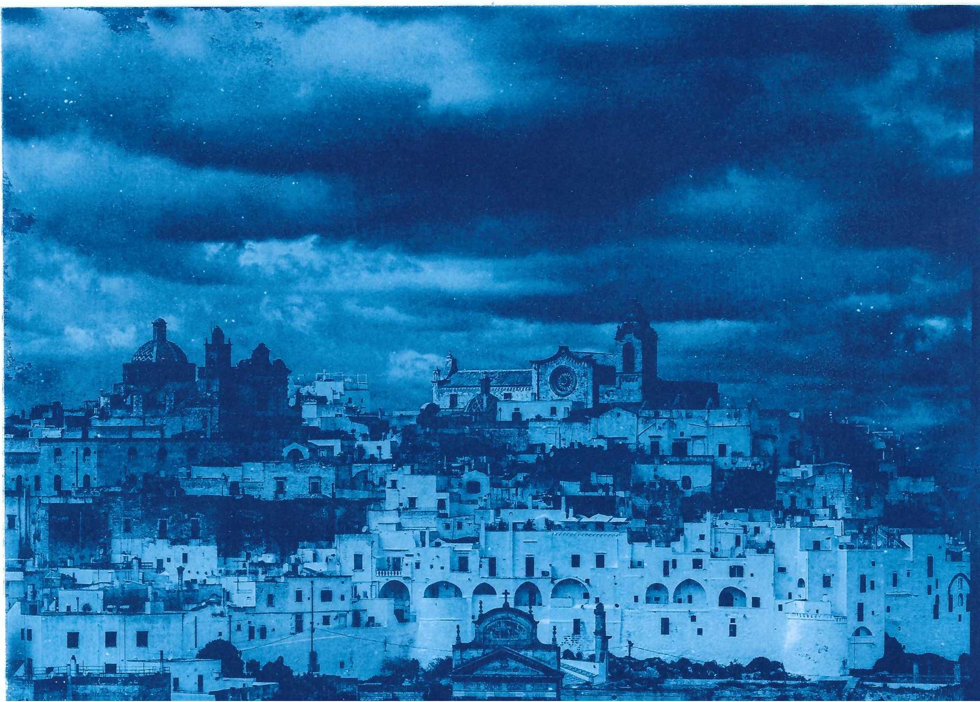

As promised, here are two prints I made. You can see clearly the effects of the crystals. On #1 you may be able to see the brush strokes. That is on the Arches Platine. The #2 is dark, admittedly, and is on COT320. I don't find the brush strokes apparent, but do see the crystals. I poured the sensitizer on both and then brushed it as easily as I ever have. Any observations from your experience appreciated. Thx Dennis
This looks a lot like crystal formation to me.
Since you already work with the classic formula, you might want to try a 50/50 mix of new and classic, as it eliminates the crystallization issue. A few well known alt printers use this hybrid approach - Sam Wang comes to mind.

This looks to me like it might be an issue with his the paper fails to absorb the sensitizer. Things you could try:
* Dilute the sensitizer a bit
* Add some surfactant
* Soak the paper in plain water, then dry it and try coating again.
Sometimes it's also as simple as trying the backside of the paper, as both sides often show differences in rheology.
