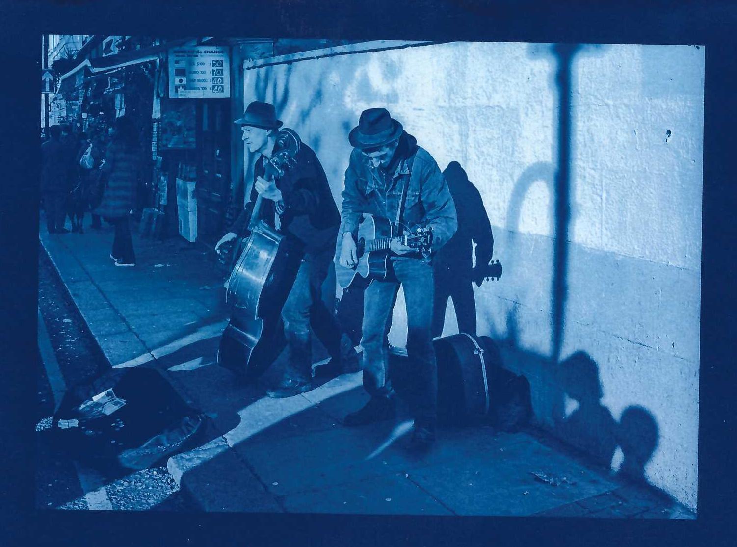

I believe diluting the solution will be the answer to my problems. I printed two images, both well overexposed, which I believe is good news. The new Cyanotype is supposed to have a shorter exposure time. I hope to dial this in in the next couple of days. You all have been a great help.

I'm still trying to dial in exposure. I also slightly re-engineered my curve, printed a photo for 7 mins, and it is close; likely will need 7'30" for optimal exposure. This compared to 12'30" before dilution. I'm not a chemist, didn't even take chemistry in school, but that sounds a bit counterintuitive. I have put a scant drop of tween20 in my 30 drops of sensitizer and am using Arches Aquarelle. So far, no issue coating, no brush marks, and no graininess, as well as no crystallization. I'm thrilled! I'll print another and post the results later.

I believe I have been able to surmount the obvious problems new cyanotype has been dealing me with a simple 20% dilution of the solution. Now, I would love to hear how I can improve it. Do you see some evidence of fogging in the image?
