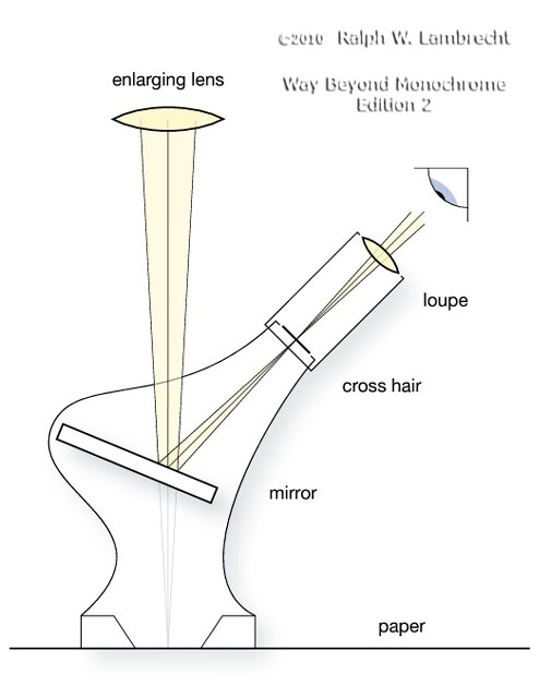

Manufacturers of focusing aids make no assumption about unknown paper or whatever thicknesses. The focus plane is always the bottom of your focusing aid. Whatever you set the focusing aid down on, that's the focusing plane. Please, see the file attached.
