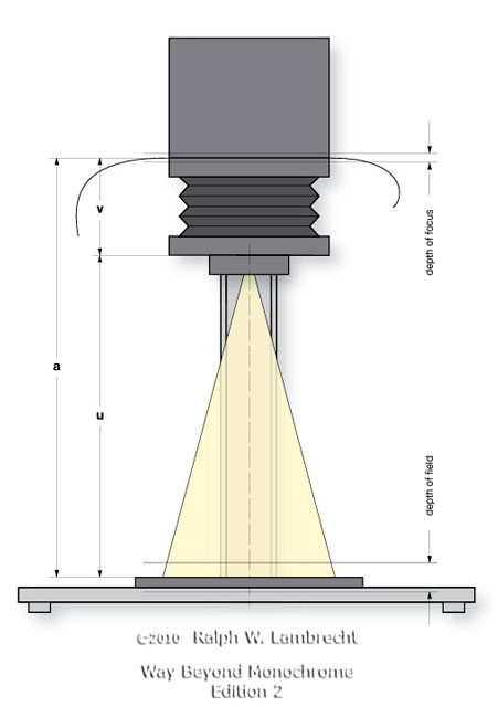

Maybe we need a "Stickey Thread" to explain how to focus an enlarger for optimum depth of field and minimum diffraction. This question seems to come up frequently.
The size of Airy disks and circles of confusion can be optimized for any depth of field required as represented in this slight modification of the view camera focusing equation (equation #38 in http://www.largeformatphotography.info/articles/DoFinDepth.pdf:
N_max ~ 20 / (1 + m) sqrt(dv)
N-max = F number
m = magnification
dv = focusing leeway on the baseboard, represented as the distance on the enlarger column between good focus on the highest and lowest portions of the curved or askew negative. (if 'dv' is zero then your negative is not curved or enlarger/baseboard/easel is not askew)
20 = constant for circle of confusion about 0.15mm on the print
To focus your enlarger use the following sequence (based on curved negative in an aligned enlarger). Use different high and low areas if alignment is in question (like far edges of the diagonal).
Focus on the center of the image. Note the distance marker on your enlarger column. Then (without touching the focus knob) move the enlarger head downward to focus on a corner. Make note of the distance between the two points in millimeters ("dv" in the equation above). Then position the head at the middle point between the two positions. You can use the formula to find your optimum f-stop after you figure out your magnification.
The constant of 20 is my own, based on how I look at my prints. You can calculate your own value that may or may not be the same.

Yes, it can be done either way. The math stays the same. As David says, it's matter of semantics in the end. I try to remember it as the depth of focus always being at the film or negative plane.
I think this is what photographers usually do, but my impression is that optical engineers refer to "depth of focus" at the image plane (film in a camera, paper in an enlarger) and "depth of field" at the object plane (the photographic subject in a camera, film in an enlarger), just to make matters more confusing.

75mm/f:4.5 Grandagon-N wide open on 4x5".
A Grandagon-N is an asymmetric lens, but measuring with a ruler, it's not by much. I get an exit pupil of 15mm for an entrance pupil of 16mm. Maybe someone has a spec sheet that's more accurate. In any case, it's closer to a symmetric lens than I would have guessed.
So if I have the formula right--
depth of focus at the image plane=2 * f-number * acceptable CoC (1+Magnification/P)
where P=exit pupil/entrance pupil
So let's say the Magnification is around 4.5 and we go with what I could see with a 6x loupe (depth of focus slightly less than 2mm--call it 1.8mm),
Acceptable CoC for me in that situation is around .034mm then. "Standard" CoC for 4x5" would be around .09mm (your table has 0.89mm, and f/Calc, which I think uses the Zeiss method, has .094011mm)

I used your data provided in post #56 and 69 and did some calculations. The results verify your observations described in post #56.
assumptions:
4x5-inch negative
4x magnification (16x20-inch print)
f/4.5
CoC = 0.030 mm (critical observation)
This calculates to a depth of field at the baseboard of 5.4 mm. You reported 5-6 mm without focusing aid. So, we have a match. You further reported an increase in detection by using a 6x focusing aid to a bit less than 2 mm. Seems reasonable, actually, I would have expected an increase closer to that of the magnification of the focusing aid, so, down to 1 mm, but OK, eyes and optics are never perfect.
This is good info. I agree with your data, and your reported observations sound reasonable.

Double-weight paper has a thickness of roughly 0.25 mm. You were able to detect a 2 mm difference with a 6x focusing aid. The top model from Peak has a magnification of 10x, so, you might be able to detect a 1.2 mm difference with it. I have a 20x focusing aid, with that, let's say 0.6 mm? Of course, we'll lose a bit to the optics again, but let's forget about that for now.
It looks like you are still off from seeing the difference between 'paper' and 'no paper' by a factor of 3x. And this was already assuming critical viewing CoC (0.030), not a huge enlargement (4x), wide open lens (f/4.5) and the highest possible focusing aid available (20x). Changing a few setting to more standard numbers, and you will be off by a factor of 10x.
I must repeat: it's impossible for you to see the difference of a piece of paper under the focusing aid.
But, what's more important, even if you see it under a 10x focusing aid, you'll never see it in the print. Also, your printing paper won't be flat enough to stay within 0.2 mm, and your negative carrier and enlarger alignment won't be good enough to support this ideal condition. So, it looks like we are sweating the small stuff, while the big stuff is eating our lunch.
However, I still think, we are making way too big of a deal of this. If you feel more comfortable to place a piece of paper under the focusing aid, by all means do so. After all, it makes it theoretically perfect. It won't matter, but it won't hurt either.
I also think we are making too much of it. Use paper if you want, don't if you don't want to but either way we can't say that one way is better than the other.
I doubt that our enlargers can be focused with enough precision for it to make a difference anyway.
