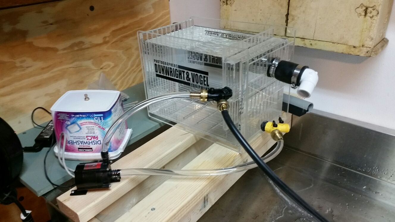

Phase one. Pump to circulate water. Next step set up a dump and refill setup. Idea is to run 3 , 5 gallon washes rather than 1 gallon a minute for 45 minutes, Thoughts? Dump water goes to pre rinse prints before putting in washer. Mag drive pump from a Noritsu processor. Kinda thinking a gas burst agitation might be cool too.
I have had one of these D&V print washers on the shelf for years and am finally getting around to using it for 16x20. I was under the assumption that it drained from the bottom. Are you using the bottom drain to force water back in to re-circulate?
The overflow has a baffle that leads to the bottom. So in regular operation water comes in the top, is forced through the jets I each slot. The way I have this plumbed is the drain plug, that is used to drain the washer, this is the feed for the pump. The pump takes this water and pushes the water through the jets.
This is the same path the water takes when used normally.
These washers, no matter who made them, only work, if you crank the water flow. I have picked up 3 different washers over the years. If I used 1 gallon a minute, even on this small washer, the flow was so low that air bells would form on the surface of the print. Not good.

dswiger
Aug 15, 2012
25
No I don't. But these Japanese mag drive pumps, I think mine can run at 17 liters a minute. They're used in minilab machines. You see all kind of these pumps on ebay
Thanks for the response. Looking at a couple of them on Ebay now

Some pumps are DC, I have one of these I power it with a Dell computer power supply. Some are 100 V AC, Japan standard. I have a huge Variac (enormous dimmer) that I use to bring US voltage down to 100V. Some Internet gurus say that the US AC won't hurt the 100 V power but I don't take the chance.

Got my pumps. Trying to figure out the three wire connector. Do you recall which pair you used for power?
Thanks
dswiger
Aug 15, 2012
25
Are they AC 100V, DC??
These are 24v DC.
I think I figured it out.
Looked online for some generic mag pumps and it noted there were three wires.
There were the same as mine.
Positive - RED
Negative - BLACK
Speed control - WHITE.
The doc also mentioned that if you don't need speed control, you just tie the WHITE wire to the 24V.
If you want speed control, its a 0 - 5V control voltage
I have enough to do a run-check tomorrow
Thanks for responding

I would need to go down and look. But I think you've got it right. I didn't do anything with the white wire. Let us know how you come out, I just cobbled mine together. When I change water (not sure if it's really necessary ) I open the drain on the washer, and in addition I use a 1/2 inch id vinyl hose as a syphon to empty quick. Then I refill with a couple plastic buckets I've filled with room temperature water. I think holding the water temperature around 20°C is important. Too cold you don't have adequate washing, too warm and the emulsion gets plump and sticky.
