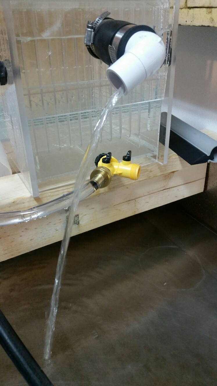

Phase one. Pump to circulate water. Next step set up a dump and refill setup. Idea is to run 3 , 5 gallon washes rather than 1 gallon a minute for 45 minutes, Thoughts? Dump water goes to pre rinse prints before putting in washer. Mag drive pump from a Noritsu processor. Kinda thinking a gas burst agitation might be cool too.
A gallon a minute seems extremely high. Kodak's recommendation for water flow and fibre based prints is to have water flowing rapidly enough to replace the water in a tank or tray once every five minutes.
what a great setup.You could you run it for a few minutes without adding fresh water,then dump and refill? Doing that a few times would make for very effective washing.
Washer holds a little bit over 5 gallons. I usually wash prints in trays. I think archival print washers leave a lot to be desired. If you turn the flow down, air bells form on the paper. I'm trying to figure out a way to agitate the water, and rapidly dump and fill the washer. I think I can use a large hose on the drain and syphon off the contents in less than 2 minutes. Then I will either dump in a pail of water or fill with hose. I should be able to wash 12 prints in 15 gallons of water.
Water is plentiful where I live, it just drives me crazy to waste water.
ALL SUGGESTIONS WELCOME, Best Regards Mike

Here's a picture of 1 gallon a minute
I'm sure there's water moving through the washer. However no real dramatic ripples, If you crank up the washer it gets very dramatic. I can't stand to see even 1 gallon a minute go down the drain for very long. When I use just the pump, I can see nice smooth gentle motion of the water, the pump creates the same nice current with the water running, from 1 GPM to a trickle. A fellow APUGer Marco B directed me to the famous "Mysteries of the Vortex" articles by Martin Reed. Reed states:QUOTE
