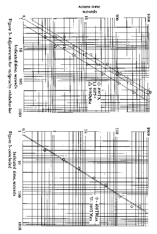

gainer said:
That last attempt didn't go so well.
I found out so far that when it comes to attachments, 600X800 is not the same as 800X600, that things sometimes go into limbo and that I don't know how to get them out.
gainer
gainer
Sep 20, 2002
3,699
OK, there it is, rotated 90 degrees so it would meet the 800X600 (or is it 600X800) pixel requirement. Raw data on top of fitted lines.

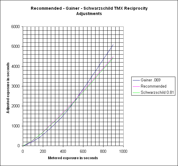

Well, here's a graphical answer to your question, on linear rather than log axes if you're more comfortable reading them as curves. This graph is a comparison of Will S.'s "data" listed as Recommended, Gainer's calculations from the Bond data with the derived TMX factor of .069, and the traditional Schwarzschild formula using Robert Reeves' test results for a Schwarzschild exponent of 0.81 .
If you read this simply, you might get the _mistaken_ idea that this somehow discredits Gainer's and Bond's work, but that is certainly not my intention, nor necessarily the case. The closer fit between the Schwarzschild calculations and the "data" you have in hand is most likely a reflection of the fact that the numbers you have were generated using the Schwarzschild formula to generate numbers that are a close fit to some unknown number of test observations. I've never seen any description of the exact method used by the manufacturers to determine reciprocity adjustments. Maybe someone on this list knows. I'd be interested in hearing about it. Since Mr. Bond is a meticulous worker and Mr. Gainer's calculations are such an excellent fit to this published data, I see no reason to consider their work as anything less than accurate.
In any case, within the range of exposures tested and recommended, there is no more than about a 1/3 stop discrepancy between the two methods of calculating an adjusted exposure time. That's not a very significant practical difference given the vagaries of meters, shutters, etc.
