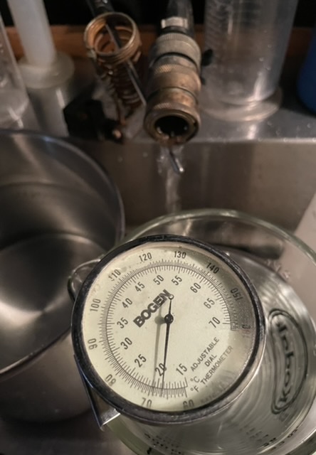

1. Temperature difference between the tank and the water bath.
2. Second half of a quart bottle.
I use a compensating timer and noted the water bath the day I got low contrast, was 72-degrees F (could have been 74). I didn’t note the ambient temperature (could have been 65.
I may not have given enough time for the D-76 1:1 to come up to temp.

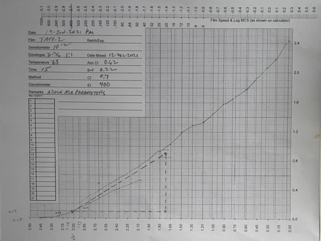

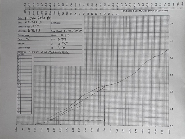

I hit the ASA parameters for Double-X 5222 at 15 minutes in D-76 1:1 this afternoon. Speed is 250.
The same run I hit higher than ASA for TMY 2. Speed is 400. It may actually be the ASA parameters, the test exposures were on the edge so the sprockets gave the patches slightly higher densities for some readings.
So just 15 minutes vs my usual 13:30.

Last night I hit ASA parameters for Double-X and curve says I overshot ASA slightly for TMY-2 at 15:00 nominal (13:37 real time because the developer was 69.8-degrees F). Sensitometry exposures were near the sprockets which can explain the odd curve shape (long story but I put an ND 0.6 filter over half the low exposure region which put some test patches near the sprockets where they were “more” developed).

Tonight I found the dial thermometer off by 2 degrees F. I wasn’t timing by it so that’s not critical. The probe and my Paterson glass thermometer agree well
Water running at 68.00 degrees tonight, 15 minutes real and compensating times agreed.

I will double check my times again in fresh and see if I am back to 13:30 for ASA parameters for TMY-2
