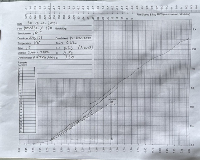

My run of 120 Double-X in this mixed 13-DEC-2020 D-76 1:1 15 minutes 68-Degrees F (real temperature 68.00 allowed to reach bath temperature) went overboard.
I have an EI 320 and CI 0.8
This is nuts. I don’t know what’s going on. The more careful I get the more this batch of D-76 looks like it’s as active as ever.
