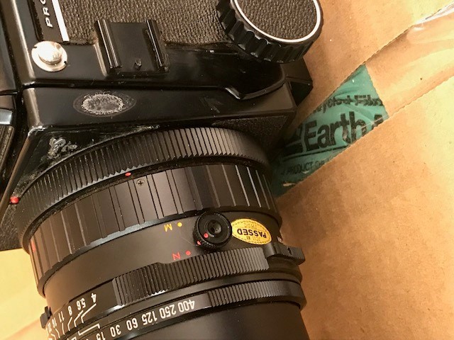

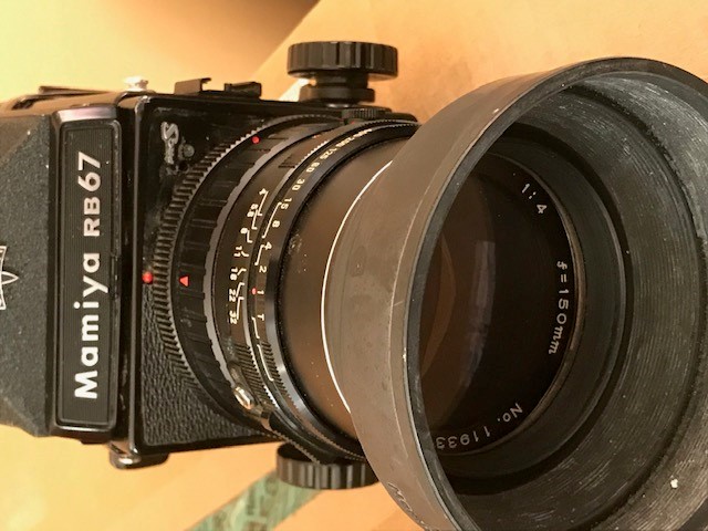

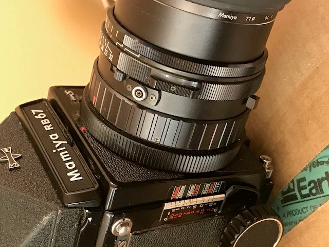

uh oh. Lens won't come off. Shutter cocks and fires just fine, so according to the instructions the lens should come off. Shutter and camera are both cocked.

Congratulations on the camera. Can you post a photo of the lens locking ring, and several other photos of the camera, from different angles? What exactly do you mean, that the lens "won't come off"? Does the locking ring turn?

Locking ring will not turn.

Interlocks prevent the ring from completing the final one third of its travel unless the shutter is cocked however my ProS ring turns the first two thirds of its travel in all conditions of the wind/cock mechanism. The ring may be seized. Perhaps some warmth and gentle pressure might ease the ring?
(the ring turns so the red mark approaches the red dot on the body)

I have a 65mm lens where the ring gets quite tight. I just twist a little bit harder than with my other lenses, and it releases.

For clarity, the ring that you turn is the relatively narrow one closest to the body.

SUCCESS! The shutter lock was not completely locking. A few back and Forths loosened it up and it fully locked. Then I started moving the lens mount ring a little at a time back and forth. It loosened up as well.
