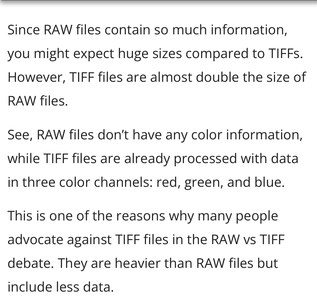

If RAW is an uncompressed file, why is TIFF so much larger…?
How can a RAW file not have any color info…?

Raw files have metadata that describe the color information attached to each pixel while TIFF files have that data baked into the pixel information in all channels.
Wow, now that makes sense…!

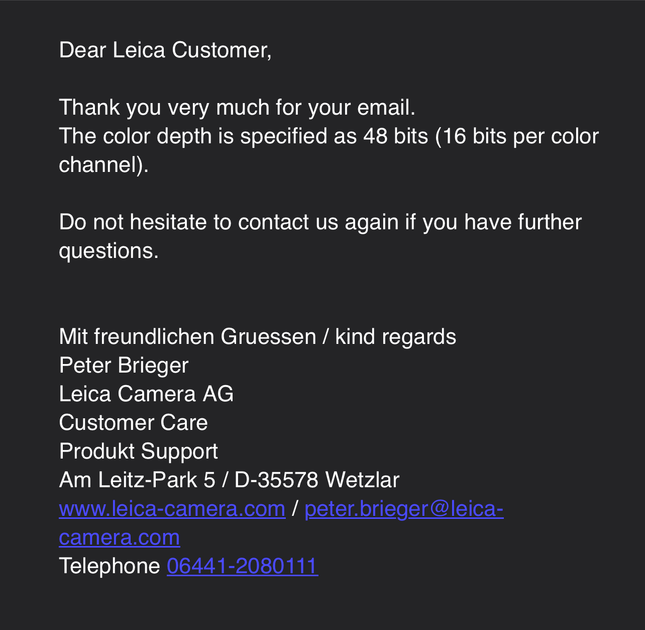

"Raw" is uncooked. "Tuff" is overcooked. It's also a typo.
A 16-bit RAW file stores each sensel with about 15 bits of actual color intensity for a single color...a sensel is sensitive to Red or Green or Blue.
A 16-bit TIFF file has had RAW sensels converted to R-G-B pixel value, and each color has 15 bits (or 16)...three times as much information for one pixel.
Very well done 😲👍…!

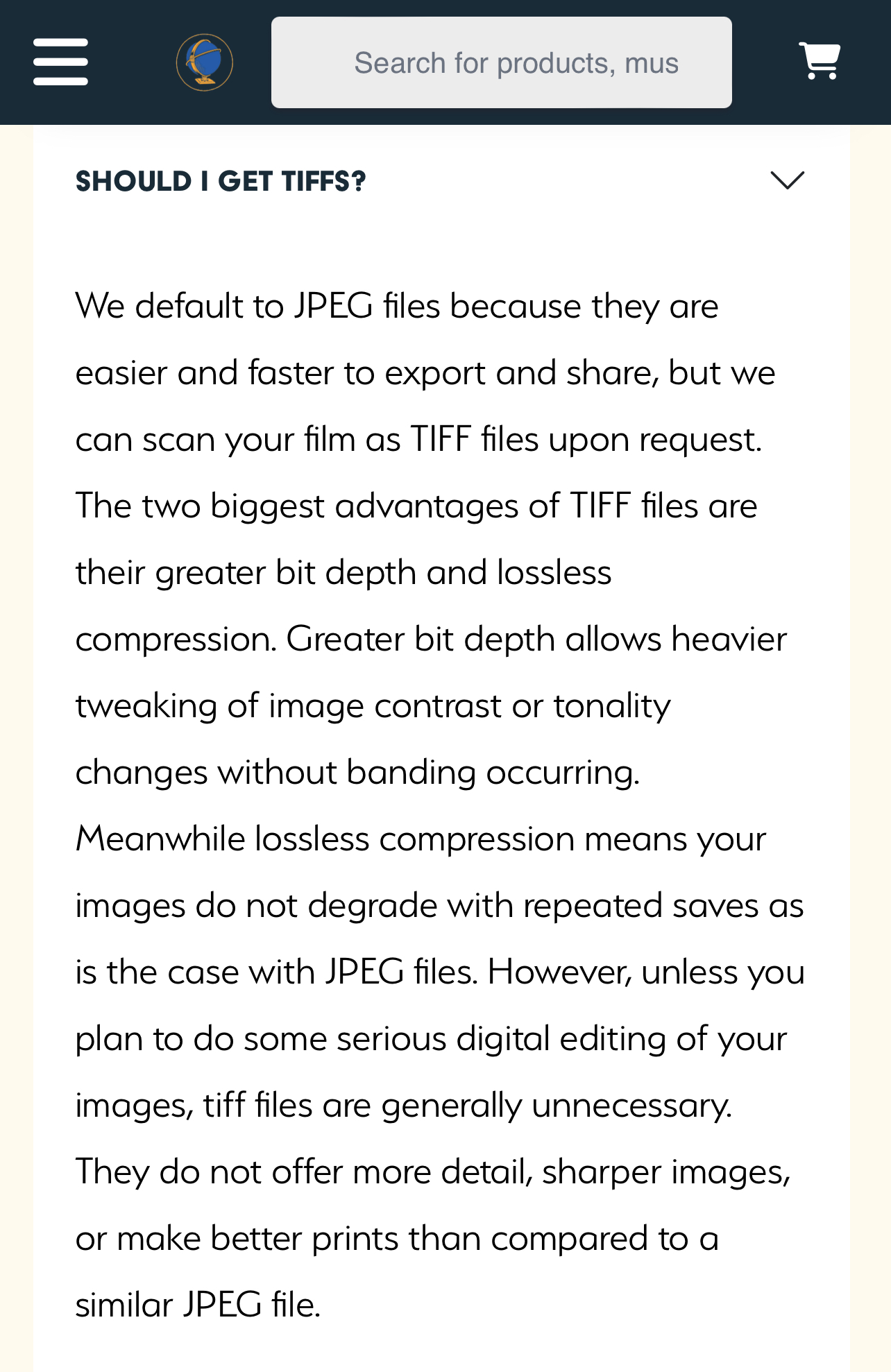

From Blue Moon Camera…!

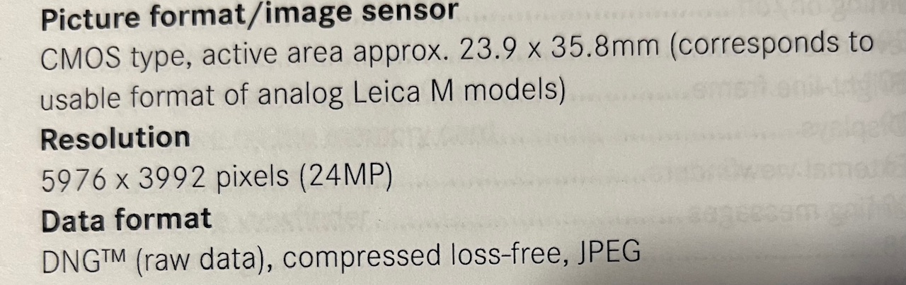

Owners manual states the MD 262 shoots RAW only…!

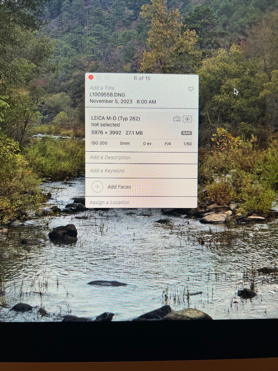

When I look at the computer screen at the image and use the information tab, it shows the wording RAW…!

I didn't state otherwise. According to documentation I can find online, the MD626 records in lossless compressed RAW format.
Again, I warn against conflating different things. RAW and compression and lossiness are three different things.
Your camera records in RAW format. At the same time, it's compressed, but without loss in image quality. This is part of the explanation why your RAW files are smaller than uncompressed TIFFs.
The camera only captures one color chanel per pixel site. So it's either R, G or B but not all three and thus the raw file also contain one color channel per pixel. When converted to TIFF using a demosaic algorithm the software either in camera or on a computer assigned 3 color channel per pixel.

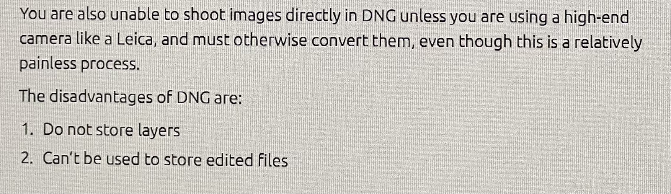

Does the Leica shoot in a RAW format then converts the image to loss-free JPEG…?
RAW implies raw sensor data (for all intents and purposes). When saving to JPEG, your camera will compress and format the data according to that standard. When saving as RAW, it'll do the same, but for the proprietary Leica DNG standard for files containing raw image data. I suspect the compression is the both in same cases, which helps simplify the camera firmware since the image processing chain can be virtually the same for both file types.
