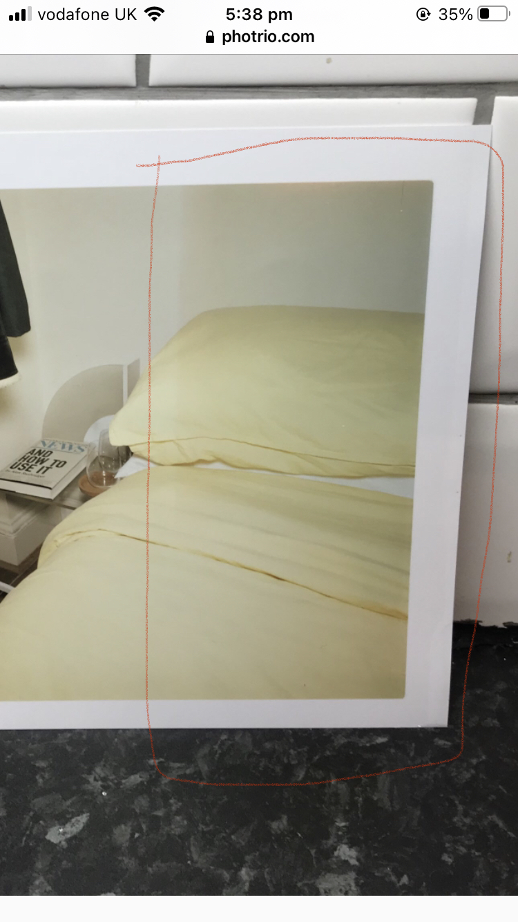

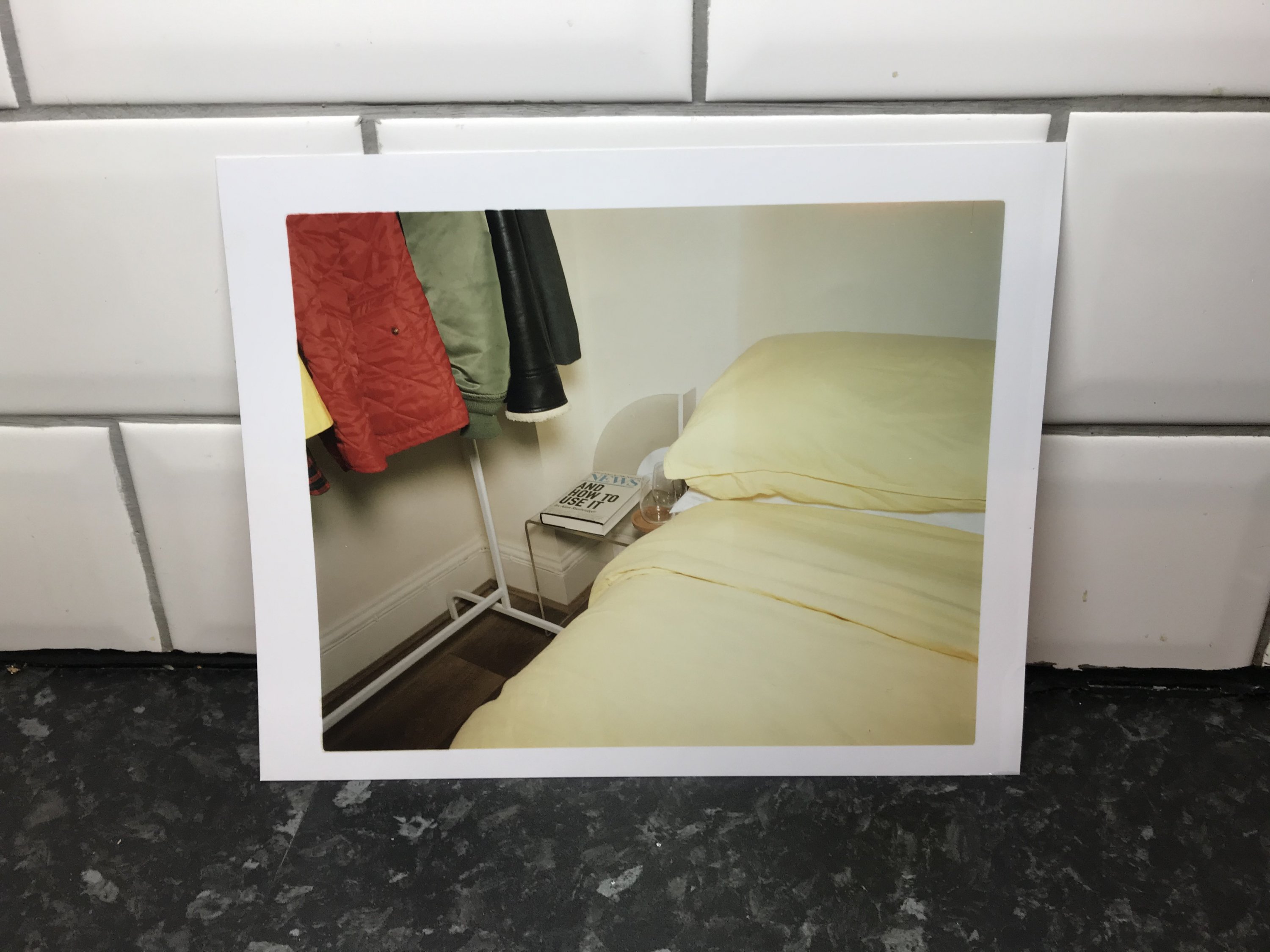

Hi all - am back again and wish I had better news... Despite two weeks of decent, problem-free RA-4 prints from my Nova Quad/LPL C7700 colour darkroom set-up I am now having issues with mysterious yellow staining on the print margins. It seems to manifest in the same place on every print as a sort of 'ghost image' of yellow/darkened exposure.
I recently lost a print in the dev tank due to my old Nova clips losing their 'spring', where it remained stuck overnight until I was able to finally fish it out the next morning with the right tool. Could this have stained the tank?
I drained the dev tank itself and cleaned with a Steradent tablet and flushings of hot water but the problem persists, despite replenished chem. I'm still using an Adox 2-part kit so haven't had new chemistry to mix up and try.
Does this look like dev carry-over into blix? The Nova can be a messy beast so I've got some stop I can add in the 2nd both of the Quad but haven't needed to yet. I've tried other Kodak paper stock and it manifests there too. Strangely, it's appeared a piece of my Fuji paper came out perfectly clean white...
Hopefully, this is just a chemistry issue but any advice would be much appreciated. Maybe there's something simple I'm missing here.

If it's the darker band on the right hand side of the print,, then I'd say it looks like it should either be on the film, or it's a part of the paper that has somehow received a little exposure - enough to act as a preflash, but not enough to create densities in the whites.
I had just assumed that this line which isn't so distinctive on the bed cover as on the edge of the pillow was a difference in the amount of natural light hitting that area. The skirting board on the bottom of the corner wall seems darker than the skirting board under the clothes but I had assumed this was again because of the shading in the room. The book's cover does not seemed to have lightened either.
What is the curved brownish curve in the corner in the same area as the lighter part to which I think you are referring?
I found this a confusing picture as I cannot work out if what I am seeing is a result of normal shadows or something in the print's paper
Can you help clear up what I think I see but in fact may not be there

Hi all,
Appreciate those replies! Apologies if it wasn’t super clear - I’ve highlighted the area, I know the print is a tad underexposed but I left density there in order for the artefact to render visible and will re-share another image where this darkening is more pronounced. Koraks is right - it does resemble a pre-flash but this is new paper and an unexposed sheet exposed perfectly white as I mentioned.
It’s rather uniform too? Does that discount the possibility of light leaks in the darkroom either daylight or an appliance pilot light?

It almost looks like the paper spent some time half in and half out of an envelope or paper safe.

The new one you posted is puzzling because of the distinct line bottom right where the issue stops. You have a broad white border with some of it being affected and the very outside not affected. That seems like a key to tracking down where this is happening.
Are you using an easel that creates a narrow border, but then the edge of the negative carrier is what is creating the actual edge of the print image area? If so, you know your paper is being fogged while it sits in the easel.
Yep, I am using a 11x14" 2 blade Kaiser easel that's not in the best shape so am currently relying on the neg carrier to create a soft-ish border as the one's blades are no longer true and resulting in uneven print borders. Could stray light be periodically hitting the paper whilst in the easel and causing this to occur? I'll check the area directly around the enlarger but possible reflections or anything else that could be causing this to occur.

Does the first one you posted show that same edge? It's hard to tell. There are still a lot of possibilities, but knowing it is happening while paper sits in easel helps you a lot. Light leaking from enlarger? Light from a timer? Light from your Fitbit? etc.

The paper's been kept inside its original Fuji light-tight 8x10 box and as I mentioned initially, it happens irrespective of which brand of paper stock, and they're all stored firmly within double-black boxes.
If it could only occurring somewhere around the enlarger/easel area and isn't to do with storage then perhaps it's a light-leak or fog from another light source somewhere.
Weirdly I've printed with the safelight a lot and never had any issues - also, would the resulting fog from a sodium lamp not be registering cyan/greenish in colour due to RA-4's reversal?
Yes, based on your information, this is indeed the place to look at first. Especially the print with the woman and the blue jar suggests it might be something that happens when the paper is already on the easel - assuming that the square fog boundaries in the lower right corner match the setting of the easel's blades at some stage in the handling process.
Yes, you'd expect that - blueish, in any case. In the image with the woman, there's an area of fog in the bottom center that seems to be in the right color range for what you'd expect with sodium vapor light, although most of the fogging seems warmer. However, it's always slightly unpredictable how fog turns out because it's usually not filtered through typical Y/M filters and the colored base of C41 film. Hence, it sometimes comes out slightly differently from what you'd expect. However, it's unlikely to end up at the opposite end of the color wheel, so that would suggest your sodium lamp is not the most likely culprit and other stray light sources could be present. Beware in particular of status leds on equipment in the same room - something like a blue led on a computer etc. can wreak absolute havoc on color prints.
