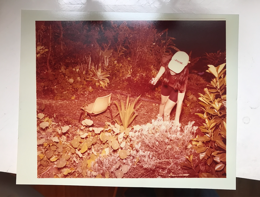

Yep, can imagine your frustration that Roger 2000 disappeared. You all had some very thorough analysis by the looks of it. PE's advice is of course, second to none as always!
As for my own sorry saga - alas, I have indeed tried many of the same remedies you had recommended to the absentee OP to no avail. Am at the end of my tethered as I have printed vast quantities of RA4 in the past - primarily through tabletop RT processors such as converted the Durst RCP20/40 range.
To break it down simply, here in the UK I am printing Portra 400 (color) 6x7 negs at home through an LPL C7700 Dichroic enlarger and processing (aged) 8x10" Kodak Endura cut paper sheets via a Nova Quadmate Heated 4 tank 12x16" Processor, using the lowest minimum settings on my Duka 50 safelight (bounced) as I find these Nova Deep Tanks to be slippery bastards in total darkness.
The resulting prints themselves are incredibly red (and often magenta in nature) despite base filtration and are bizarrely immune to filtration - even at maximum settings of 170, 230 Magenta, and Yellow respectively.
A single sheet of unexposed Kodak paper came out without any visible color fogging, just creamy base whites due to age, however, and after thoroughly inspecting my enlargers mixing box and dichroic filters today they seem to be moving fine. The RA4 chemistry was also run 1:4 (400ml Adox -1600ml water) in both 2L capacity tanks of the Nova as per Adox's instructions.
Chemistry has been replaced (fresh Adox RA4 kit) and the paper supplier has shipped me another box of aged (but hopefully useable for test purposes) Kodak Endura cut sheet paper. Could this be caused by the safelight bouncing off the purple-colored bathroom walls? An invisible light leak perhaps? I have masked/taped up all other stray light sources, tried various perfectly exposed negatives.
Can an old enlarger lamp or my steel enclosure Schneider-Kreuznach f/4.5 105mm lens be causing extra cyan/green light on these prints somehow? I've got a new 100W/12V bulb on the way.
I am afraid I am at a loss at this point... Any/all advice much appreciated.
Sounds like the filters aren't in the light path. It's a common user error with Durst enlargers where the lever that holds the filters out of the way is left in that position. I'm not familiar with your enlarger, but have you verified this? Of course if you see a visible change in the color of the light on the base board when making big filter changes (>20cc or so), this shouldn't be the problem.

Thanks all for all those prompt and detailed responses to this with a view to helping me nail down the issue. Good to know the lens probably isn't a factor in this. To answer a few of your questions, firstly, I was mainly referring to my experience and general familiarity with RA4 processes - I have had several different colour darkroom setups but this issue is specific to my most recent one. I have checked the mixing box and filter 'array' (?) multiple times but they seem to be well within striking distance to the light path and I can sight visible changes to output light of 20cc + across respective colour channels on the baseboard so can probably rule this out. Image attached so you can gauge the severity of the issue. Excuse the lousy easel work and reversed 120 neg - hurried and frustrated hands.
I will toggle the White light lever again on the side with my enlarger top plate off to see if the mechanism is doing its job, as far as I can tell there's nothing obviously wrong with the LPL. They're middle of the road enlargers compared to say an Omega or De Vere but competent nonetheless. Have successfully run a lot of RA4 through the C7700s in previous darkrooms without issue save for a Newton Ring here or there prior to investing in the AN glass.
I am hoping that moving from bathroom to kitchen (far more space = less stress for me logistically, and neutral wall colour) could be of some nebulous advantage in the long run but we will see.
Failing that, I can only assume that the age and base fog on the Kodak Endura is causing this filtration mayhem. Is it possible for 8-10 year old paper stock to just 'brick wall' and cease responding to filtration entirely though? I've never seen that before and have printed on quite a bit of slightly older Kodak stuff as I prefer its thickness, D-Max etc.
Me neither, although I've only printed on horribly old and fogged Fuji paper, apart from fresh rolls. It still responded quite adequately to filtering though. However, the old paper is a liability for sure. I'd wait for the fresh stuff to arrive to at least remove that factor from the equation.
