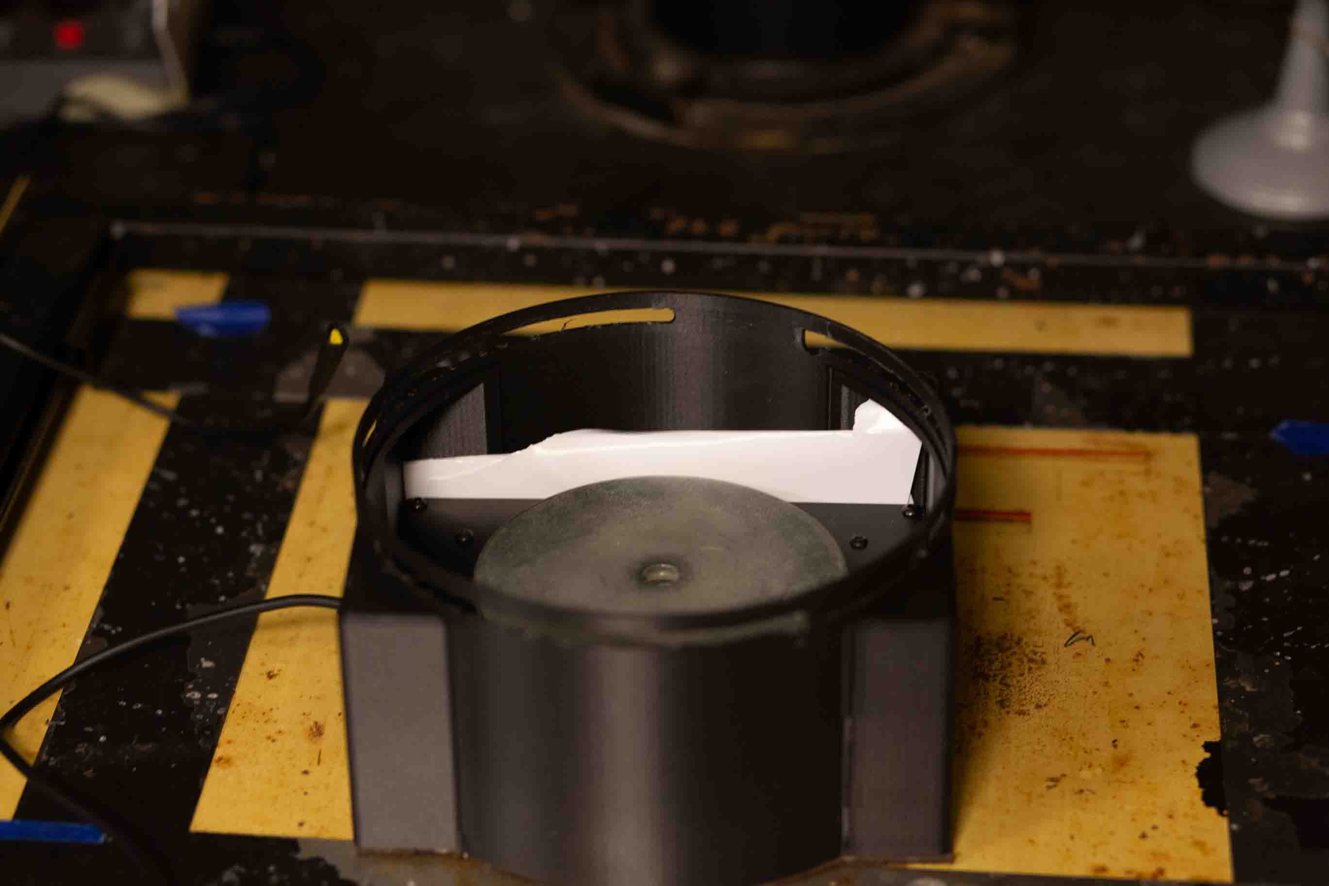

Necroposting my own post here, but I've decided to go with a design that replaces the lower condenser carrier with a 3d printed part, therefor it would skip the use of optics that are problematic in some of the units (they're chipped or cracked in a few, and the dichros don't even have those optics, dichros need more work anyways.) I'm pretty sure this is ok, since this is how it's arranged on the actual intrepid enlarger, but having the light panel 1cm away from the film is perfectly acceptable correct?
I have a prototype part, I'll post a photo once I get stuff fully set up.

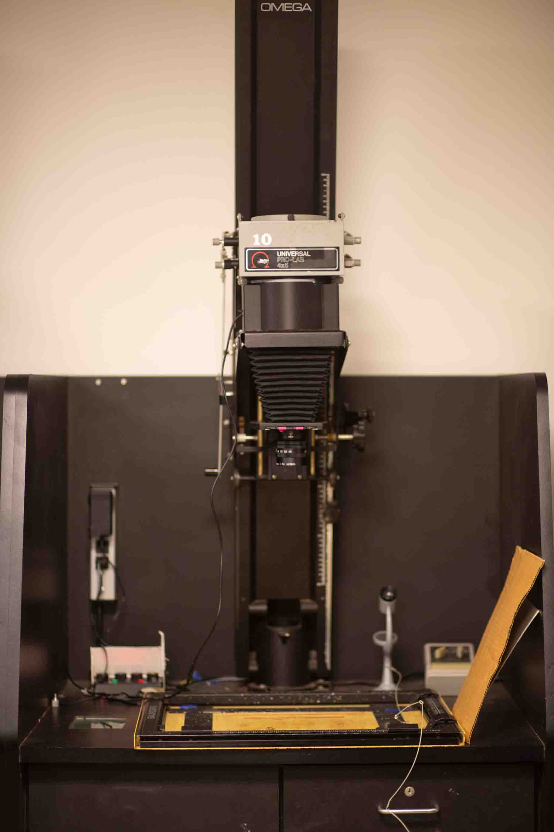

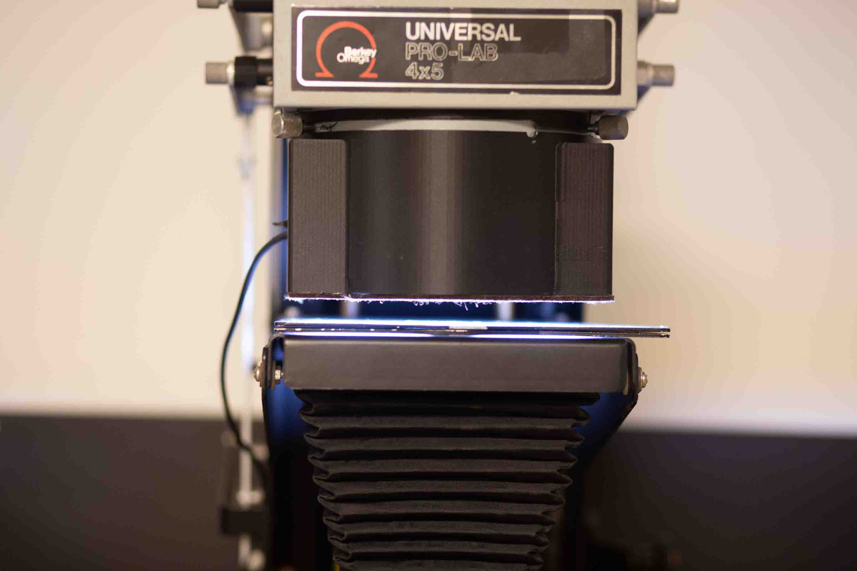

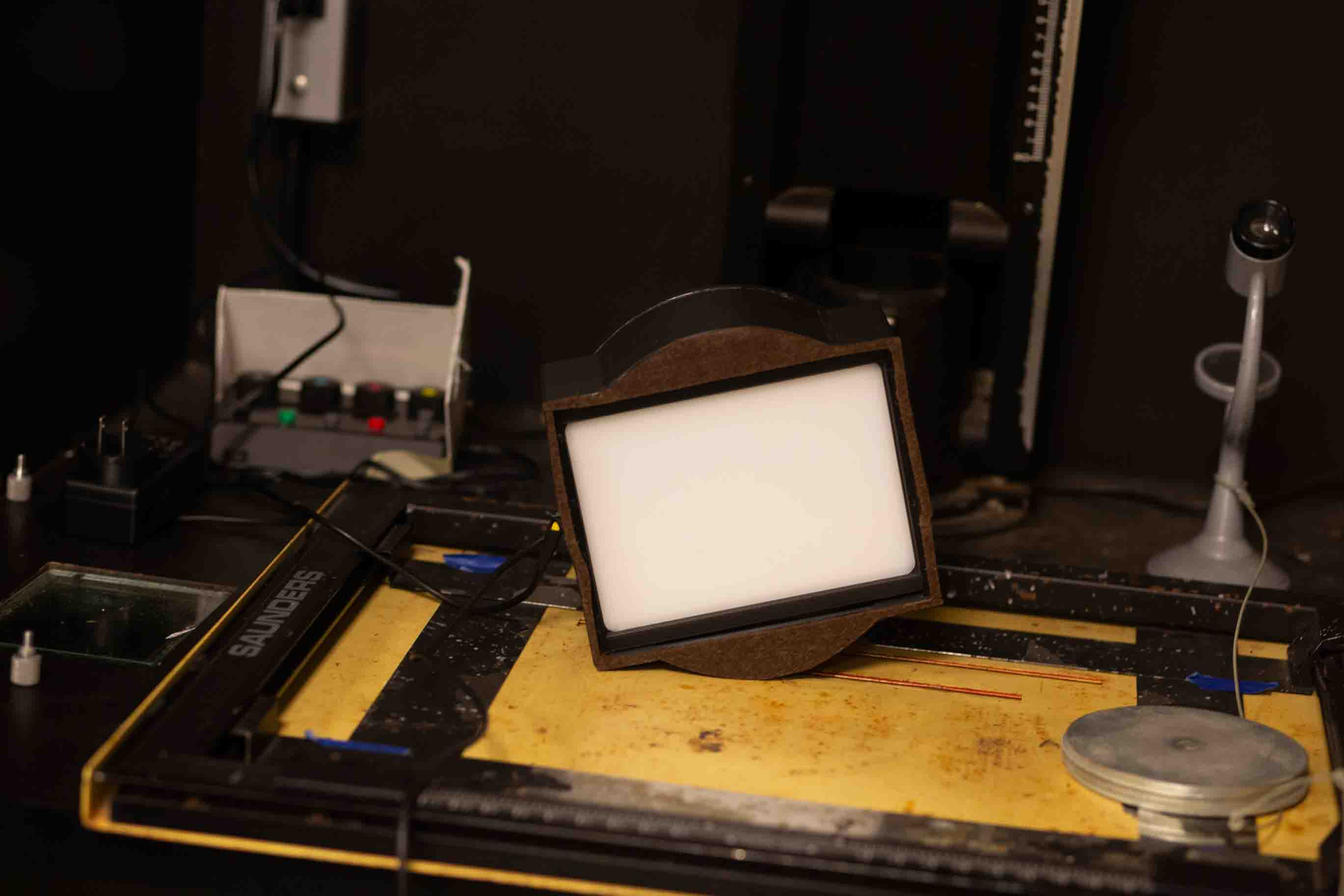

Hi, just though I would drop an update in here for anyone who's interested, I managed to create an adapter with a 3D printer. To his end, i've managed to allow the system to function with all the existing omega equiptment, such as the film holders. I ended up having to add some weights to the system to balence the omega's stand. overall, i've made some prints with it, and have to say that I do really like it. Since this is a b&w only system, I may investigate if I can reprogram the timer's color dials to act as .1s, 1s, and 10s. Other than that, i think the intrepid system makes a great b&w head.
I can provide my 3d stl files on request.
edit: yes all these images have shit focus, the lighting in the darkroom is fairly poor. it's been a long day. I'm not setting up a tripod.
