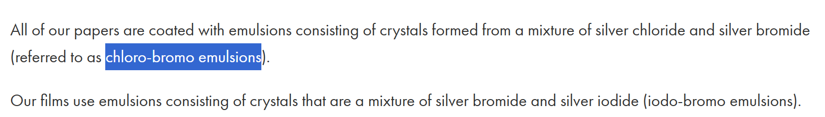

Some contact printing papers used silver chloride, but I don't know of any of those still being manufactured.
Copper Sulphate bleach paper doesn't work well with Chloro-Bromide papers as well. It removes some unexposed halides resulting in poor DMax after the second development. Those who shoot photographic paper in camera and want to reversal process it must avoid using Copper Sulphate bleach. Dichromate and Permanganate bleach work best for this application though some of have had success with Peroxide-Citric Acid bleach.
Out of curiosity, any idea why papers use AgCl + AgBr but film uses AgBr + AgI ?
Speed?
Native spectral sensitivity?
Speed?
I tried to look into this but I'm out of my depth. I did learn a couple of things though:
(1) These lecture notes from a college in India say:
Silver bromide (AgBr) is the most widely used of the silver salts for paper and film products...
Silver iodide (AgI) ... [its speed] is approximately one-third that of silver bromide
Silver chloride (AgCl) ... Its speed is approximately one-eighth that of silver bromide.
(2) This paper goes into the details of the photochemistry of AgCl, AgBr, AgI. This paper is way over my head, but perhaps others can glean something of value from it.
Having said that, the paper did say one thing that I understood:
... Accordingly, the ionic relaxation time in AgCl grains was two or three orders of magnitude longer than that in AgBr grains. This result indicates that, on exposure of AgCl grains for a short time, trapped electrons are inclined, not to react with interstitial silver ions, but to recombine with positive holes, and that photographic performance on exposure for a short time is therefore deteriorated more intensely in an AgCl emulsion than in an AgBr emulsion.
Ok. So the latent image from AgCl will vanish sooner. That makes it unsuitable for film. While AgI is the opposite.
