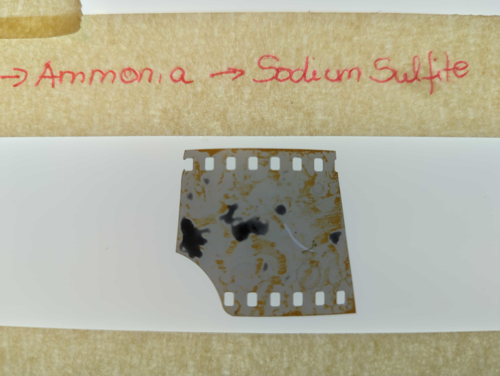

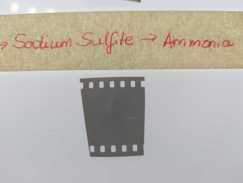

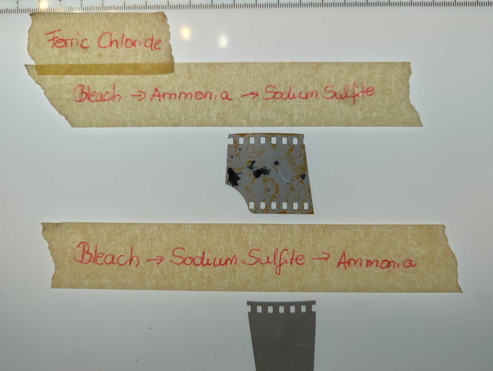

I did the same bleach test as @MCB18 --- Fully exposed the film, develop, stop, bleach steps, and clearing bath. --- I have the ingredient to make all three bleaches, so I decided to use ferric chloride to match @MCB18. Because I was curious about the role of sodium sulfite, I did two tests:
Test 1: Bleach ---> Ammonia ---> Sulfite sequence (i.e. reverse sequence).
Test 2: Bleach ---> Sulfite ---> Ammonia sequence (i.e. "default" sequence).
Note that the video describing the variant with ferric chloride uses the reverse sequence, but it also uses sodium metabisulfite, and that might be an important difference. Without further ado, here are the results:
As you can see, the reverse sequence left a significant amount of stain, which was avoided with the "default" sequence. The intended purpose of the sulfite bath is to prevent staining. It appears that it is indeed an important step for the ferric chloride bleach.
I also noticed that the solid precipitates looked very different. When ammonia came first, the film formed some fairly large "flakes" of red material. I don't know what that is. Silver chloride should not be red. But when the sodium sulfite bath came first, the red material was a fine powder that drifted off into the liquid easily.
Here are close-ups of the results with the reverse sequence:
And here are close-ups of the results with the default sequence --- don't mind the mark on the film; I was just too aggressive with the tongs and scratched the film.

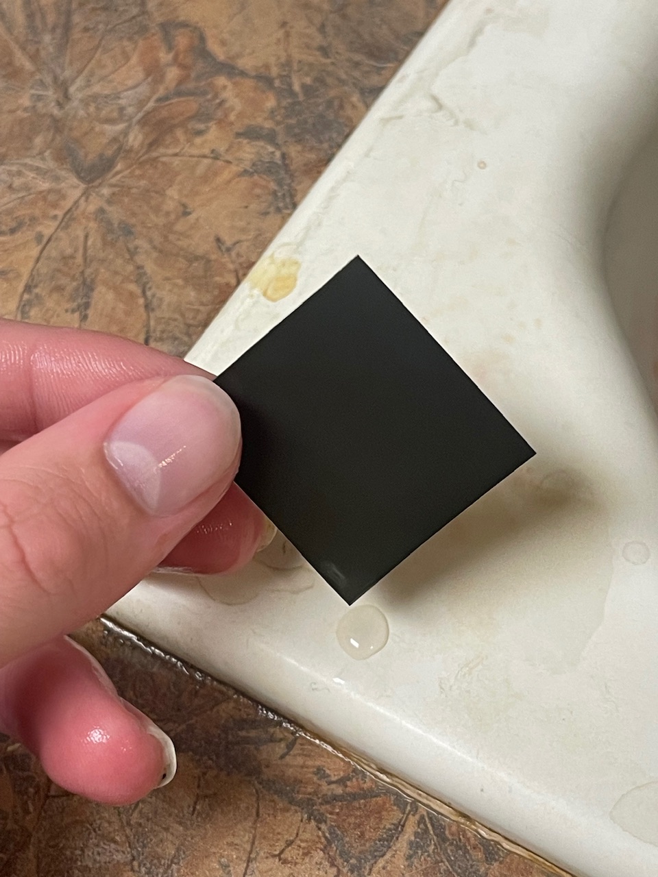

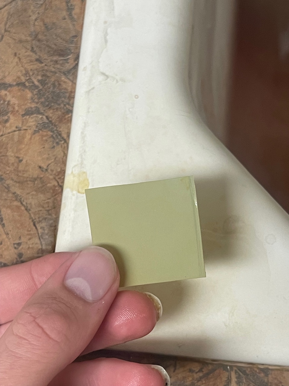

After the 2 bleach steps and clearing bath, the film was still opaque and yellow, and when put in developer again it turns almost completely black.
This indicates the rehalogenation is working, but dissolving the silver chloride isn't. Either your ammonia bath isn't doing the job (warmer, longer time in bath, or stronger ammonia would be the things to try) or the silver is being converted to a different halide -- bromide or iodide instead of chloride.
This indicates the rehalogenation is working, but dissolving the silver chloride isn't. You're using copper sulfate bleach?

I took a picture of it today after another test:
And after second development:
Right. The ammonia isn't dissolving the rehalogenated (and exposed) silver. See my edit above -- warmer, longer bath time, or stronger ammonia are the things to try. Make sure you have only pure sodium chloride as the halide donor in the bleach bath, no bromide or iodide (I don't know how much trouble the tiny amount of iodide in table salt would cause, but use kosher or non-iodized if that's your source of additional chloride. You might also check that fixer will dissolve the yellow halide, just to be sure it isn't some other silver compound that's developable, but not soluble in ammonium hydroxide.

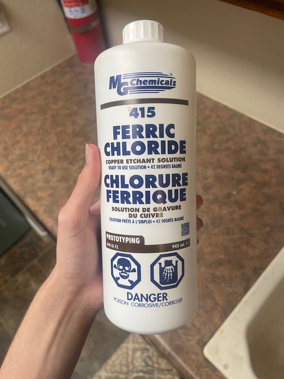

Is this circuit board etching solution, or lab grade ferric chloride? Etching solution might have stuff in it to make it work better on copper...
It’s this stuff.

Looking at the pictures you posted, that's definitely a lot more than just a stain. Based on my experience, it's best to do the clearning bath first, but I am sure that that's not what's going wrong with your setup.
It really looks like the developer developed the film again. Like @Donald Qualls said, the ammonia is not dissolving the AgCl for some reason.

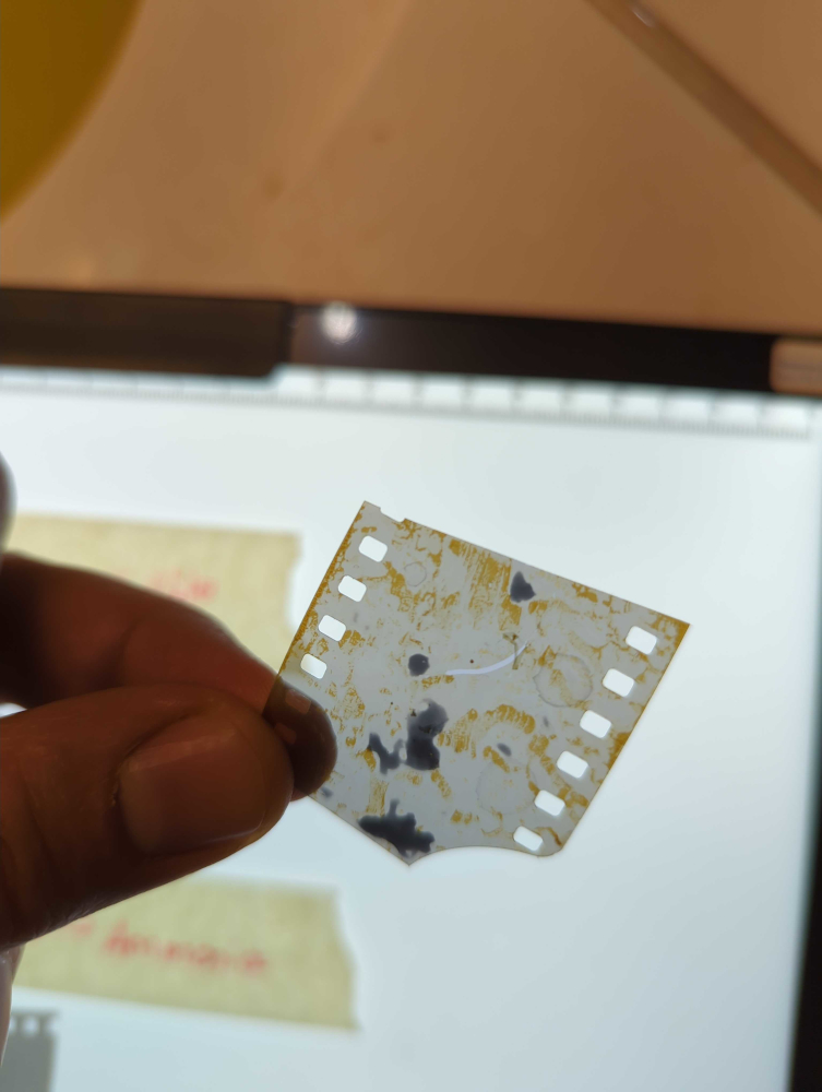

Q: What did the film look like after the ammonia bath? It should be clear. Like... absolutely clear. Just the film base. When I held my film to the light it was obvious that the 2nd developer wasn't going to do anything and I just put it int he developer to confirm.

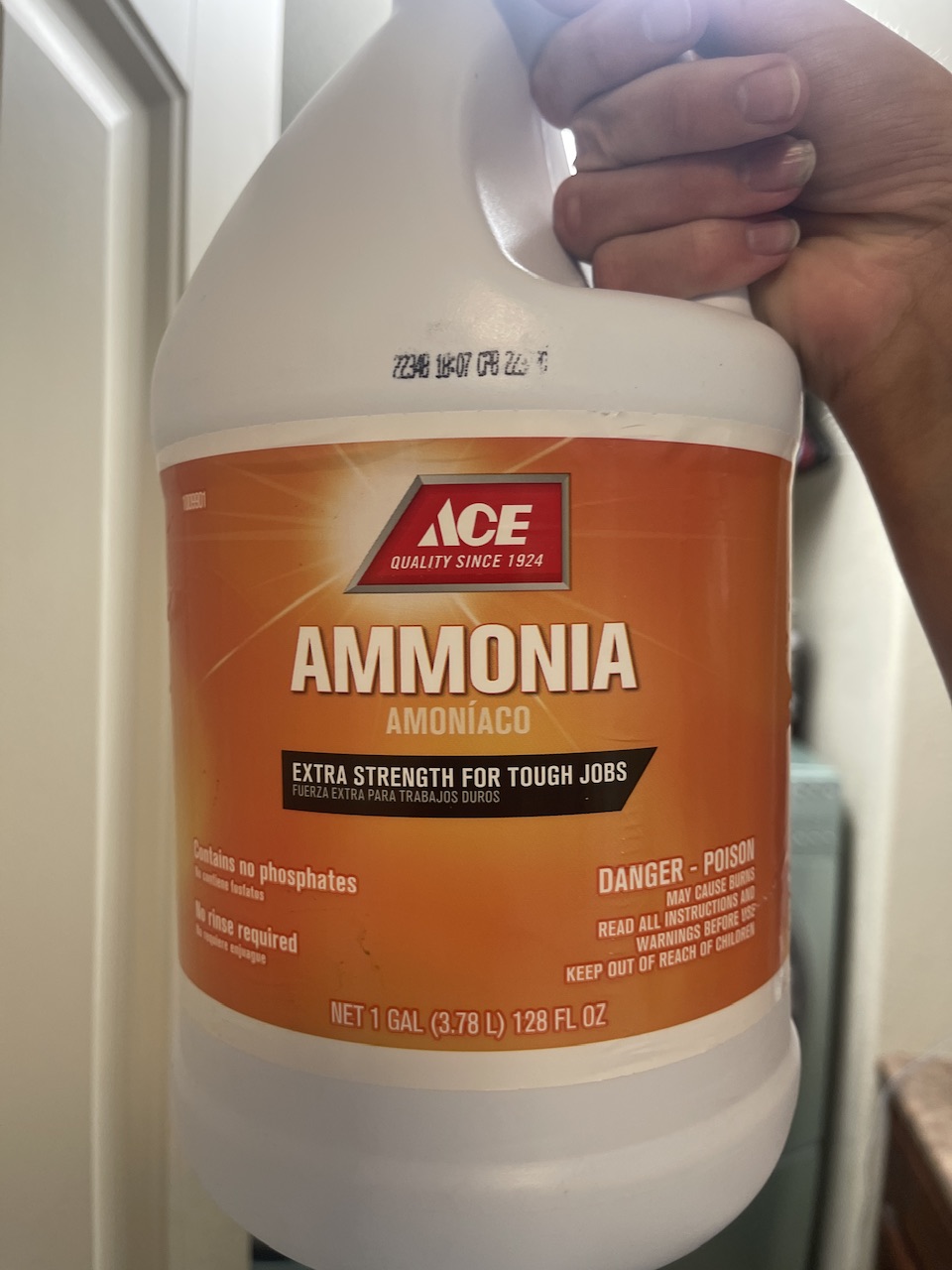

Q: What are you using for the ammonia bath? I used the regular ammonia cleaner from Walmart. The house brand. No dilution at all.

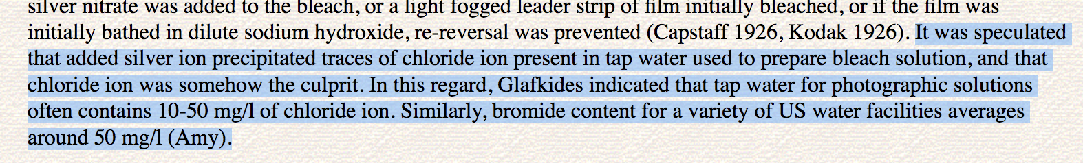

Are you guys using tap or distilled or deionized water for the bleach and clear baths? Tap water has chloride ions that affects the bleaching ability: https://unblinkingeye.com/Articles/PBR/pbr.html
Also just re-reading it again, ferric chloride... so you probably have free chloride ions that's causing all these issues. Where did you guys read that this is a useful bleach for black and white reversal?
Good thinking. I used distilled water for both.
@MCB18 Are you using tap water?
The first post of this thread links to the sources for every recipe. In the case of ferric chloride for B&W film reversal, that came from this video. The video demonstrates successes, and as I posted earlier, I had no trouble getting a clear film from the bleach.
This is the point. It’s a regal bleach meant to turn Ag into AGgCl. Putting clouded ions in solution is the entire point.
This is after both bleach steps and the clearing bath.
I just used the 1 gallon container of ammonia you can get from Ace Hardware.

I mean, the photo I shared previously was after the bleach and clear baths.
Oh. Alright.
Well, the first photo (after the bleach + baths) clearly isn't transparent. I don't understand what's going on, but it looks like the baths didn't even touch the film. When I did this, the effect of the clearing baths was unmistakable. You could immediately see the film spitting out red dust and becoming clear.
