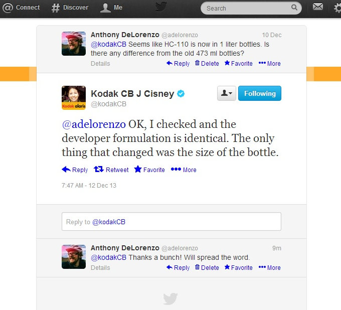

Well here it is straight from Kodak: There is no difference between the formula in the new and old bottles.

They can say, whatever they want, it doen't work the same way as before. I have very precisely calibrated system with HC110 used for 3 years now. New HC110 is weaker. My third attempt is a success, sort of, but I had to increase quantity from 6ml to 7.5ml. Negative looks like developed in Tmax dev. Still have to check it under the enlarger for grain, sharpness and local contrast. It still might be a very useful developer. Tests with oxidation shows better resistance to it, than the old one. Used dev. left in the glass (small quantity) after two days shows light change of color to brown. Glass with more of the solution (10x more) no change so far. Original HC110 was dark brown after 24 hours.
