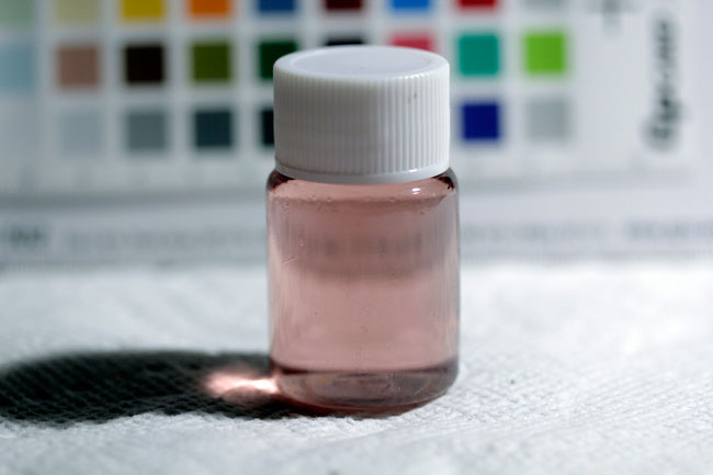

While this thread died almost 4 years ago, I was another guy who decided to learn to appreciate Rodinal and stumbled on the formula from Digital Truth. Before you start asking why I have not bought one, none of the half-liter bottles of commercial concentrates in the neighborhood shops inspired confidence in me, and they just refuse to package it in baby bottles. So, I decided to make one myself. As I made a small scale prep, my mistake was obvious, since I first got clear and colorless solution, while it was at 50 C or so, but overnight a truckload of clear needle-like crystals formed on the bottom of the bottle. Since the idea of the true Rodinal is quite clear (production of p-aminophenol phenolate in saturating amount of sulfite), I checked the ratios of the DT formula components and clearly quite some NaOH was missing. When I added it, the crystals dissolved and I got a pale lavender colored solution, which developed FP4 at 1:19 dilution for 40 minutes very well. So, I am wondering how it got there in the first place, while on this forum there is the so-called Wolfen formula. which is likely the original, possibly only missing some minor components..The problem is, at the concentrations used in it, you cannot make it starting with p-aminophenol hydrochloride, and p-aminophenol is a relatively unstable compound, so I suspect that the commercial vendors use freshly prepared p-aminophenol to mix the developer. One needs the original reference how to prepare p-aminophenol base from hydrochloride, then you suspend it in commercial 45% potassium sulfite and then carefully neutralize with 50% KOH until nearly all of the pellet dissolves and there you go. Any ideas/comments?
sounds ok, mine looked like that when i made it.

IMHO, the choice between the commercial version and making it yourself from commercial components may be a false dichotomy The developer in the neighborhood shop may be several years old, and buying it you are bringing a large amount of toxic chemical into your home, if you do not like it, you would face a waste disposal problem. On the other hand, the p-aminophenol wherever you may find it (certainly not in the hardware store) could be just as bad. My point is one may need to go out of this false dichotomy and learn to make fresh PAP base on the spot. Otherwise, a great majority of other PAP developers do not need this much effort and are easily prepared from commercial hydrochloride of PAP. What I fail to understand is why a p-aminophenol developer masquerading as Rodinal is offered with an error and nobody cares.
A large amount of crud in a fresh bottle or a dark colored developer may be a sign that a poor grade of p-aminophenol was used. Years ago when I made my own rodinal I followed the recipe in the Pocket Darkroom Data Guide, Morgan and Morgan publishers. This recipe starts with the HCl salt as it is more stable than the free base and available in greater purity. The base (which is a light tan) is then precipitated and used from thereon. The final developer was a pale lavender in color.
