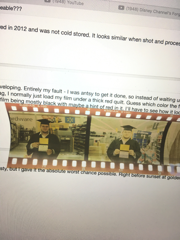

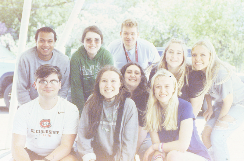

Unfortunately, I fogged the roll I was developing. Entirely my fault - I was antsy to get it done, so instead of waiting until night I loaded the film in the daylight. Because I lost my changing bag, I normally just load my film under a thick red quilt. Guess which color the film is now? The rebate is the most red, with the spaces between the film being mostly black with maybe a hint of red in it. I'll have to see how it looks when the film is dry and the scans are in.

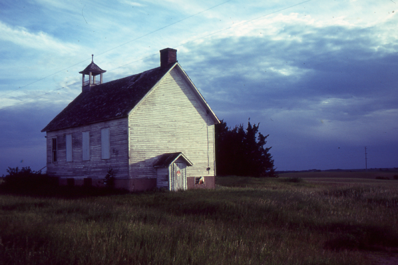

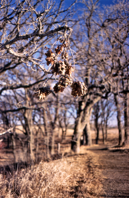

Here's another ISO 400 shot. It's contrasty, but I gave it the absolute worst chance possible. Right before sunset at golden hour, with a warm polarizing filter.

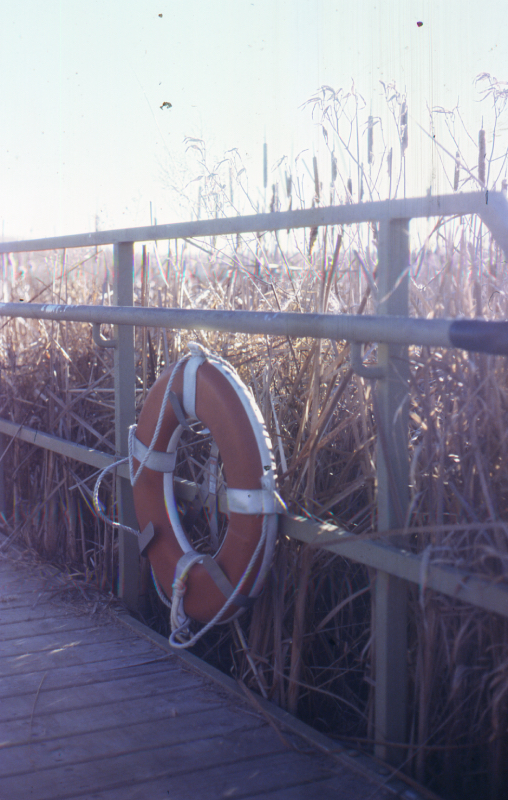

Here's a photo of the still wet film. You can see between the frames that it's mostly black. A lighter black than normal, yes. That's a consequence of pushing film though. The rebate is red because I'm an idiot who fogged his high school grad pics lol. The grain is visible. I can see it with my eyes just holding the film up to the light. I'm going to avoid posting again until I get the scans done and corrected because I am making a lot of posts/comments lol.

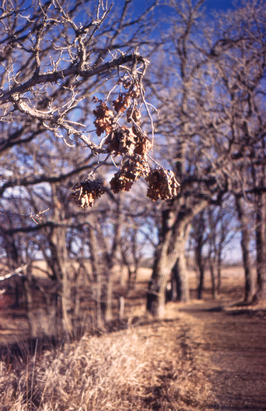

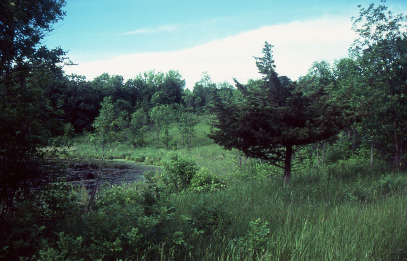

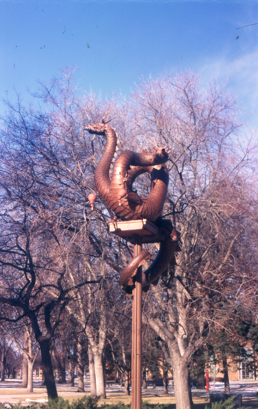

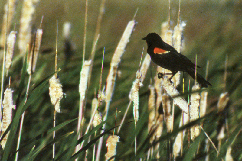

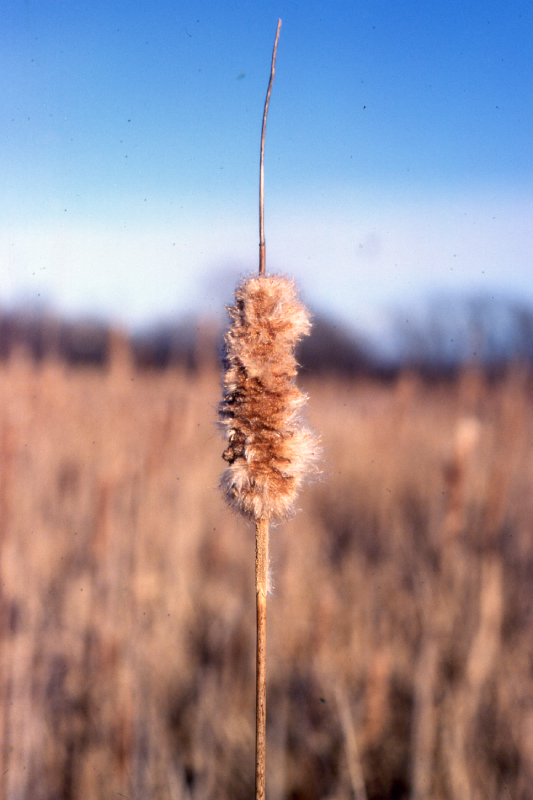

First scans are in! No major color correction was done to these, just brought down the highlights a bit because my Nikkormat only has shutter speeds in full stops, as does my lens, so I was often shooting around half a stop over. Some of these definitely have crushed shadows, and all of them suffered greatly from the fogging. The last shot with all the people in it was taken in the shade on a very bright day. I attached a version with colors corrected and highlights brought down. I will be shooting another roll tonight of wildlife at the local prairie, and I'll push that three stops too. I hate flying through my film like this, but I already do go through a roll at the prairie every day, plus it's for science.
Well, expired film etc. - what are you trying to demonstrate anyway?

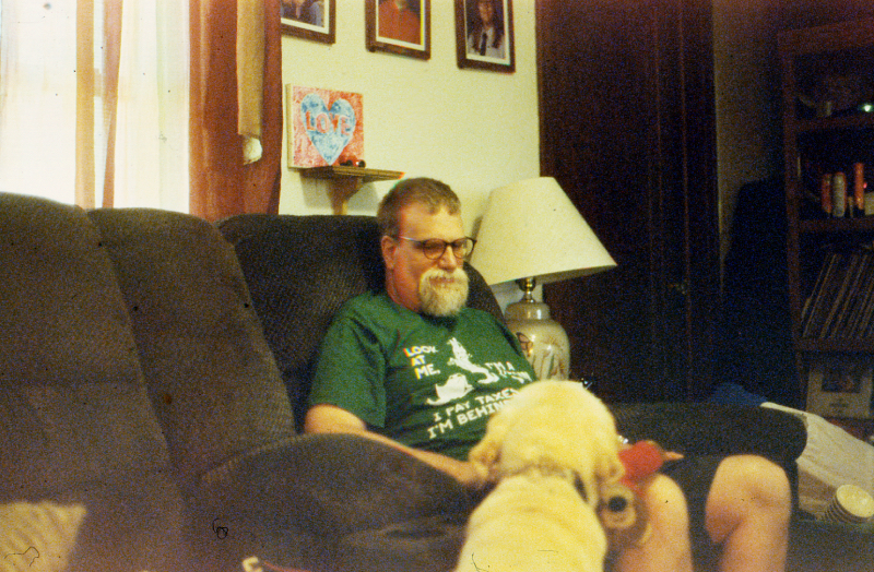

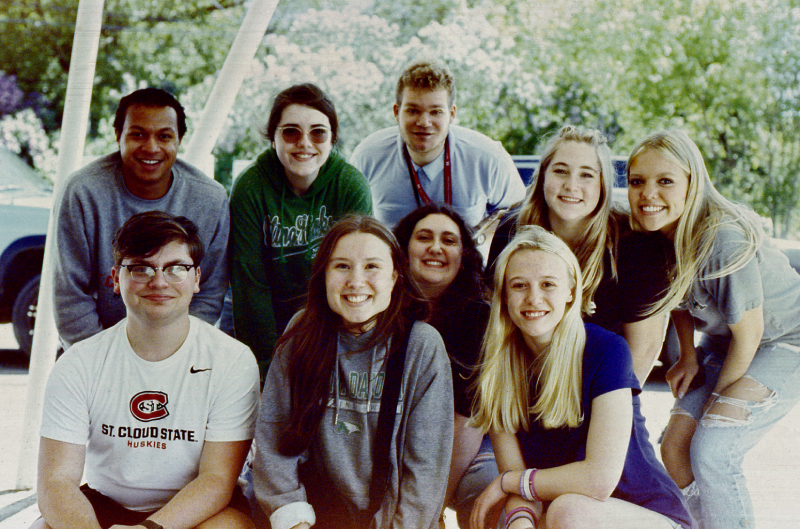

It was the only scan I had on hand of E100 pushed 3 stops. I was trying to demo that E100 pushes to 400 and 800 fairly well. A push to 400 is genuinely impossible to tell apart from E100 shot at 100 to my eyes. 800 is fairly grainy and has a bit more contrast, and colors do shift a bit, but it's usable. It's definitely worth it to be able to shoot slides indoors handheld. The photos I shared in my last reply were unfortunately exposed to a light leak. I just shot another roll of E100 at 800 and am just finishing up the first development now. I don't believe this one experienced a light leak.
OK. But if you want objective predictable results of potential benefits to others, you should start out with fresh film that hasn't already crossed over and gone bland, and with a balanced color target which doesn't involve dicey artificial lighting. And you'd need to make a series of bracketed exposures to figure out where in the scale of things it starts falling apart.
Then you need to think of "usable" in relation to a particular end. Is it just for casual web sharing, or perhaps for something more seriously reproduced if you happen to bag a special shot? There's only so much correction you can do digitally before things start looking fake. But have fun with the learning curve.

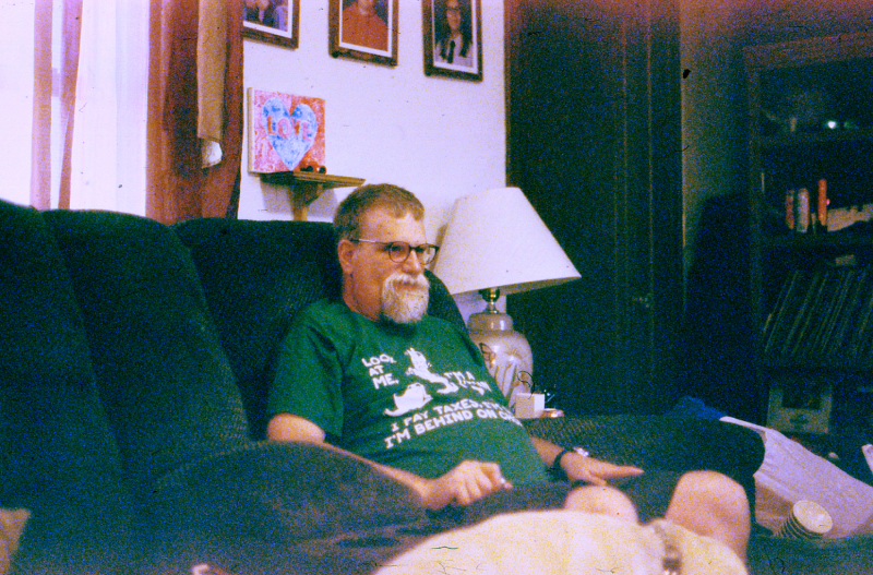

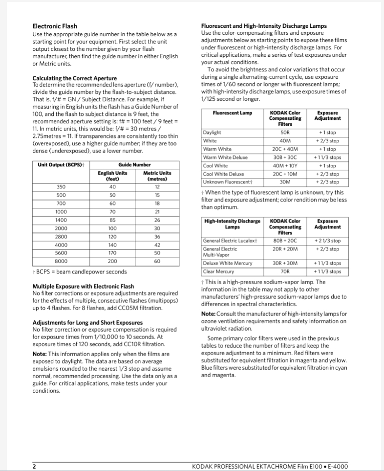

One thing to consider if you want to shoot without flash indoors. Ektachrome is balanced for daylight or electronic flash. You ought to consider putting on filters that balance out the light to restore it to daylight. For example, your first picture indoors with the graduate has fluorescent lighting. You get all sorts of color distortions that will be difficult to correct after scanning. Ditto with incandescent bulbs.
See this link for Ektachrome publication.
Ektachrome Publication
Pg 2 filters:

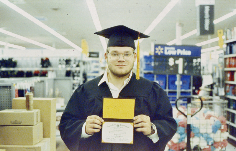

With all due respect, Caleb, but the examples you've posted here are very compromised in terms of image quality and while they may work for you, I doubt most people shooting slide film would find this even remotely acceptable. I'm sorry; they're really bad. Which is to be expected given what you've written about how you treat the film; expired film from unknown provenance, malfunctioning light meters, spooling film underneath a woolen blanket, no temperature control....if you're having fun, that's fine and that's the only thing in the end that counts. But this says nothing about the potential of the film. It just shows that you can get a recognizable picture even under very adverse conditions.
I absolutely agree that they're terrible. The first roll of actual E100 actually looks pretty good in person, but between the fogging and my absolutely awful scanner it didn't stand a chance. The second one? Something is off with that. I've got more E100 coming today; I'll load that up and shoot that at 800 too. I actually have been a lot better with temperature control when pushing film. Both samples were done between 104 and 105 F the entire time. It was the most accurate development I've ever done haha. Still, those were only examples of E100 pushed to 800. It looks great at 400, and I stand by that. I've attached some more images pushed to 400 to this post.

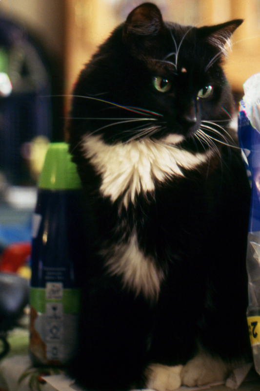

The scans certainly are nice especially if this is heavily pushed 100 speed slide film. And the cat makes everything worthwhile given its cute-factor!
Yeah, E100 can definitely do 400 without really any major problems. It gets a little redder and a little more contrasty, but the redness might just be my scanner (Epson V300). When done indoors without any corrective filters, E100 can look okay at 800. I wish I had scans of the roll I pushed to 800 in October. That roll looked great for what it was. You can kind of see a bit of that in the one image I sent of me in my cap and gown at Walmart. Colors are a little funky from being under artificial light and the grain is chunky, but contrast is totally reasonable. What I should really do is shoot a short roll at 800 and send it off to Dwayne's. They have absolutely wonderful E-6 development, though their scans are disappointingly terrible for such a great lab.
You need to include a neutral gray scale chart, going all the way from black to white, in some of your shots, to see how much color shift is actually involved. Being "scientific" about it means ironing out one variable at a time. Right now, you're trying to juggle too many eggs at once. And judge your results visually atop a high quality light box. Scanning might be necessary to present the images on the web, but that just opens up a whole new can of worms which itself needs to be untangled.
