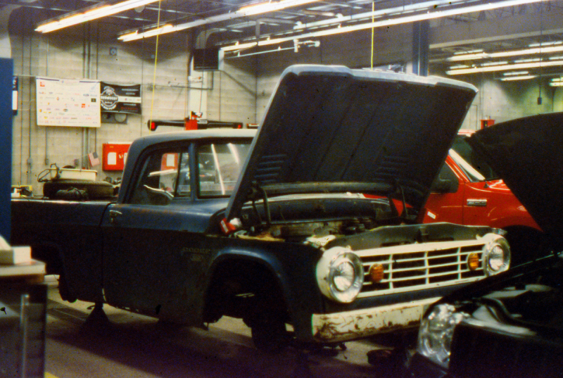

Have any of you guys actually pushed E100 more than a stop? I have, and it pushes incredibly well. I almost exclusively shoot it at 400 or 800, and at 400 there's no noticeable change. At 800 it does get cooler and grain is noticeably larger, but at 400 the grain was still invisible to my eyes and contrast and colors were normal. The first image was done at 800 on 11 year expired E100G. It was quite magenta before color correction, but modern E100 looks fairly normal. The second image was on modern E100 shot at 400 (though also slightly expired) and genuinely looks like normal E100.

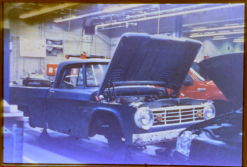

The blacks are clipped and show no details.

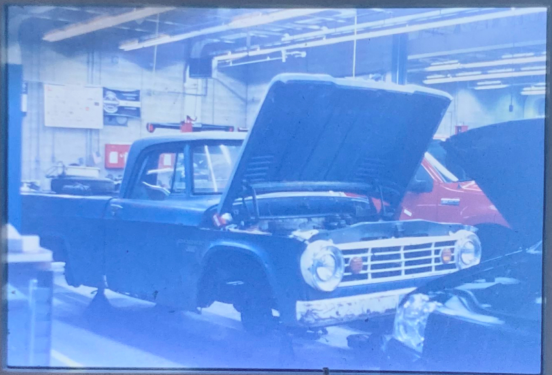

On the truck one, that's a result of my color correction. I have the original slide somewhere (only god knows where though) and it did have a reasonable level of detail, but film 11 years post expiry needed some work. I've attached a phone photo of the slide from when I had just developed it. If you look at the rear of the truck in the photo of the slide, you can see a more detail even in the phone photo. I also attached a slightly color corrected version of that image. As soon as I finish off the roll in my Nikkormat FTN, I'll develop a roll of modern E100 at 800. I have no idea how many photos are left (frame counter is broken) but I have to be close. At the end of the day, there are downsides to pushing E100 to 800 (400 has no downsides that I've found yet) like mild color shifts and a bit more contrast, but it's worth it to be able to shoot handheld indoors. It's not major enough to be very noticeable unless you're specifically looking for flaws.
