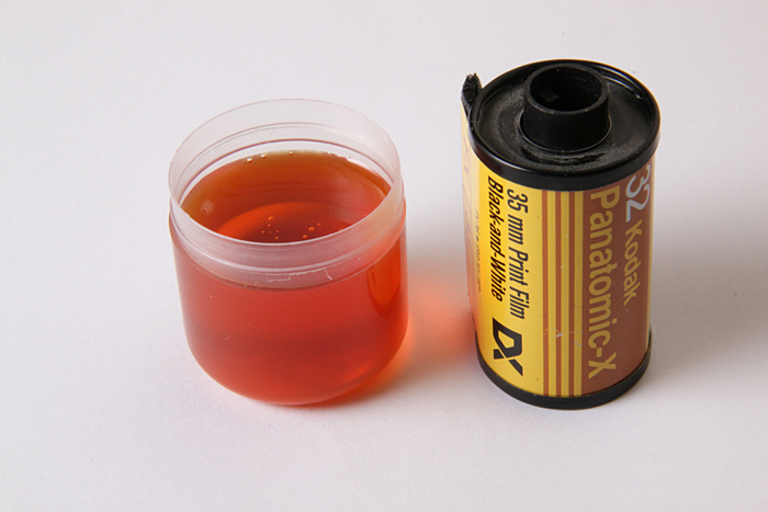

I have now completed this 12 month keeping test in which ~20ml D-316 concentrate in a 200ml bottle was exposed to air for ~30 min about once a month (1 year sample).
(1) HP5+ was developed in different quite fresh 2 months old D-316 for 2 x Xtol 1+0 time.
(2) HP5+ was developed in the above mentioned 1 year sample of D-316 for 2 x Xtol 1+0 time.
There is little difference between the negatives from (1) and (2) except there is a slight loss of density in the negs from (2), the 1 year sample.
Considering that this is a rather extreme test using only a small quantity of D-316 in relation to the size of the bottle, which was opened many times, and it is unlikely anyone would repeat these extremes in practice, IMO this is a satisfactory result.I believe Mark is running a keeping test which I hope would more closely represent conditions of practical use,and there may be results to come from this later.
Regarding the chemistry of deterioration of D-316,
Ascorbate oxidation is probably the cause of the slight loss in density.
Ascorbate hydrolysis is in my experience negligible, I once had a 50g/L solution of sodium ascorbate in a full sealed glass bottle that was still active after 5 years.
Phenidone oxidation probably only occurs after all the ascorbate is oxidized.
Phenidone hydrolysis is pretty slow, I once had a full sealed bottle of Mytol that took over 3 years to lose activity.
It can be seen that in the 1 year sample the concentrate has gone orange, I suspect this comes from ascorbate oxidation and will run a test using sodium ascorbate solution with nothing else to see if this can be reproduced.

Alan, thanks again for doing this 1-year test. Frankly, I'm surprised it did that well considering how orange it's become. I guess it's more robust than I thought. Even yellowing was making me concerned, but orange? My current formula is similar to D-316, so your results should apply to it. If a bottle were half-full on average, and opened for only 5 minutes when used, and kept refrigerated or frozen, I'd say it would last a few years.
Also, unlike XTOL which dies clear, the concentrate's colour tells us its state. Clear or yellow is okay. Orange means develop a little longer. Red probably means it's too far gone. Nice to know *before* developing film...

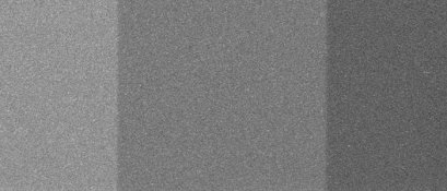

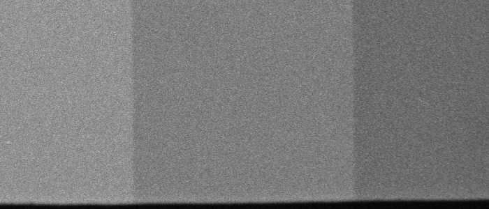

I've been pondering recent results:
* Concentrate 119P (aka Trial 20130119) (uses Phenidone) gives a hint worse grain with Tri-X than XTOL. With Delta-400, 119P is a hint better than XTOL.
* Concentrate D316 (also uses Phenidone) gives the same or a hint better grain with Tri-X than XTOL. This tells me that the higher level of ascorbate (or lower pH) improves grain with Phenidone.
* Concentrate 119D (same as 119P, but uses Dimezone S) gives slightly better grain with Tri-X than XTOL. That tells me that in this dev, Dimezone S is superior to Phenidone.
* Concentrate 214D (uses Dimezone S) gives significantly better grain with Delta-400 than 119P, and somewhat better than 119D. This tells me that the higher level of ascorbate (or lower pH) also improves grain with Dimezone S, and Dimezone S is already better than Phenidone. Here's a comparison of 214D and 119P with Delta-400:
119P: 13-06-119P-Ctr10.jpg 214D: 13-22-214D-Ctr10.jpg

Mark;
The synthesis of all of the Phenidone family of developers is rather straightforward. So, if there is a market, it might still be made. It depends on the size of the market.
As for the attached images, do my eyes deceive me or is the Dimezone S example less sharp? That would explain the apparent lower grain.
PE
Michael R and PE: The patches were not in perfect focus, so sharpness is impossible to gauge. I switched to another lens which eliminated the problem of corner-falloff. But the sharpness of that lens isn't the best. As was pointed out before, contacting is the best way to do this, and I need to build a fixture that will let me contact wedges onto 35mm film.
BTW, these developers have similar chemistry to D316, so I figured sharpness will be similar to D316, so I didn't worry about it. But it would be good to be able to check sharpness anyway...
The fine grain of 214D surprised me. At first, I thought the scanner must have been misfocussed, so I re-scanned the neg -- with identical results.

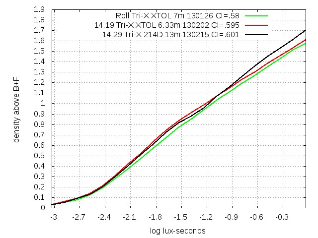

I scanned Tri-X strips, shown below. Same result: Grain is finer with 214D than with XTOL. But I included the bottom edge of the wedges so the Mackie lines would show. They're about the same. Also, I looked at edge-markings in loupes, and both XTOL and 214D are neatly outlined with black (Mackie) lines of similar density. So it appears that sharpening is comparable. Below, the 214D scan is on the right. The left scan is XTOL with slightly higher contrast than 214D, and the middle is XTOL with slightly lower contrast than 214D. Grain in 214D is a bit finer than both. To make the comparison fair, all three scans have been digitally adjusted to have equal contrast.
XTOL1: TriX-F1419-XTOL-Ctr10.jpg XTOL2: TriX-Roll126-XTOL-Ctr10.jpg 214D:TriX-F1429-214D-Ctr10.jpg
Here are the graphs of these three strips:
214D shoulders off later (black line), as usual for these D316-like developers. That should help folks who shoot in contrasty lighting, such as mixed sun and shade.
