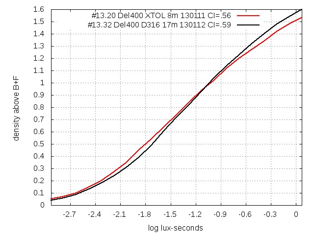

I said in an earlier posting that toes are slightly softer but hard to tell. I saw an unusually soft toe with Delta 400, so I'm running strips on it. The curves:
Red is Xtol; black is D316. Green is D316 but the half of the strip with more flare, and it serves as a second opinion of the toe. That toe is enough longer that it concerns me. D316's grain is finer, but would this longer toe cause significantly darker shadows than Xtol?
Mark
I realized that I could also measure the higher-flare half of the Xtol strip. Here are the Xtol-D316 curve-pairs. The left graph is with minimal flare; the right graph is with more flare but still shows the shape of the two toes.
This gives you two comparisons of the toes of Xtol versus D316.

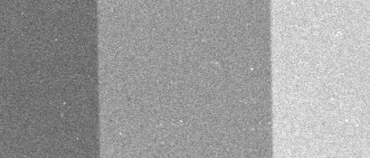

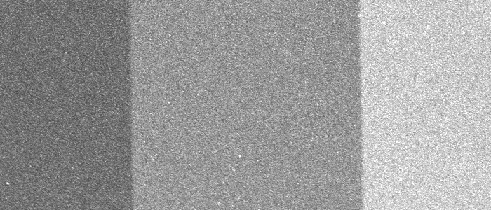

I'm calling this formula "Trial-130119", as that's the date of the first mixing (yesterday). This is also more concentrated than D316. It is very close to something I mixed 4 months ago, so it should not crystallize, but we'll know for sure in a couple of weeks. Note that I raised the sulfite from 45 to 50 g. That was solely to raise pH, but I might drop it back to 45 g. The time for Delta-400 is the same as D316 (17 min), and we'll see how times for other films are affected.
Grain is still a bit finer than Xtol, despite Xtol having the advantage of lower contrast. The scanner was manually focussed on the middle wedge and contrast adjusted to be equal:
Xtol: 13-20-Xtol.jpg Trial-130119: 13-00-Con119-50g.jpg

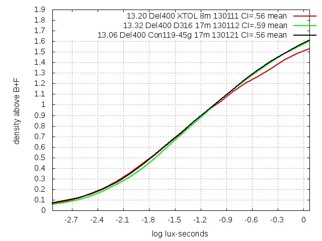

And the curves. Note that the toe is identical to Xtol:
As with D316, highlights are stronger than Xtol.
Fog is higher than Xtol. I noticed D316 produced a bit higher fog with a few films. Trial-130119 behaves the same. My experiments indicate that the fog is likely due to sodium metaborate mixed into propylene glycol, which Gerald Koch said produces esters. Could those esters boost fog? With both D316 and Trial-130119, Delta-400 has 0.12 more fog than Xtol, which is a lot. Fortunately, the scans show that grain is not affected. Maybe add a restrainer anyway?

Finally, the curve for Trial-130119 with 45 g/L of sulfite (reduced from 50 g/L in my prior posting) has this curious trait: The toe matches Xtol, and the highlights match D316. Here are all three curves for Delta 400:
The toes are the means of two frames, and my goal of all this was to remove the softness in the toe of the green curve (D316).
