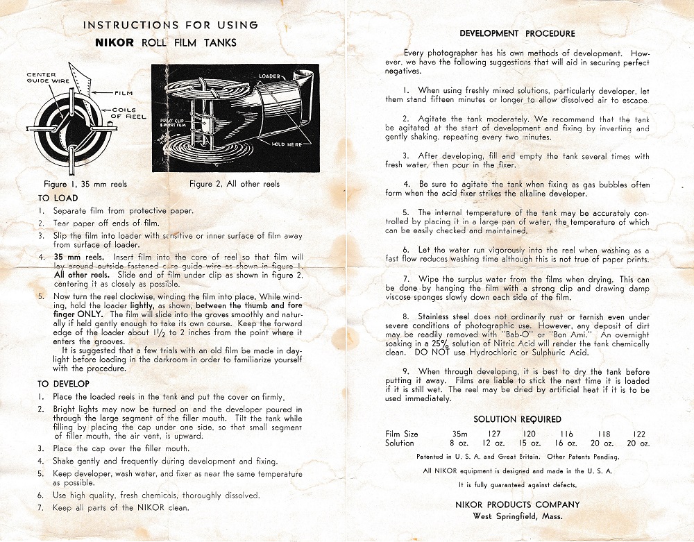

below are instructions for using the Nikor stainless steel guide for loading reels. I have the Nikor 35mm guide, it works pretty good.

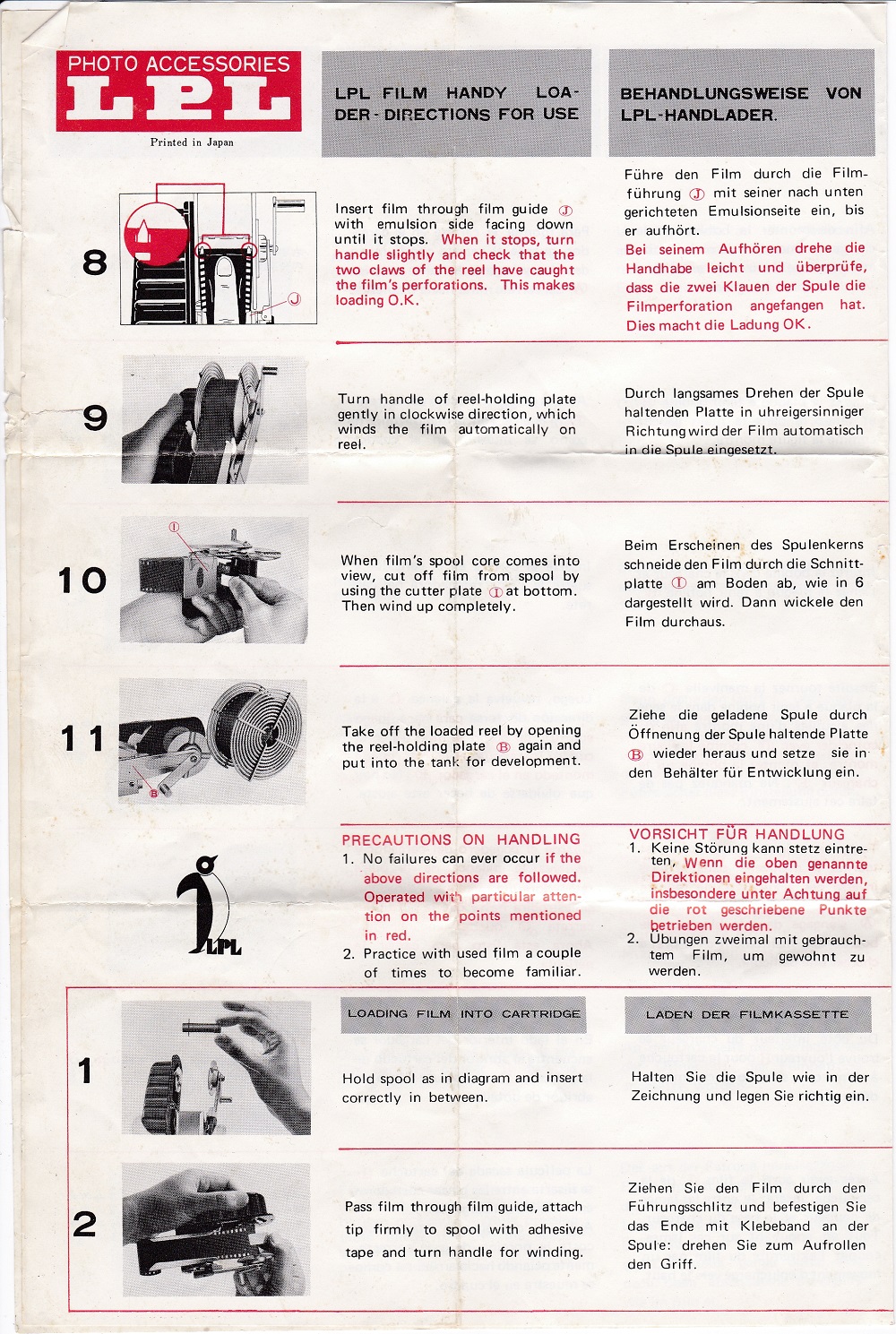

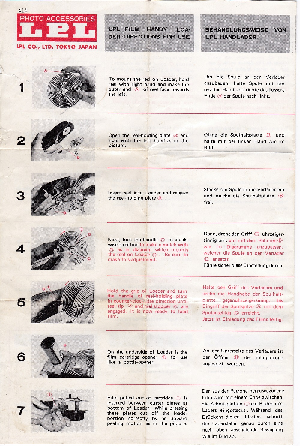

I also have one of those handy film loaders that have the same guide built onto a mechanism for winding the film onto the reel. Kinderman and LPL made those film loader devices for 35mm but I'm not sure if they were made for 120 film. The one I have works pretty good for loading 35mm film.
