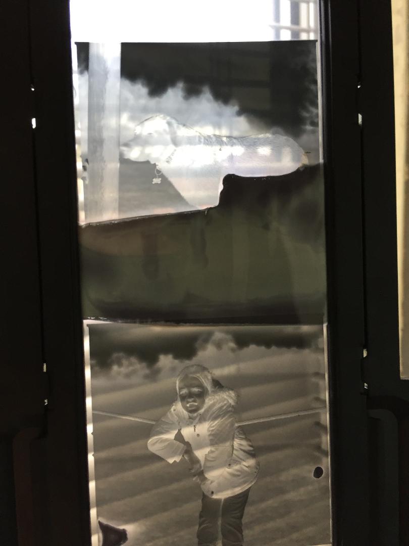

Hi
I have slowly being practising at loading 120 film onto my steel reel and am gradually getting better. But I am at the stage where there is almost always at least one frame that ends up like this (see attached) and I don't know how to fix my mistake. I'm fairly sure this is due to a kink in the film during loading but try as I might to detect such problems during the loading in the dark bag, I never manage to be sure the whole reel is loaded smoothly.
Is the attached "bleeching" effect caused by that or is it more likely to be something else with my technique? Thanks for any guidance.

It's not easy to do, but check to see if the reel is bent, the top reel will be unevenly spaced to the bottom reel which makes it impossible to load with out the film buckling and getting what you have. Once a steel reel is dropped it most likely is bent.

It looks like the film was touching itself somewhere due to a problem loading the reel. It blocks chemicals from reaching the emulsion when this happens.
I've a 120 reel that looks fine, and rolls straight, but must be slightly askew - any film I load in it starts to go off center and kink about half-way through winding.
I do have other reels without the issue, so only use this one when I have a lot of film to develop.
Following advice on this site I no longer use the center clip on that reel. It isn't as difficult as it sounds, once you get the film started, and this seems to have alleviated my problem.
