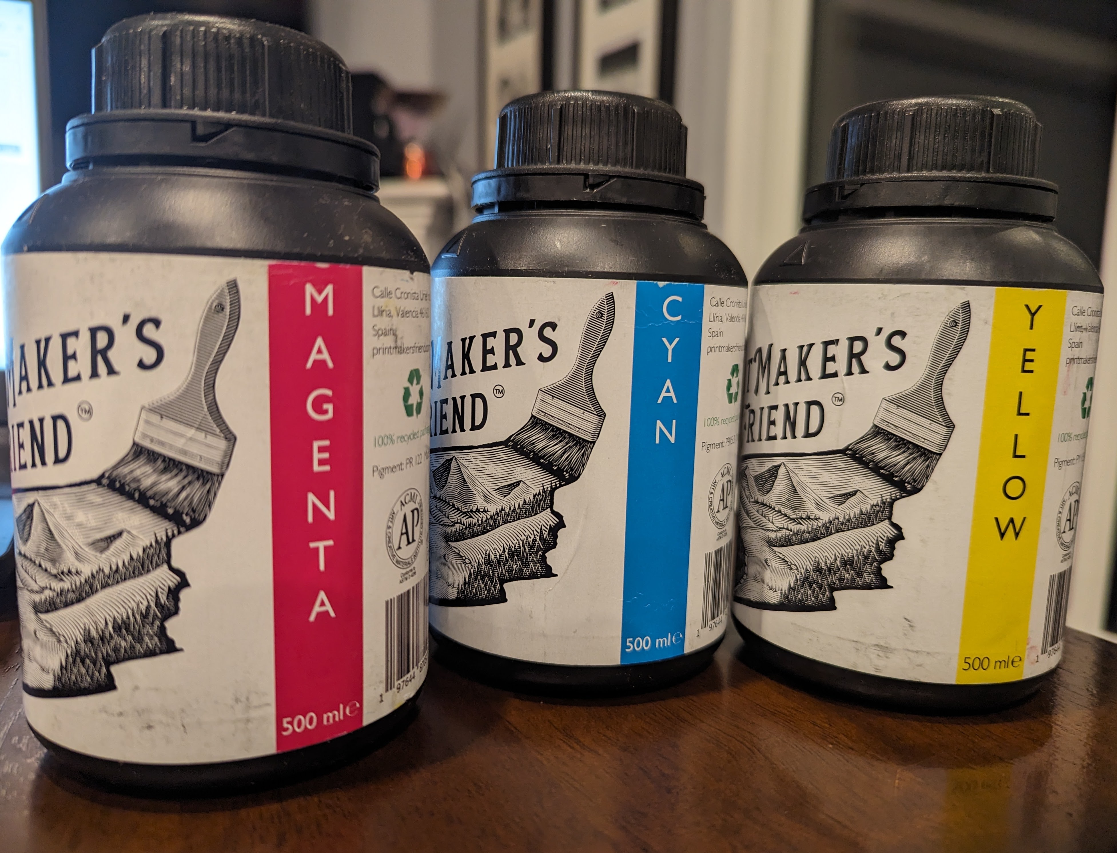

I just received PMF. One bottle of each of cyan, magenta, and yellow. The purchase price, plus shipping converted to Cdn dollars, then UPS fee slapped on top...Small fortune! Now I have to figure out how to use this stuff 🤔 (I know Calvin has an ebook...) Use it straight out of the bottle (pretty thick stuff) or dilute it with water... and I heard it's quite sensitive, up to 10x faster... I never size my papers for good old gum printing. I wonder if sizing is necessary with this stuff... Once I'm finished this carbon print I've been working on, I'll start playing around with it...
Does he sell it with pigment added to it already? I thought he sold it as a sensitized colloid to which you were supposed to add your own colorant. I see now that he offers both options. Neat.
Looking forward to some tests!
