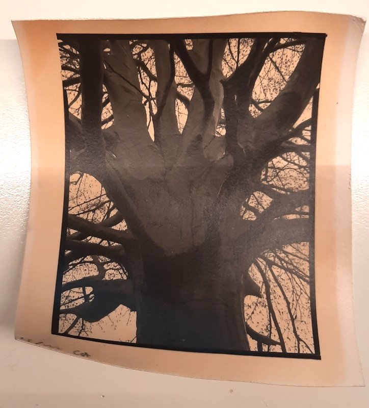

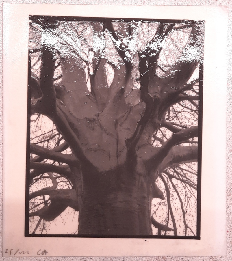

Okay, I gave the ferric carbon thing another go. I poured some tissues with ferric ammonium citrate and ferric ammonium oxalate added to them and a little HCl to acidify it. Initially I tried transferring to an albumen subbed transparency and that failed. The relief hardens alright and it develops too, but it won't adhere to the support, so it basically just drifts off like a polaroid emulsion lift.
Just now I tried transferring to gelatin-sized paper (hardened with chrome alum) and that sort of works:
In the lower left corner there's some fine detail missing, but most of the image seems to have transferred just fine. There's a lot of yellow-brown sensitizer stain and contrast is wonky as well. The trunk looks almost like a duotone instead of continuous tone. This may have to do in part with the sensitizer stain; let's see if I can clear that out once the print dries and hardens.
What this tells me so far is that ferric carbon can work similar to regular carbon, but it's more trick to transfer. Perhaps it could even be made to work transferring to a transparency that's fairly heavily gelatin-sized. If that works, it would in principle work for multiple transfers and hence potentially for color as well. Maybe I'll give it a try one of these days if I can put myself to making a batch of gelatin-sized transparencies.

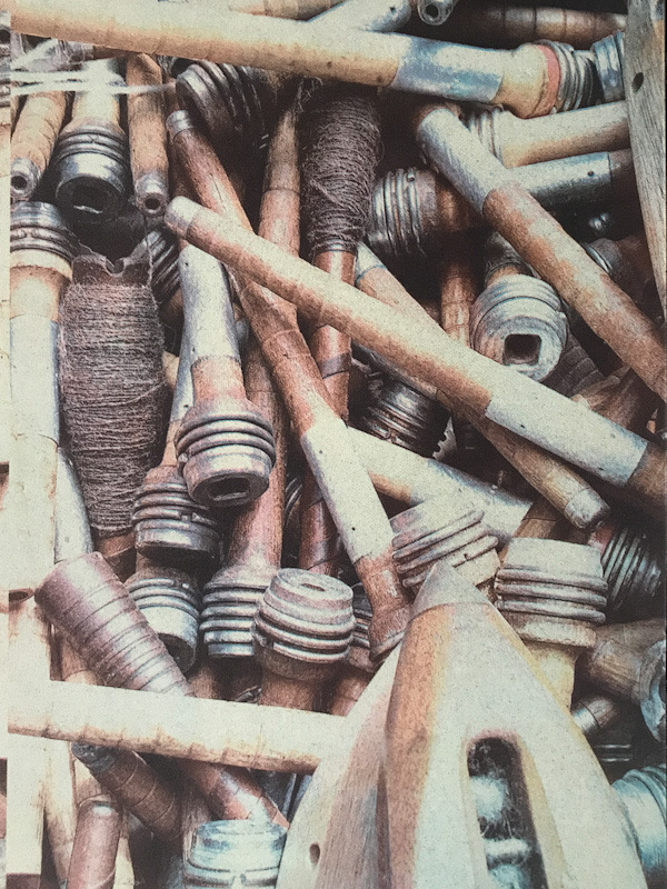

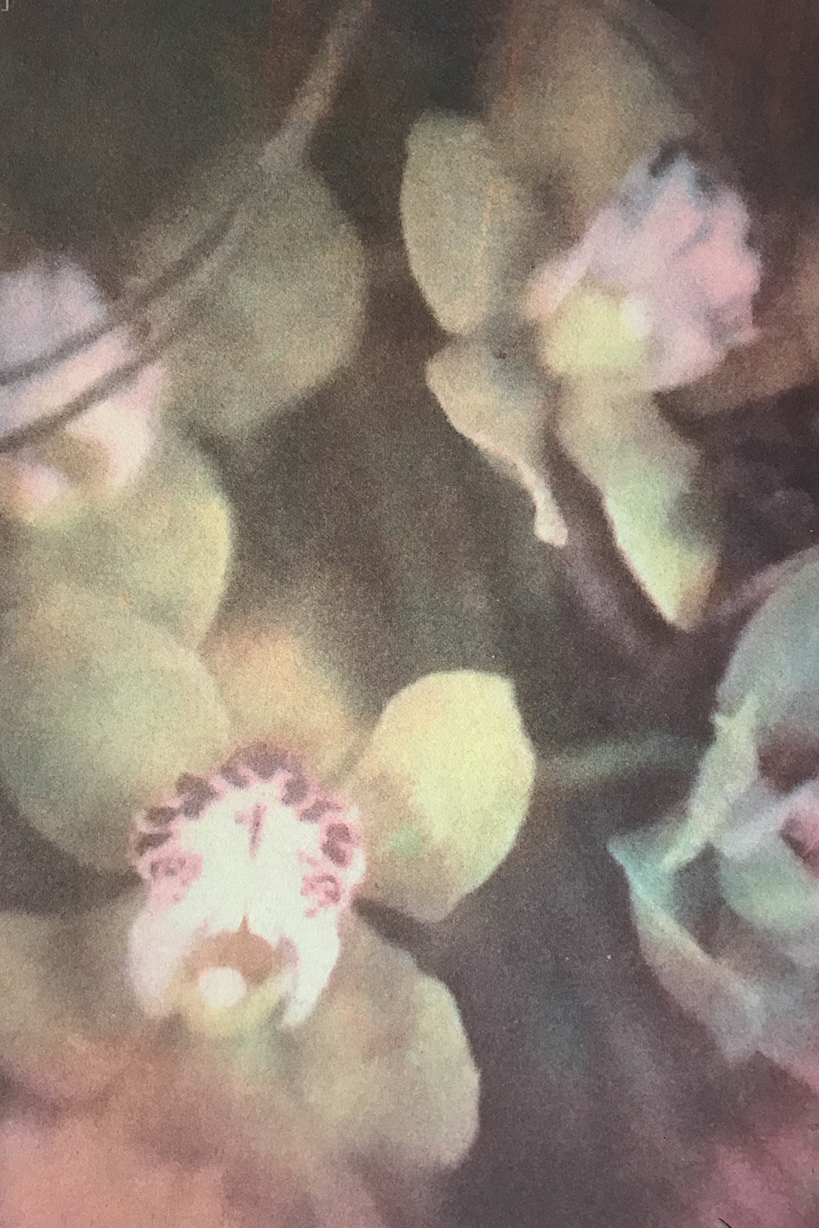

Hi, I don’t know if it’s very useful but I’ve been doing the ammonium ferric citrate thing with both gelatine and casein and have had reasonable results. The bobbins use casein, the flowers are gelatine based and the cloisters are gelatine and graphite.
I would say they are more than reasonable - they are rather lovely, particularly like the Flowers. Is the Cloisters one layer or multilayer? Can you tell us about the negatives?
Certainly so! They're intriguing. I really like the one of the bobbins due to its relative color accuracy. It suggests the approach is capable of quite good results.

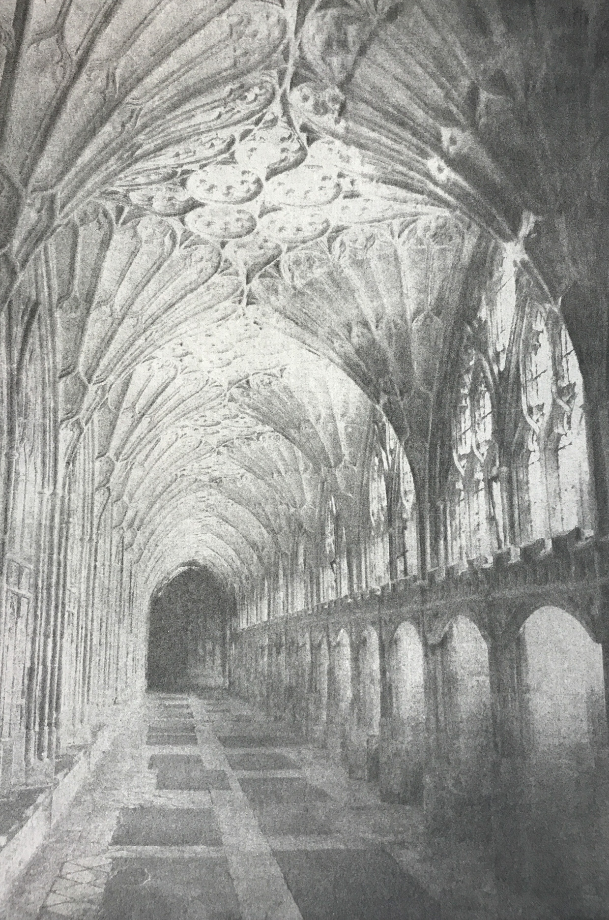

Thanks for sharing.
:Niranjan.
The cloisters are 3 layers. The negatives are CMYK digital transparencies separated in photoshop. I haven’t applied and specific curve adjustment. I hope to experiment with using scanned RGB filtered black and white film negatives eliminating the need for photoshop.

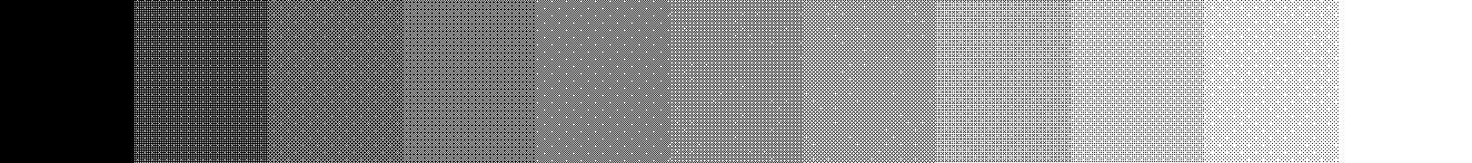

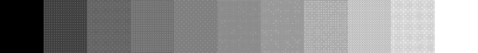

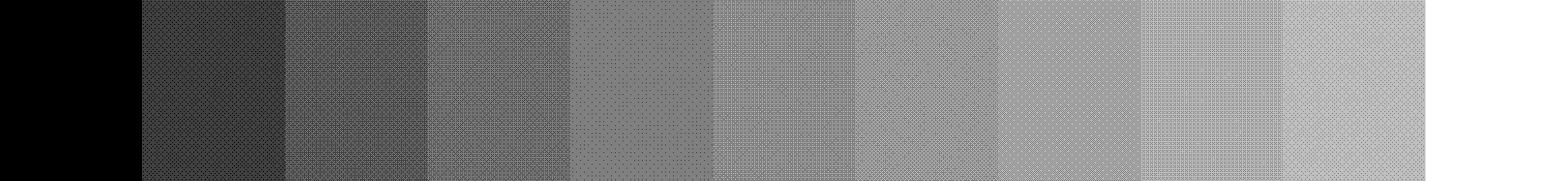

Niranjan,
Attempting to half-tone directly in the image via photoshop will lead to artifacts, as it will compete with the printer’s own half-toning algorithm. You would need dedicated software to take control of the printer, even then there are limitations as koraks points out. If you find a work around I would be interested to know.
OK...I played with it a bit. Took a 11-steps wedge and converted using PS via bitmap and printed on a glossy paper with 360 pixel/inch and as far as I can make out under 10X, the pattern on the paper is quite faithful to that on the screen, glitches and all. The way I printed did not involve any of the drivers - by what is known as Null Transform - which is fancy term for telling PS the printer is managing color and telling the printer PS is. I print all my diginegs that way. I am not sure if that is playing a role here or not. PS is also doing a pretty good job of making finer mesh of 720 pixel/inch (from the vantage of my rudimentary knowledge) that I haven't printed yet.
Here are the 2 files:
Niranjan.
Niranjan.

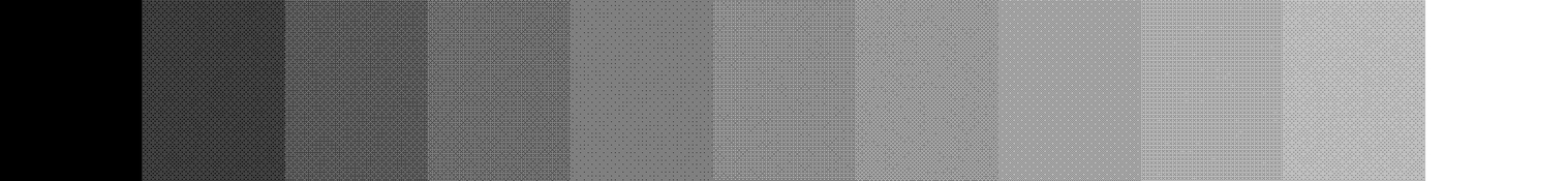

An update:
I printed the 720 ppi chart above the same way from PS and that one didn't come out as good. Seems that something did mess it up somewhat - the basic pattern looks similar but the dots seem to be mushed up a bit into each other, losing their individual character.
I then went and printed it from QTRgui (2880 ppi super mode, unidirectional) and the result was much more faithful to the original. Dithered Algorithm option selected was "Ordered," - don't know what that does, if anything, as it related to halftones.
For whatever this is worth....
