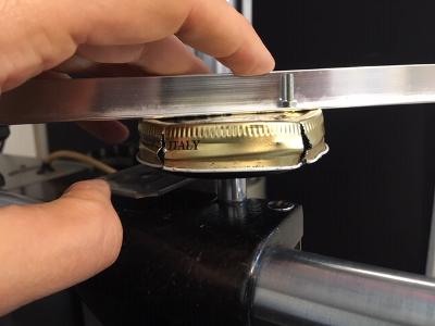

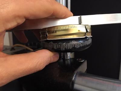

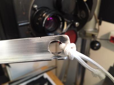

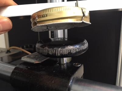

Hi peter,
what enlarger do you have? I can show you my diy focusing device for my Durst 138 if it could fit your enlarger.
bunip
May 13, 2012
282
Parma, Italy

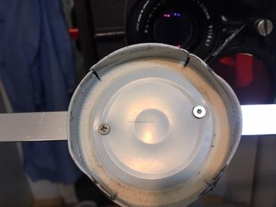

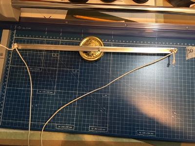

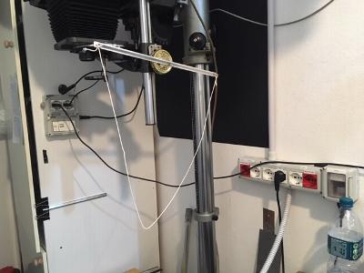

Nothing technological, just one rope to telecontrol the focusing knob. will add a picture or two. In my setup is very effective: I focus by eye, then move to the paper with a focusfinder and twisting the focus knob with the rope get micro focus adjustments
bunip
May 13, 2012
282
Parma, Italy

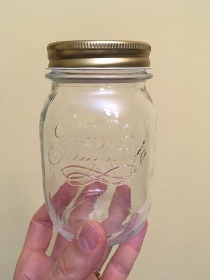

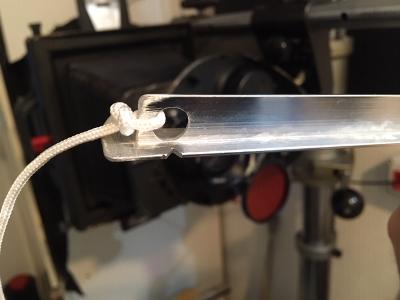

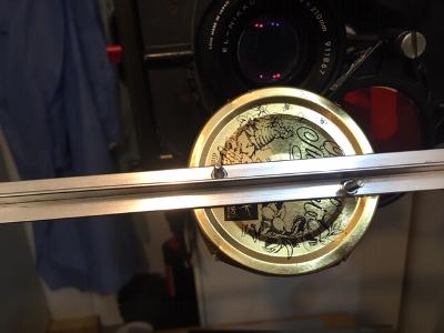

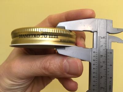

I took the lid from a jar the same of the focusing knob diameter, screwed it to an aluminum rod and attached a rope to it. When you need fine focus tuning you apply the rod+lid to the focus knob and turn it by pulling each rod’s side b the rope making twist the focus knob. In this case you can focus with more precision even with the vertical projection (not as far as in lateral but often just a little too far for my arm). In lateral projection you have to add a second rod and one rope each side so you have one focusing rod attached to focus knob, one rope each rod’s side and a second rod in your hand (imagine to drive your kite in the sky) Focusing is done first by hand and eye turning the focus knob the usual way just to get near the right focus, then you apply the rod to the focus knob and go to the paper on the wall with the focusfinder in one hand. in the other hand you have the rod connected to the ropes connected to the focus rod that you’ll twist until focus is ok.
