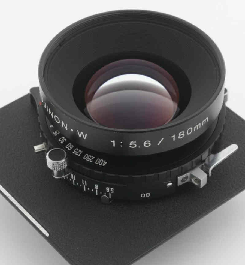

The odd-size that seems to get little love is 180mm. I think most people feel it is in the awkward middle ground between 135/150mm and 210mm. For those not heavily focused on wide angle,135/180/250mm would be a nice set-up.
Before I was hired as the lab tech, the uni bought several Calumet 4x5s with Caltar IIN 180/5.6 lenses. They turned out to be useful lenses for the student, as we could only afford one lens per camera (I slowly could widen out the choices).
My Fuji W 180/5.6 (inside writing) is currently my main 5x7 lens. I have been tempted to find an inexpensive Fuji W 180mm with outside writing (less coverage than inside writing, but plenty for 4x5) to keep in my 4x5 kit.
xkaes
Mar 25, 2006
5,205
Colorado
The Fujinon W 180mm f5.6 has a 6/4 design and a 58mm thread. The NW model is a 6/6 design with EBC coating and a smaller IC. It came in two versions. The difference is that one has a 62mm filter thread, and the other a 67mm filter thread. I have the 67mm filter thread version, but have no idea which came first. Either way it is a hunk of glass. There is also the newer CM-W, which has a 67mm filter thread, a 6/5 design, and an even smaller IC.

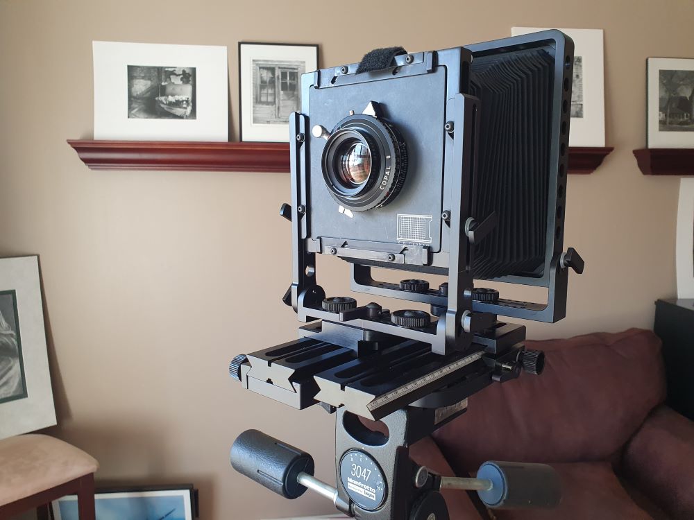

I posted that it was delivered yesterday.....was going to post a pic of it on my new to me Canham45 but ran into problems uploading a pic from my phone......
Chuck_P
Chuck_P
Feb 2, 2004
2,369
Kentucky
Ok, uploaded this from my desktop and no problems loading this one. The 135mm Sironar N lens arrived quite unexpectedly yesterday based off the tracking messages I was getting. So here it is on the KB Canham45 DLC with the lens at infinity focus. Robert Frost's poetic line in his poem, "Stopping by Woods on a Snowy Evening" comes to mind "........I have promises to keep, and miles to go before I sleep, and miles to go before I sleep."
Well, I have a darkroom to complete, and money to spend before I print, and money to spend before I print. But these two purchases are the single biggest ones and so I'm getting closer.
