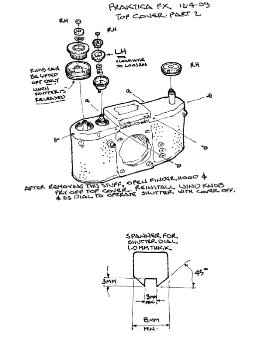

I have a Praktica IV (several actually) with a jammed shutter - jammed cocked.
Having taken several to bits out of curiosity I have a good idea how to open them up; but here's the problem.
The advance lever can only be removed when the shutter is released - but I can't release the shutter so I can't get the top cover off - catch 22.

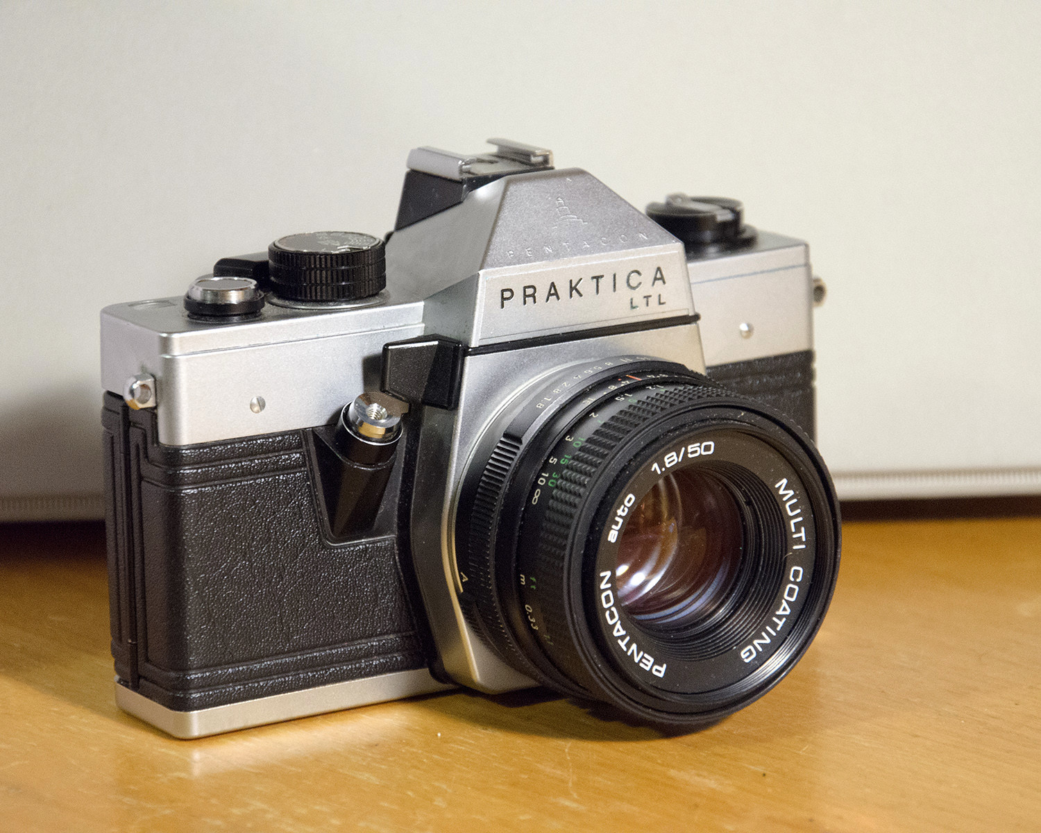

I just picked up this camera, marked as a Praktica LTL. However, the leatherette, plastic-tipped winder, rewind knob and split screen focus aid in the viewfinder are all consistent with later models, specifically the MTL 5. Does anyone know if this variant of LTL was supposed to have existed? Maybe someone serviced an MTL 5 at some point and put an LTL top cover on it. I have not found any index of Praktica serial numbers vs. model or date to check against.
Praktica LTL by Howard Sandler, on Flickr
Interesting. My old LTL, bought in perhaps 1972, has rather plebeian leatherette covering, no plastic tip on the advance lever, and a self-timer. Focus aid is a microprism circle.
I assume that on the L-series the split-image focusing aid was only included from the 3rd generation on.

Finally a diagram for removing the top cover. (I was reluctant to post this as I can't acknowledge the origin -
I can't quickly find the site it came from - if anyone recognises it please let me know).

Finally a diagram for removing the top cover. (I was reluctant to post this as I can't acknowledge the origin -View attachment 241232 I can't quickly find the site it came from - if anyone recognizes it please let me know).
