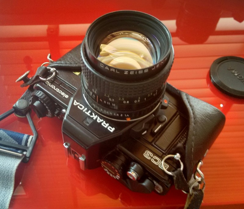

In these last years I must confess my Praktica B kit (Flektogon 20mm, Meyer 28mm, Flek 35mm, Pancolar 50mm f1.4 MkI and II, Pancolar 50mm f1.8, Sonnar 135 mm f3.5, Vario-Sonnar 80-210mm) has become my most set, as it covers everything, the BC3, Jenaflex and BX20 are smaller and handy for stree photography, and while not as good as a Pentax LX they are somewhat very similar in ergonomics and operation.

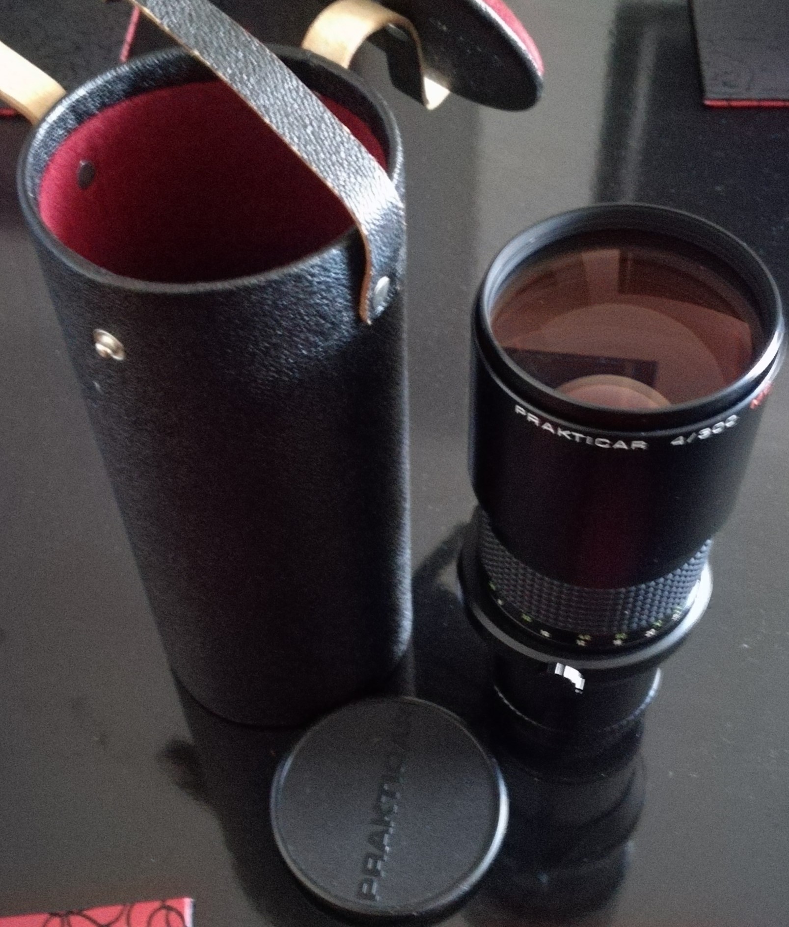

Last catch on ebay: the Sonnar 300mm f4. I am close to completing my B system, just the 80mm and the 55mm remain among the "really produced" lenses.
