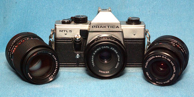

YO !! Christmas came in MARCH 2019 !! I was GIVEN a Clean MTL5 3 lens outfit with 'Hunter Effects Filters' and Agfa Vista 200 24 exp and a Sunpak SP140 flash at Club last Friday by our Club Web-Master who got it from his Cousin. Batteries were all corroded in flash but I have cleaned it out and now works and there was a spent Mercury battery in Camera ( Luckily NO Leakage) . Camera is 'Mint' and lenses have NO Fungus; All marked 'Carl Zeiss Jena DDR' I used the Agfa Vista 200 for first tests-- came out a bit 'Thin' even though I had given it extra exposure due to no doubt bad storage for years since the Donor went 'Digital'
Praktica MTL 5 3 lens outfit by Peter Elgar, on Flickr
35mm f2.4 Carl Zeiss Jena MC Flektogon DDR
Noice! A while ago I think I paid about £20 for an MTL5b, with 2 and a bit lenses; Pentacon 135mm thing, Paragon 35mm something-or-other and 2x Zeiss Tessars which were in bits, one of which I successfully rebuilt. Finally got round to using it, and I'd forgotten what solid feeling cameras these were. They were fairly cost reduced budget cameras, but also pretty well built.
One for free, particularly with Zeiss lenses is quite a win!
