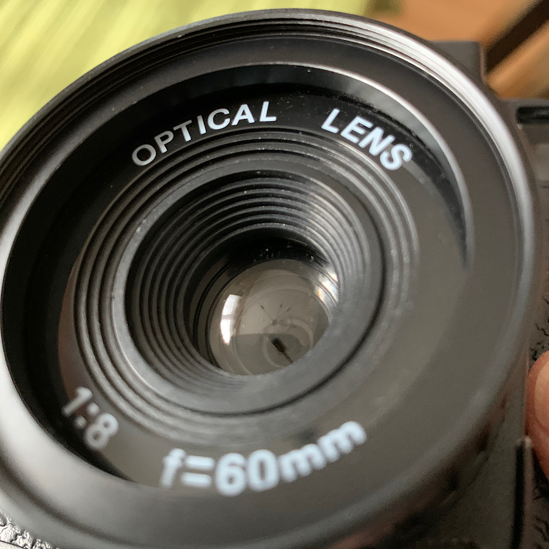

Those are closer to what my Holga produces. I wonder if your newer one has had the lens reversed.
Is there a way to check?
The "Optical Lens" in a classic Holga is a plastic meniscus, convex to the world with the aperture behind. A meniscus actually gives "better" images (less field curvature, at least) if it's installed concave to the world, behind the aperture (this is how Kodak did it in their lowest tier cameras for decades -- even the Brownie Hawkeye has this setup as originally sold). It's been my opinion that installations like the Holga's were done to cut down on returns and complaints over the "missing" lens (because the lens isn't visible when the shutter is closed).
If the lens is reversed, it's usually kept in the same location (focal length doesn't change), but the aperture winds up on the "wrong" side, the convex side, which doesn't limit field curvature as it does when it's on the concave side. So, if I Holga had the lens reversed, it would be concave on the front surface rather than convex.
