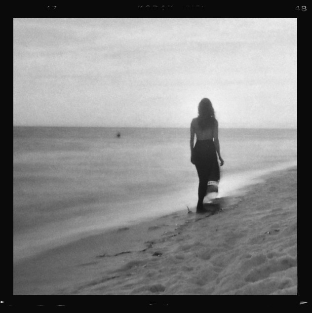

"The Girl in the Black Dress" Holga 120N // Kodak Tri-X 400 // 20 sec exposure
The Story:
While on our travels last Nov, the wife and I were sitting on the beach watching the sun set. Then this young girl came walking by wearing a silky black dress. I jumped up and asked her if she would pose for me. She agreed and stood very still for a 20 - 30 secs exposure. In order to judge the distance of this shot, I used broken plastic toy shovel placed beside her left foot. This is the end result

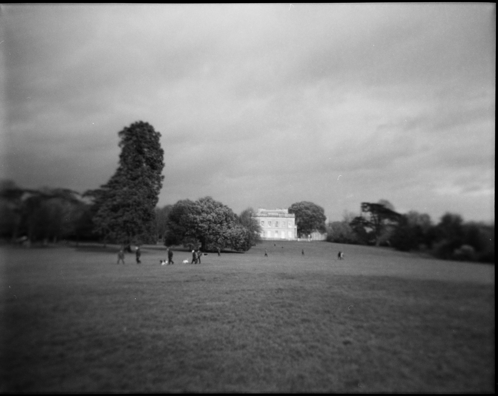

Can these cameras be of any use at infinity? It's all just blur with mine. So far i'm finding it best to be close to something to frame.
You just may have an example that needs the focus adjusted. I've seen a procedure for this somewhere -- YouTube, Instructables, somewhere else, don't recall, but it basically requires some disassembly to adjust the infinity stop so you get correct infinity when the lens is all the way back.
Cheers, I wasn't sure if the results I was getting was to be expected. On inspection I found that the close-focus and infinity stops are some plastic tabs interfering with a screw so a fix shouldn't be difficult.
I had my suspicions about infinity focus so took this photo at the sunny aperture (i'm guessing f11 isn't accurate) to see if I got anything "sharp".
Is it focusing past infinity in your opinion?
Seems very possible. One way to check is to put a piece of frosted plastic where the film would got (with the camera back off), hold the shutter open on B, and see if moving the lens off the stop a hair improves the focus. I wouldn't use a loupe (got one built in, I'm significantly myopic), but most would need one.

Every Holga I currently own is good at infinity, so you may have one where the stop needs to be adjusted. I'm guessing yours is past infinity, otherwise, if it wasn't quite there there would be something sharper in that image.
Wouldn't be the first time that one was made incorrectly, that entire run of HolgaPan's had the same problem a year or so ago.

Hi. These were all taken with the normal setting, handheld. I've yet to use it on bulb-mode.
I was only concerned about the last image I showed because i'm fine with the way it is otherwise. I had observed that every time i've set the lens to infinity (mountains) nothing is ever holga-sharp. As you can see in the other images where i've guestimated a close distance there is at least something "sharp" in it.
I have a film i need to get through in this camera before checking where infinity actually lies.

I think i need to clarify, that's not my concern. It's a moulded, plastic meniscus lens so I get what I get. My concern is that nothing in the centre is in focus/sharp at infinity.
The plastic lenses work just fine in a Holga when its put together properly. That's the whole point of the "charm" and "look", otherwise I'd just shoot my 500cm.
Jonno85uk, I think you just got a bad example. The new Holga 120 Pan I bought last year from Freestyle was the exact same way, and I know because I checked it with ground glass on the back. I sent it back since I already had one that was working and told them to let me know when they got a working batch in. Still waiting for that email!

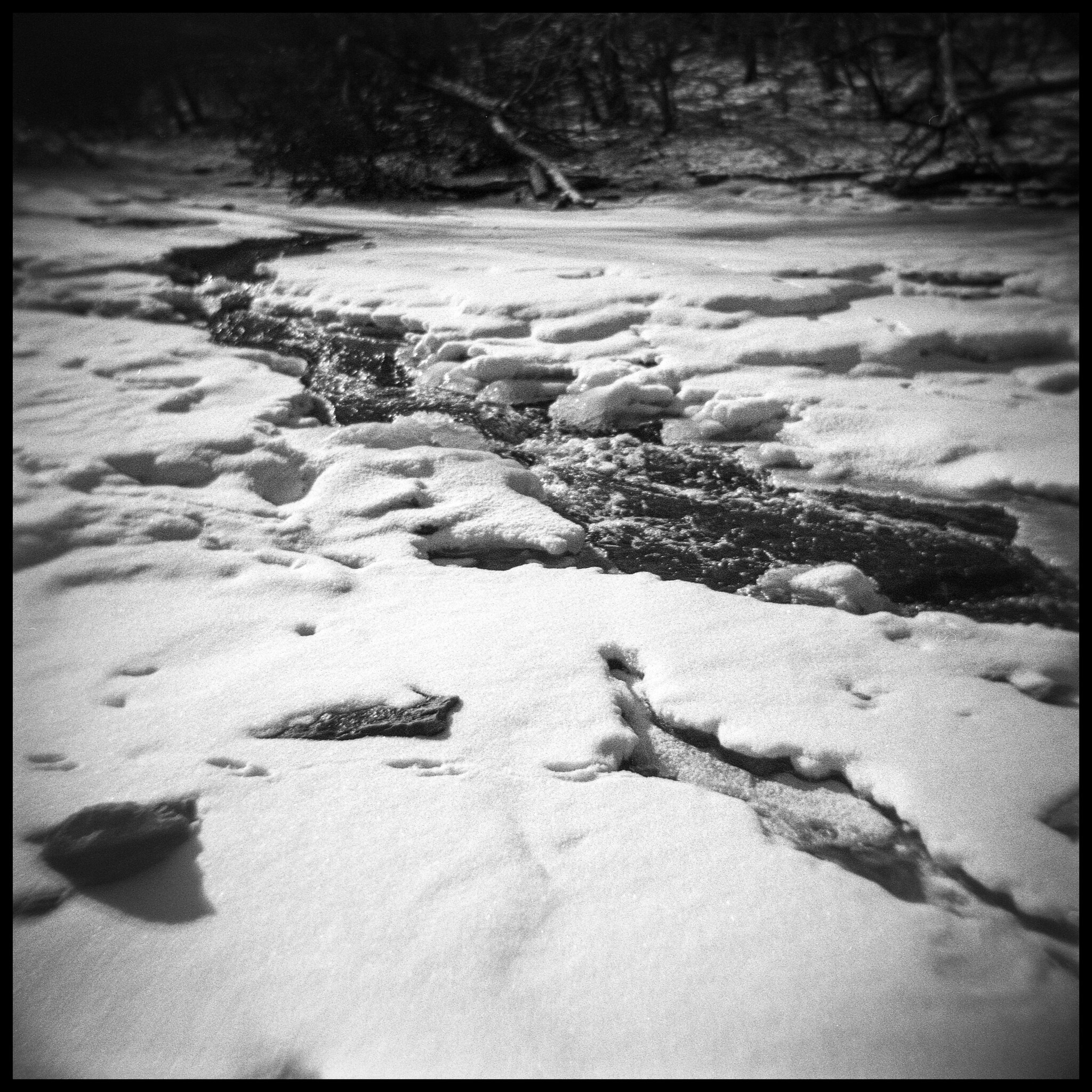

To get this thread back on track, here's one from last weekend while hiking in the snow at a nearby park.
Shot on HP5+ and semi-stand developed in Rodinal 1:100 @20C for 60 minutes.
"If I Had a River"
Jeremy
These were taken at a local park the morning before a blizzard in late January, which was due overnight that night. The sky was very overcast that morning.
The pier was destroyed in a past storm and is in the process of being rebuilt.
The benches up along the water, looked very lonely.
  • Camera: Holga 120N (original camera with defective aperture, which is always on Cloudy regardless of the switch setting). No light leaks detected on negatives.
  • Film: Eastman Kodak Company - Verichrome Pan (expired November 1997)
  • Photo Developing/Printing: The Darkroom (San Clemente, California)
  • Scanner (at home): HP OfficeJet 3830
