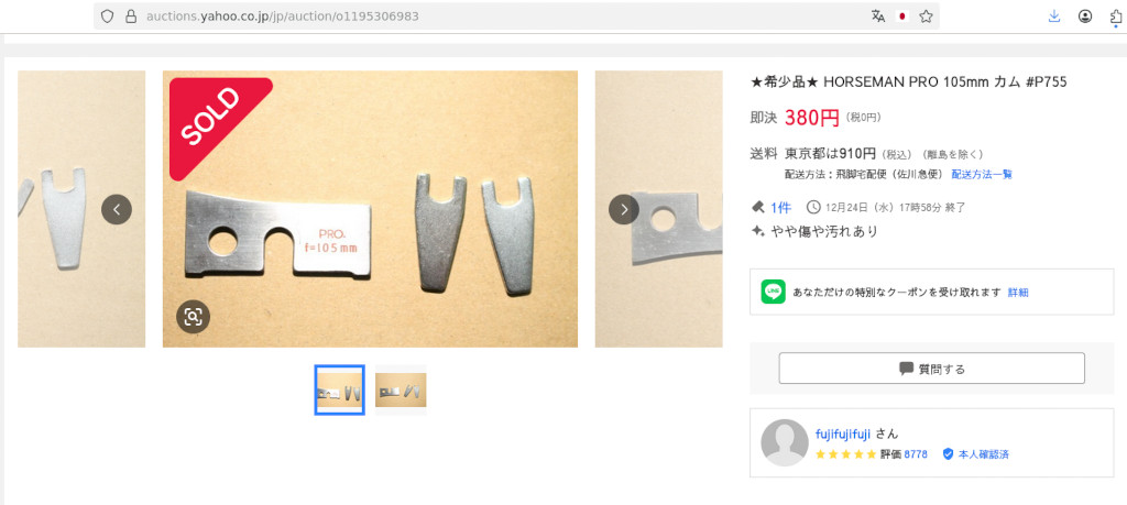

I bought in january a 105mm cam for 380¥, in american dollars, currency converter tells it is 2,38$
On Yahoo Japan ((you may need a VPN in Japanese, to display the page):
in screenshot:

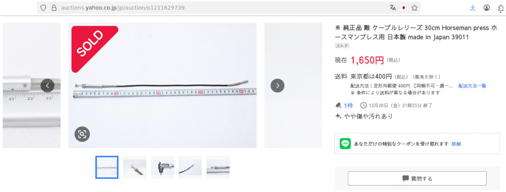

also bought a Horseman release cable for 10,34 $:

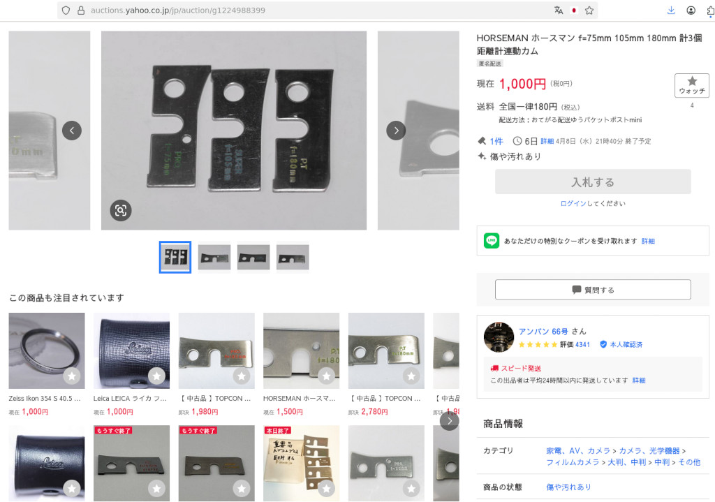

by now most Horseman cams on Yahoo and Mercari sell between 1000¥ and 3000¥. For instance on Yahoo right now:

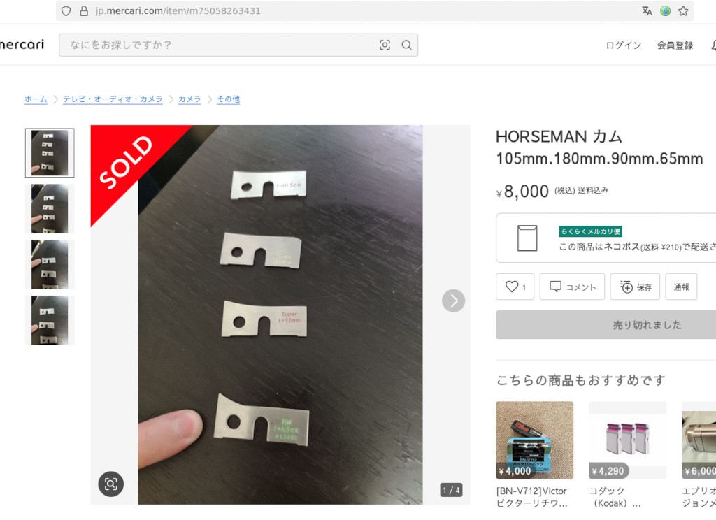

Five years ago I bought a set of four cams for 8000¥ ~50$
