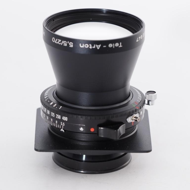

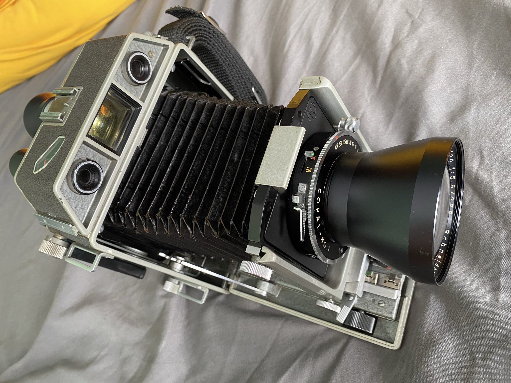

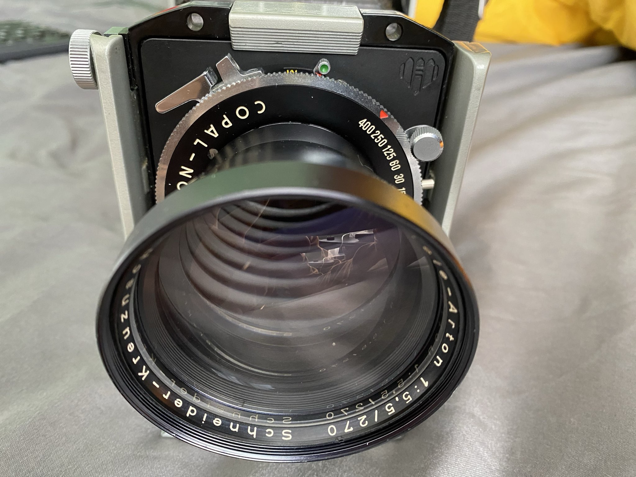

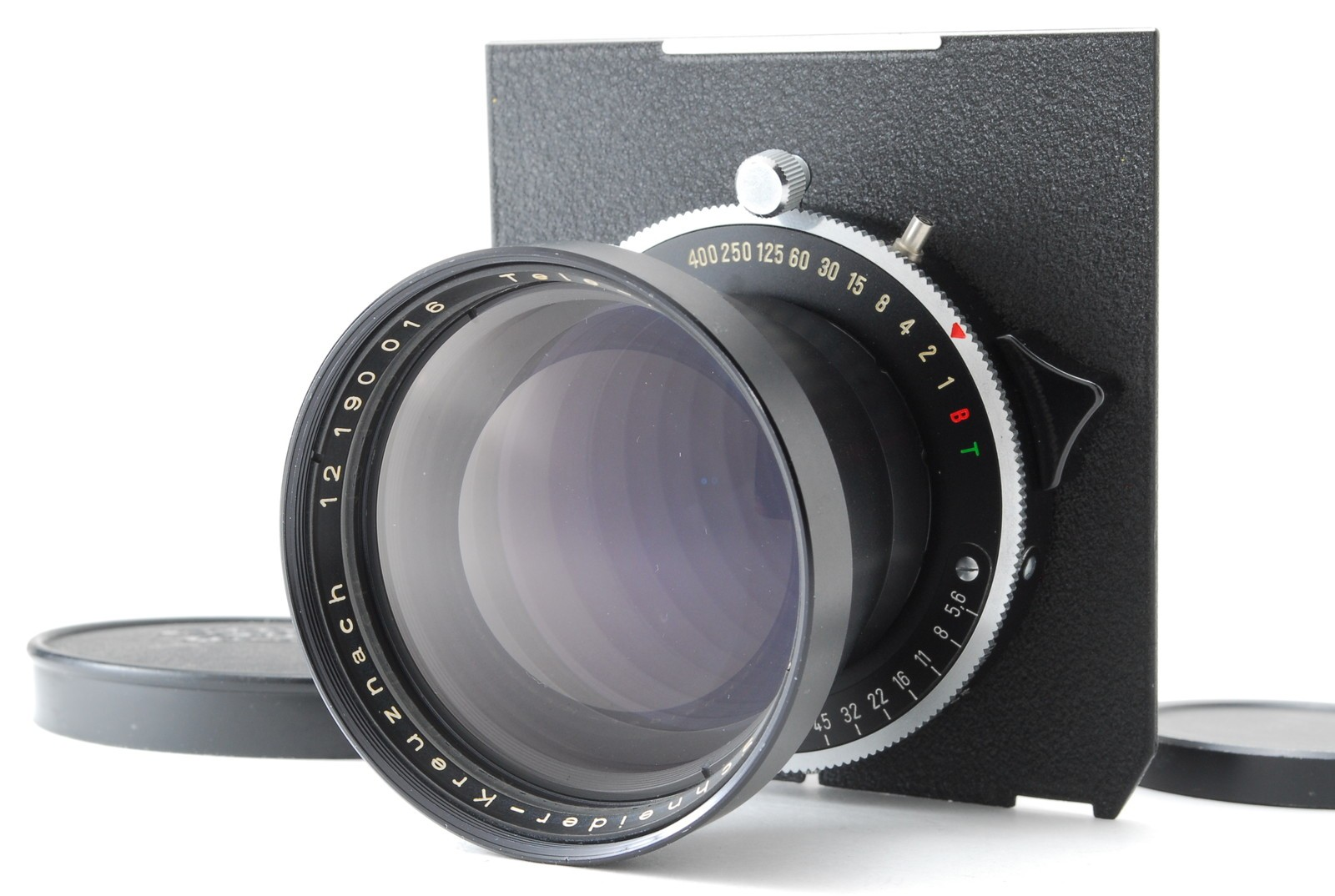

I did receive the 270mm Tele-Arton today. It's the (I think) newer version that looks like this:
I measured the infinity distance roughly in the 152mm range figure that I found online. Maximum extension on the Horseman 970 of 300mm puts it approximately at 0.915 meters focus. That should make it usable as a portrait lens at a fixed 1.5 meter head and shoulders distance if I calibrate its infinity stop in conjunction with the 1.5m rangefinder setting. All other distances will probably be off.
Don't yet have the lensboard or 180mm cam for it, coming soon.
The last version has outside printing rather than the inner trim ring.
reddingstore_11950

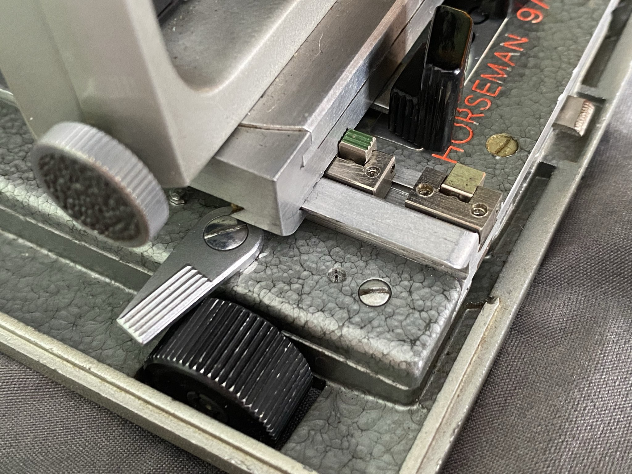

The oldest one (I think its oldest, its a Compur shutter unlike mine or yours which are in a copal.) has more of the lens behind the the lens board than in front of it.
@abruzzi Must be the middle version then. The flange focal distances for the 3 versions I saw floating around were 152mm, 158mm, and 178mm. Could be mine is 158mm, I used a ruler and the film plane was my sweater.
The lens board came today and I was able to take some measurements. The 180mm cam comes tomorrow.
Schneider Tele-Arton 270mm f/5.5 Lens (middle version, black but with text on inside of ring)
On 6x9, this is the 35mm equivalent of a 115mm f/2.4
Flange Focal Distance (infinity): 158mm
Max extension with Horseman 970 when infinity stop is set correctly: 228mm, which focuses 1.65 meters from film plane, 0.14x magnification
Max extension with Horseman 970 when infinity stop is at absolute end of rail: 242mm, which focuses 1.37 meters from film plane, 0.18x magnification, infinity is lost (8.3 meters farthest focus)
Note that this is a with a flat Copal #1 board and you could get it a little farther with a special board
Also note that with the flat board the lens has to be rotated somewhat oddly so that the user has access to all the controls on the small 80mm horseman board
Infinity focus
Infinity focus stop
1.65 meters focus
Odd orientation

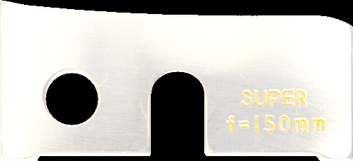

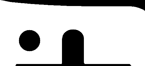

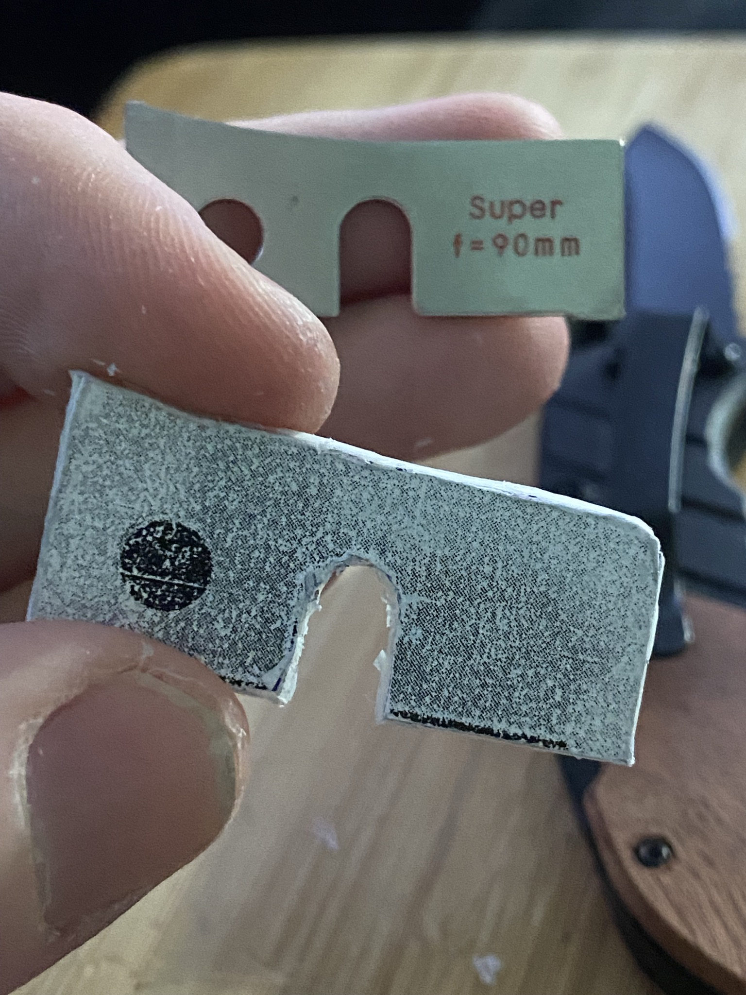

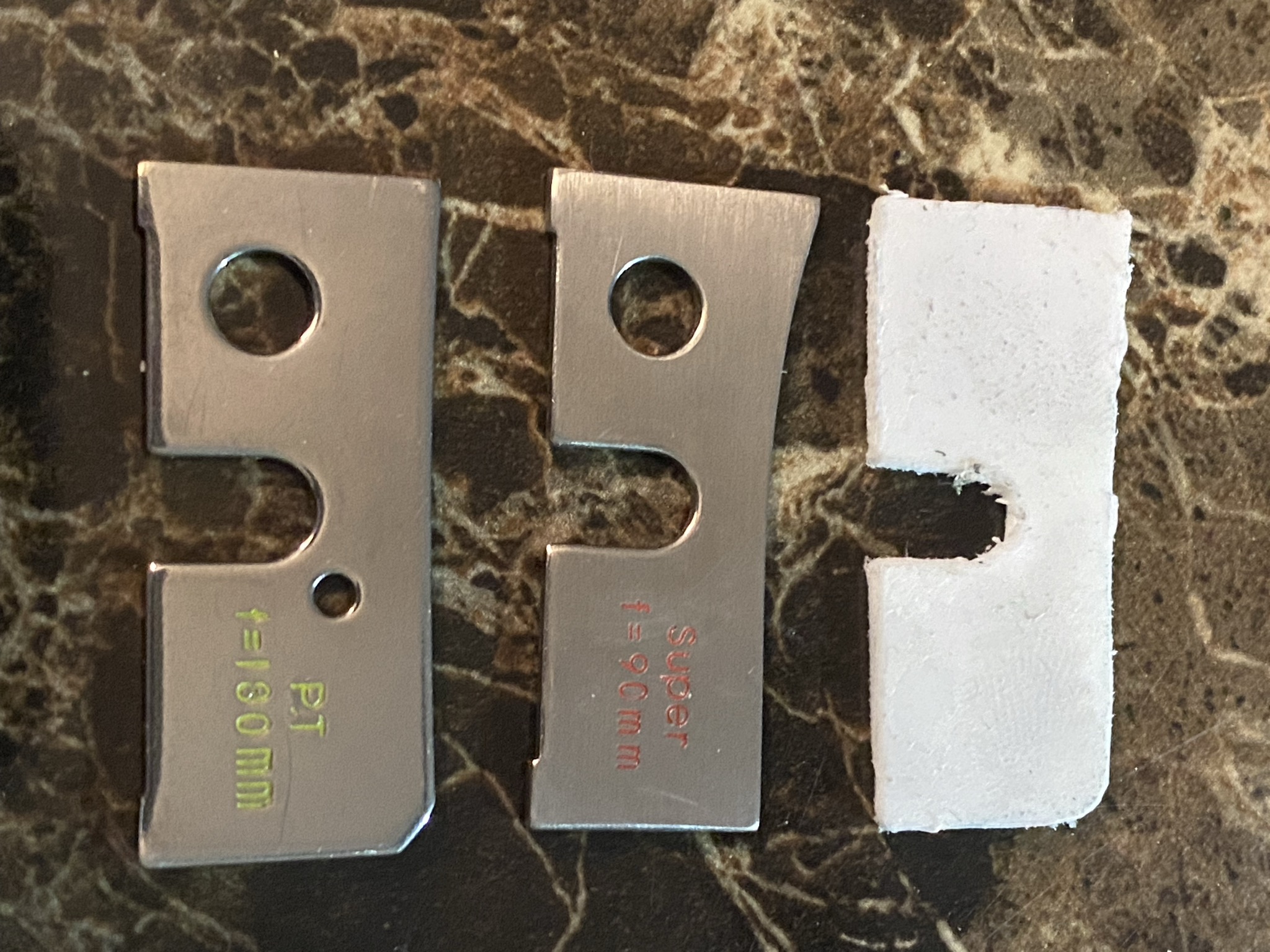

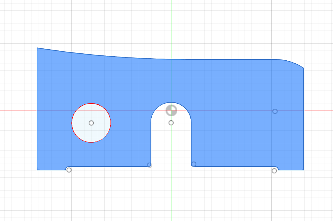

I decided I would try to make the 150mm cam, prices for it are crazy. This is the reference image I settled on, it needs to be exactly 40mm wide:

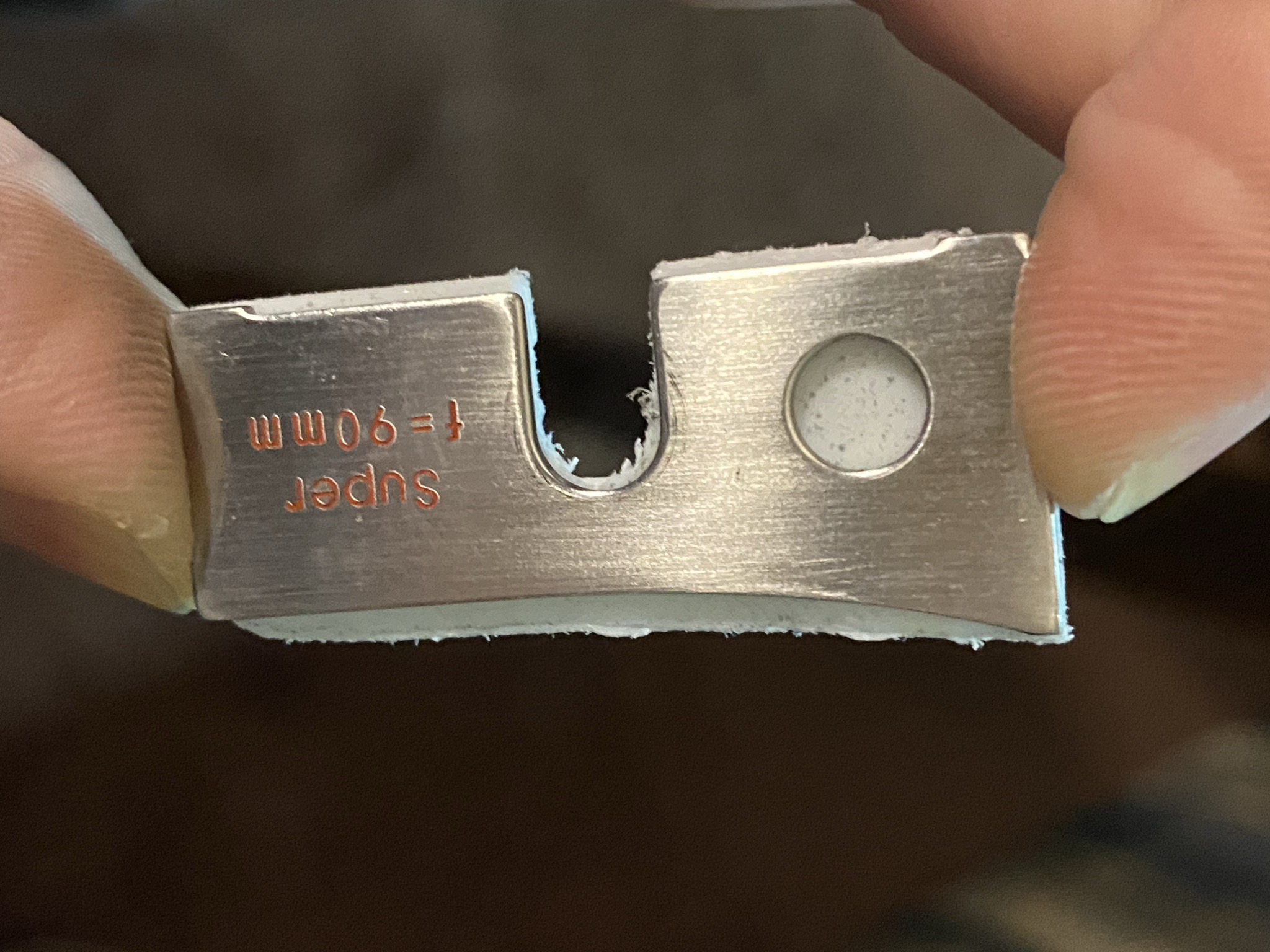

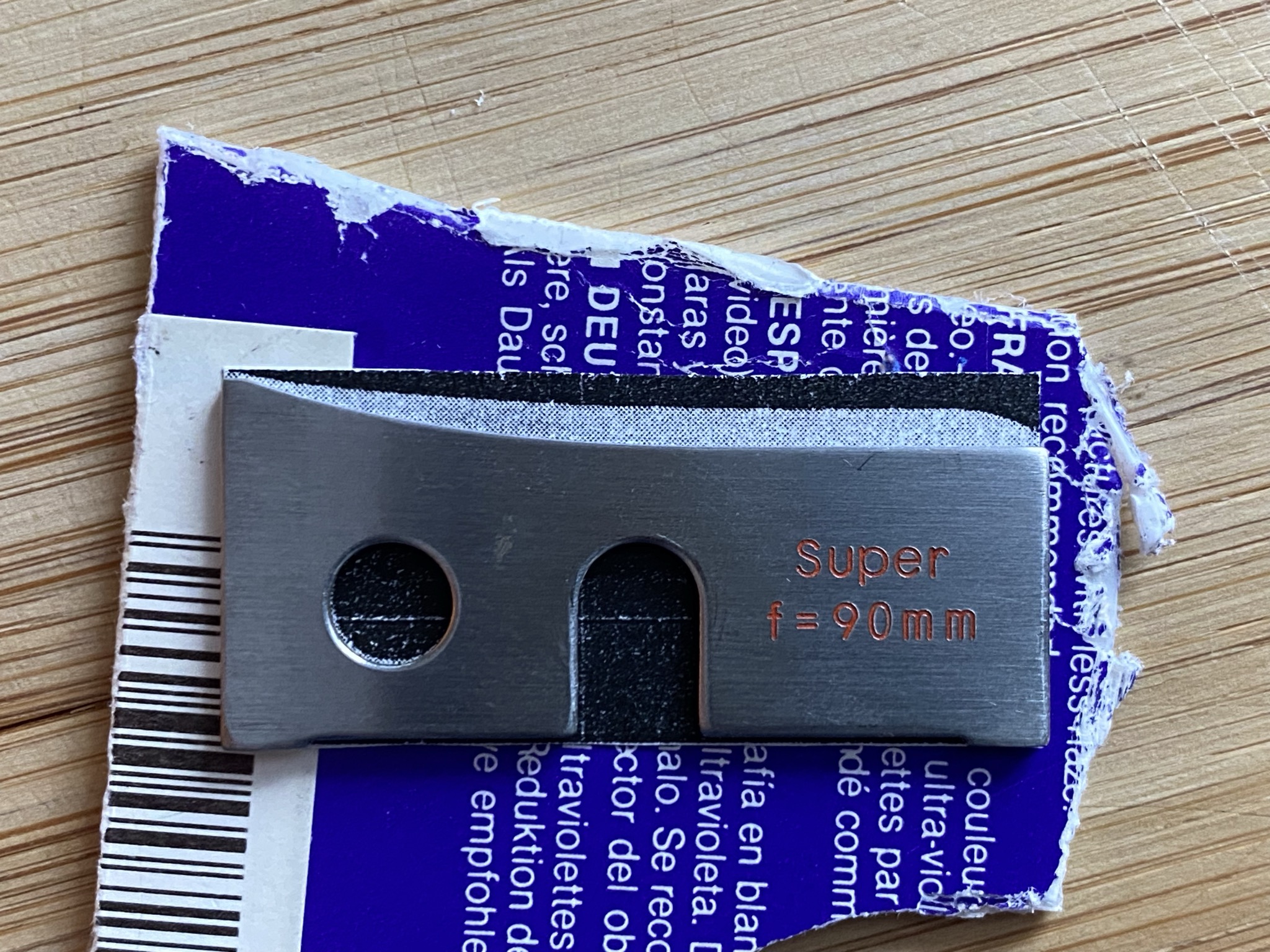

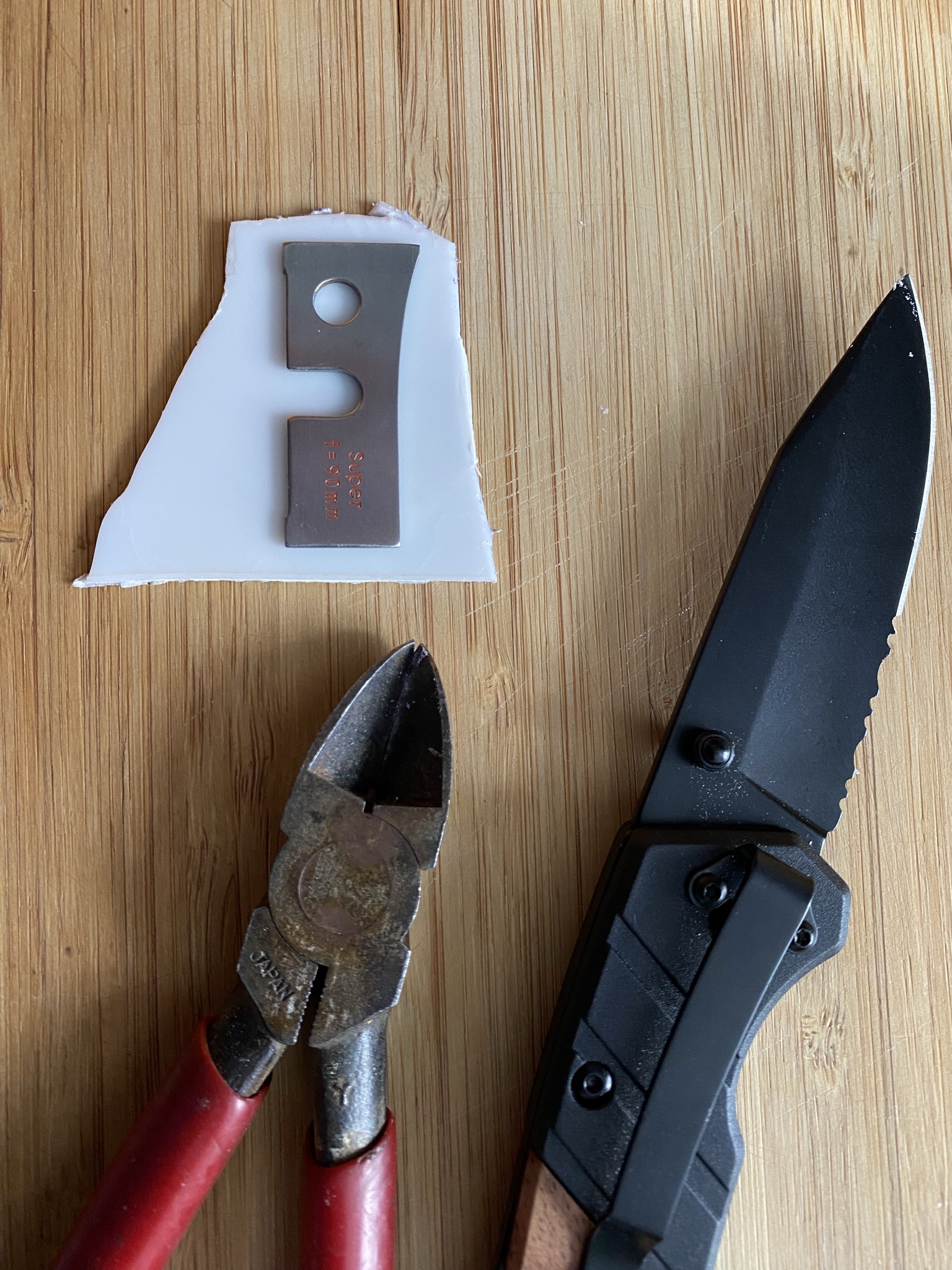

And here I am massacring a filter case in preparation. We'll see how it goes.
Well, that was 3 hours of painful knife work. Soon I'll figure out if it can do the job...

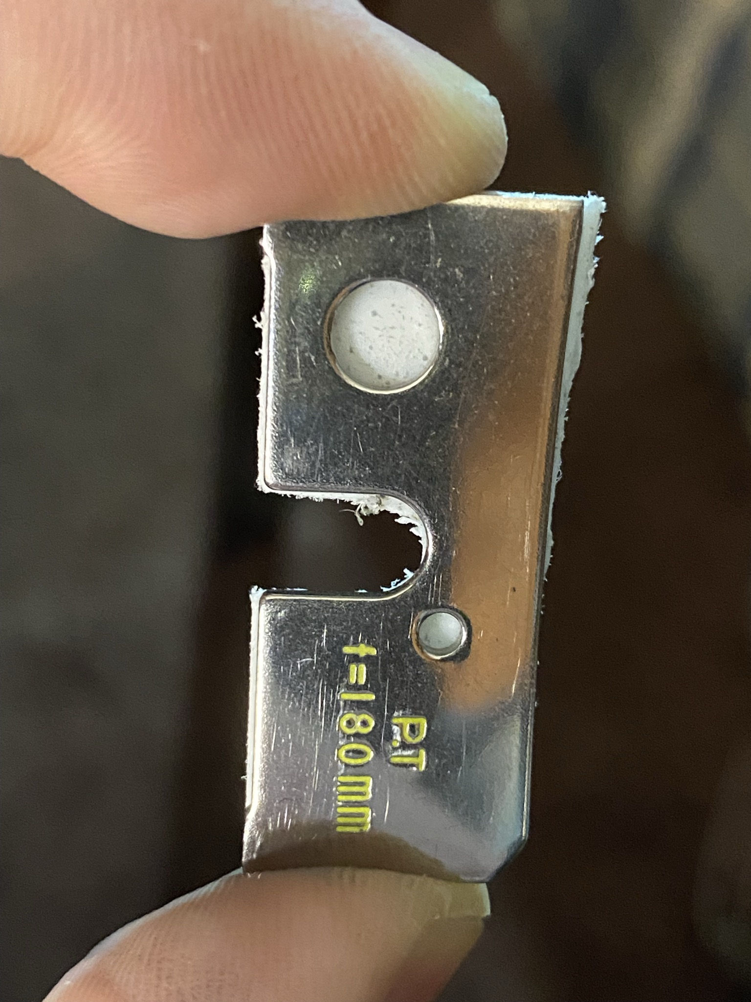

Results look encouraging! It focuses past infinity which means I didn't take too much material off. It fits in place and operates the rangefinder smoothly. Theoretically, all I need to do now is to sand it carefully to the exact curve...
If it doesn't work you can always say you hate those filter cases anyway. When you sand that use wet and dry 1000 grit and use it wet. It will take longer but it will be much smother.

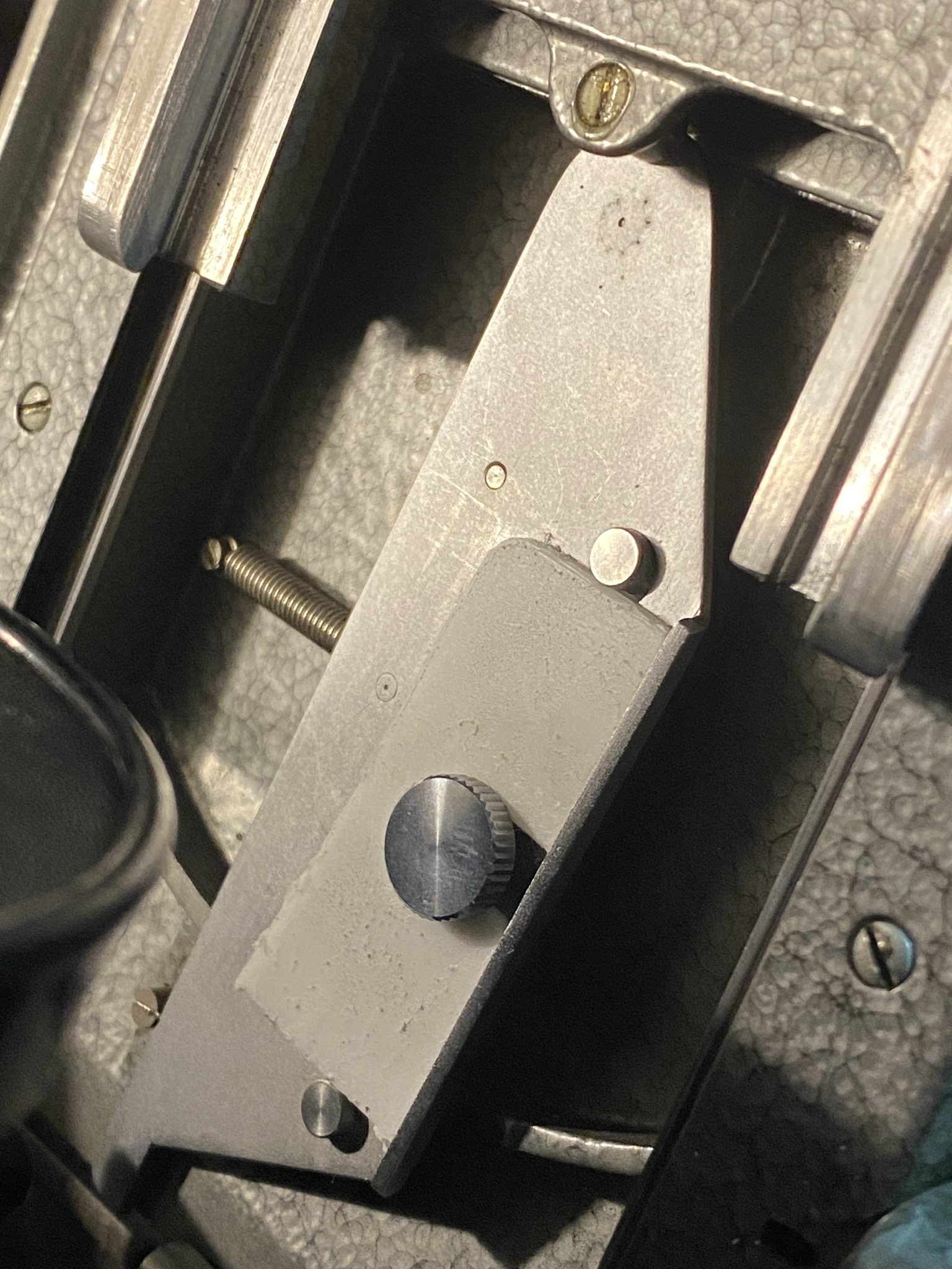

You might try aluminum. This latch for the ground glass back on my Horseman FA 4x5 camera broke. The original is steel but I made a duplicate out of aluminum with a Dremel and hand tools. Still working fine over ten years.
