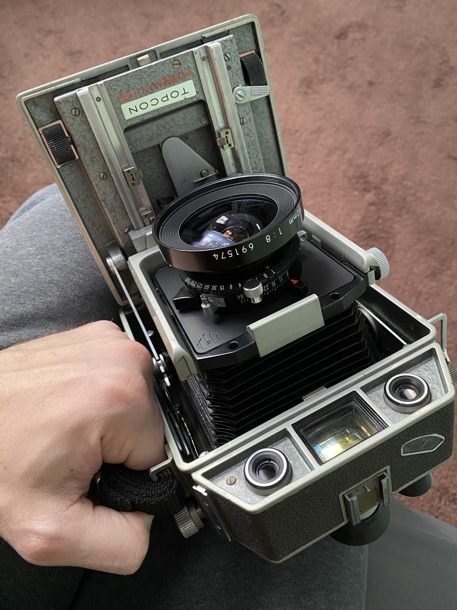

I was able to confirm that the 90mm horseman cam does accurately couple the rangefinder for the Nikkor 90mm SW f/8. Tried all rangefinder distances with a ground glass and loupe. Looks like it will be a nice lens for this! Although you can't close it up.

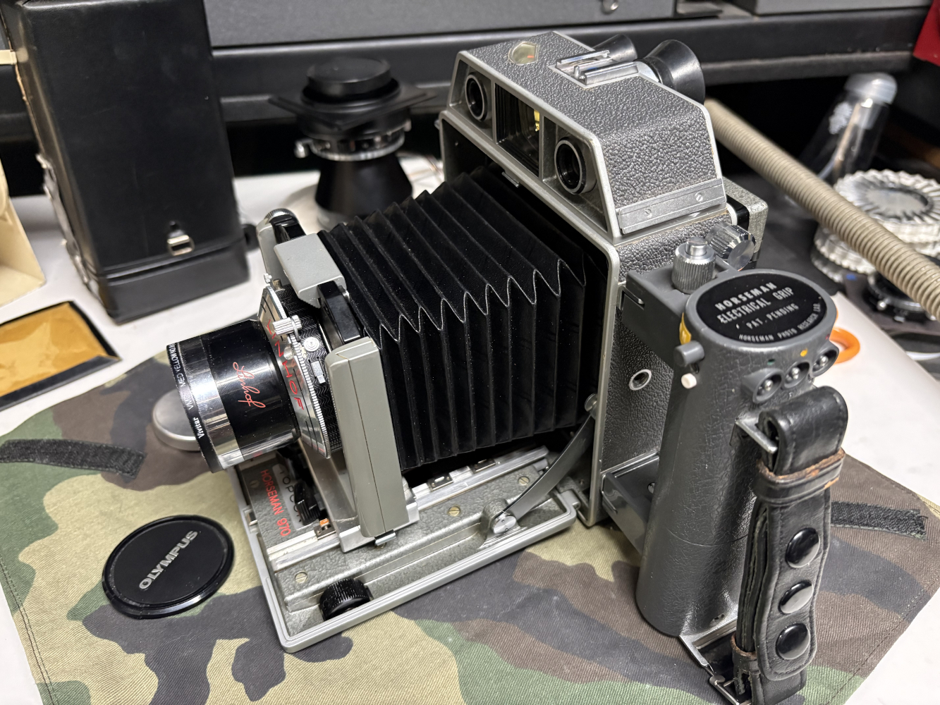

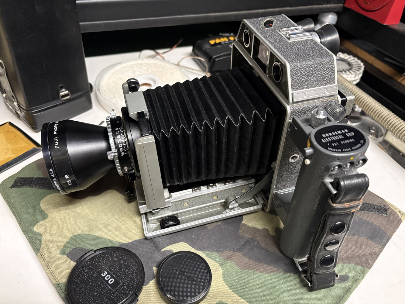

I thought I would share some camera p*rn. One is with the Fujinon-T 300mm and the other is with the Tele Xenar 240mm. The Tele Xenar is quite nice on the Horseman because of size 49mm filters and reasonable bellows draw and at 143mm IC it is good enough. On the other hand the Fujinon-T 300mm is at the limit of being still on the track. These were both at infinity. Normaly I use the rotary back attachment with the 300mm because it adds about 25mm of extension.

The grip is right or left handed and pretty easy to change. If you make a 5mm spacer between your glass and the camera you will be very close. I measured my film backs with film and it was real close to 5mm.
