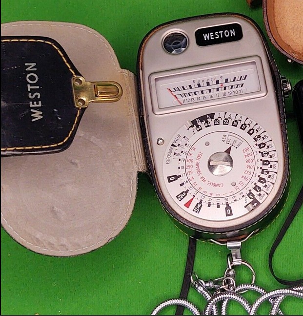

Just bought a Weston Ranger 9. A bit older than what everyone else is suggesting, but I figure even if it needs calibration, it should be a useful reflected/incident meter. Ansel Adams thought so! :wink:
Ranger 9 can still be serviced in a lab in LA, don't remember their name, but apparently they are THE light meter lab out there.

The Weston Ranger 9 has a 18 degree spot function and does incident and reflected; provided you don't lose that tiny Invercone adapter for incident.

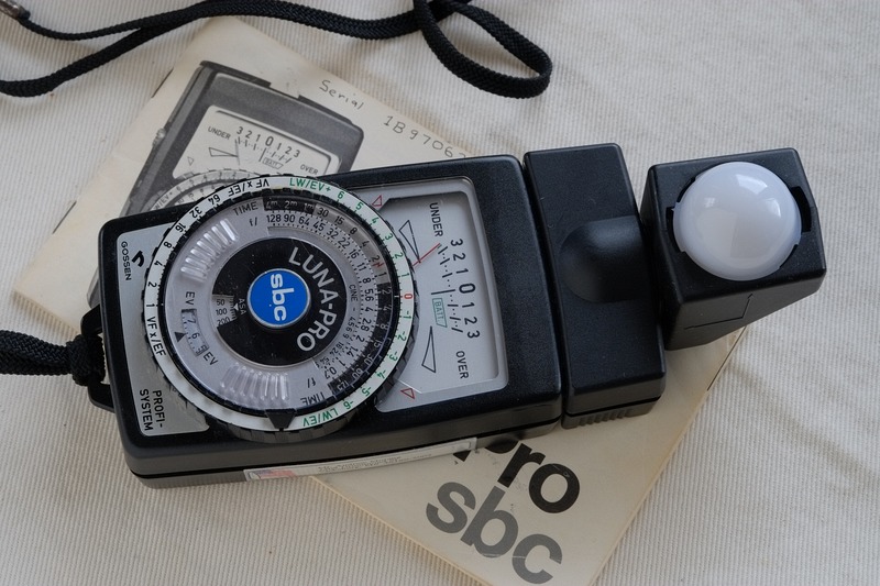

I think you are confusing the older Luna Pro with the Luna Pro SBC.
The older Luna Pro, which has a CdS cell not an SBC cell, uses the old mercury battery.
Both Luna Pro SBC and Luna Pro F take a 9v battery. They are virtually the same meter.
Here is the USA Luna Pro SBC with the rather bulky accessory big incident dome attached to the front. You can see the size and shape of the meter itself. This meter uses a 9-volt battery. The older Luna Pro measures via a CDS cell and requires the 1.35 mercury cells (except for a few late-production Luna-Pro S models). As I wrote before, The USA models of Luna Pro SBC and F use the same big rectangle casing.

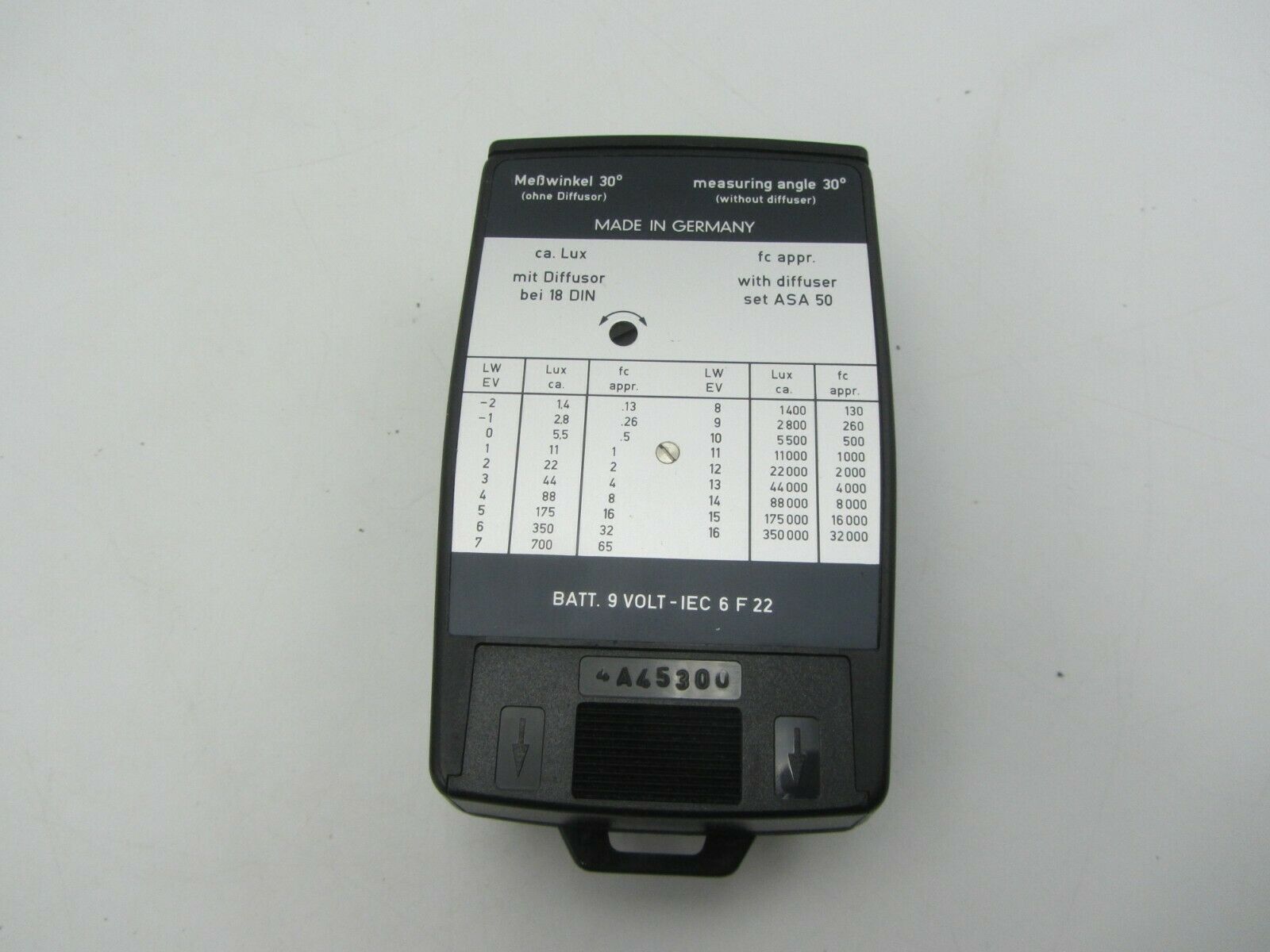

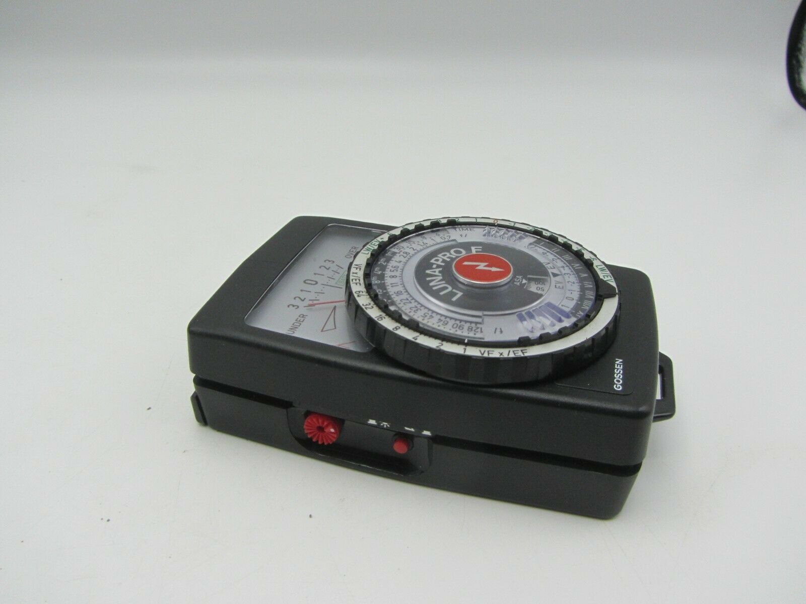

...and here are some photos of the nearly identical Luna Pro F
