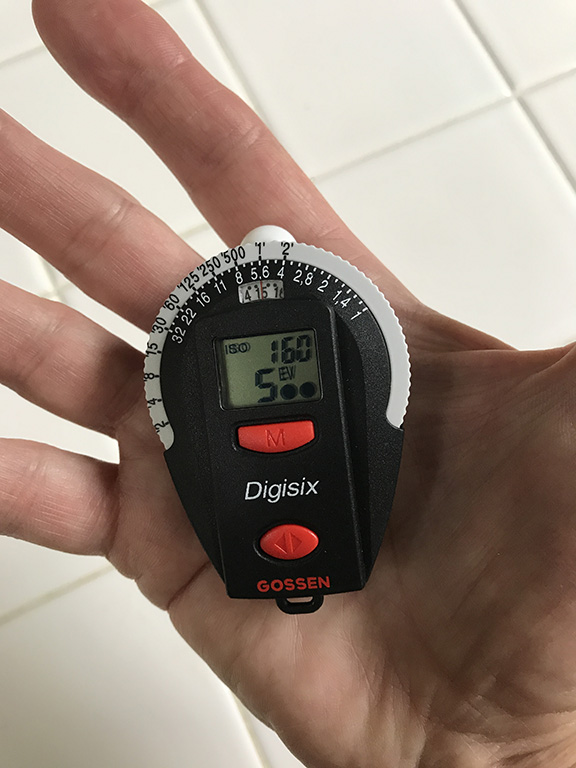

Gossen DigiSix. Small, makes reflected and incident readings.

The meter I have that is quite capable and compact is an original generation Gossen Digisix. It measures incident and reflected. It's one flaw seems to be disappointing battery life (a CR2032 lithium coin cell), disappointing enough I remove the battery unless I know it's going to be used the next day. The meter has a tripod thread socket on the bottom and Gossen offers an accessory shoe adapter foot but it's priced as though it's made out of pure unobtainium. The current units are identified as a Digisix II -- I've no idea if they are any better on battery appetite. Last I looked, they are a bit dear price-wise.

The meter I have that is quite capable and compact is an original generation Gossen Digisix. It measures incident and reflected. It's one flaw seems to be disappointing battery life (a CR2032 lithium coin cell), disappointing enough I remove the battery unless I know it's going to be used the next day. The meter has a tripod thread socket on the bottom and Gossen offers an accessory shoe adapter foot but it's priced as though it's made out of pure unobtainium....

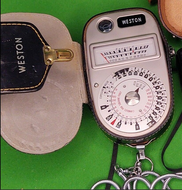

Just bought a Weston Ranger 9. A bit older than what everyone else is suggesting, but I figure even if it needs calibration, it should be a useful reflected/incident meter. Ansel Adams thought so! :wink:
