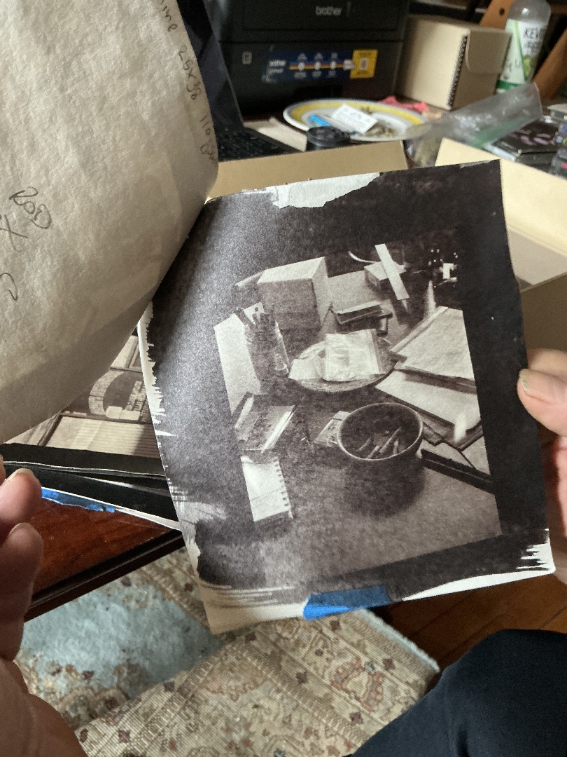

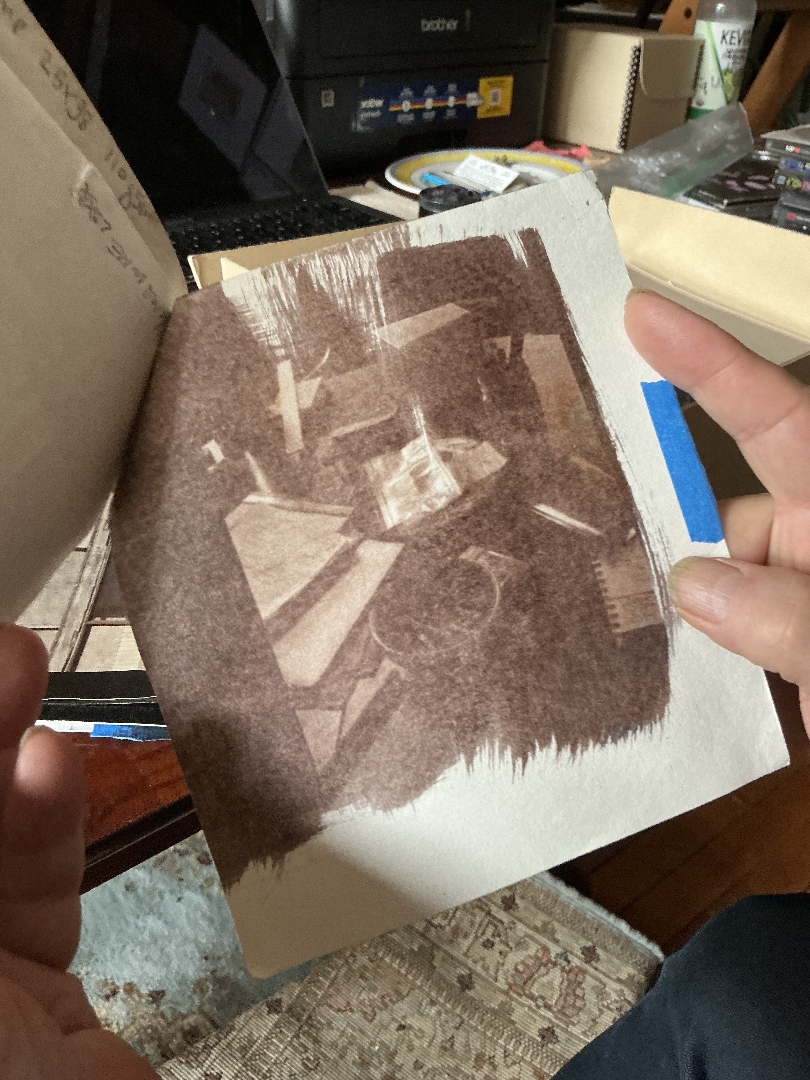

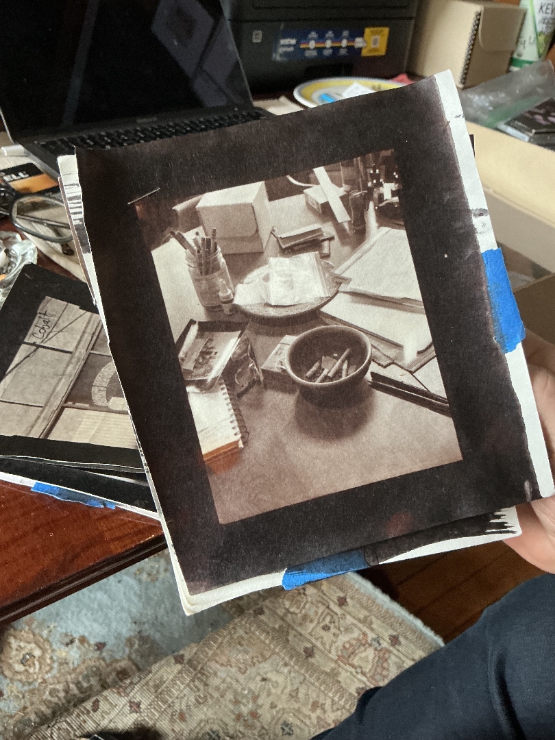

Three different versions on a japanese paper
Homemade pop emulsion
Rod coat 2x
Brush coat 2x
Brush coat 1x

Very nice!
Can you get smooth tones with brush coating? Or is rod coating always better in that respect?
The 2x brush coated print seems contrastier and more neutral in tone. Do you know why?

These are some of the variables you can instill while creating your own emuldion. Rod coating will always be sharper than brush but one can use these variables to your advantage.
Gloss depends on paper; watercolor vs. Baryta

Yes, print 1 and 2 have quite different looks. I can see why brush coating would be preferable for certain prints, and vice versa.
