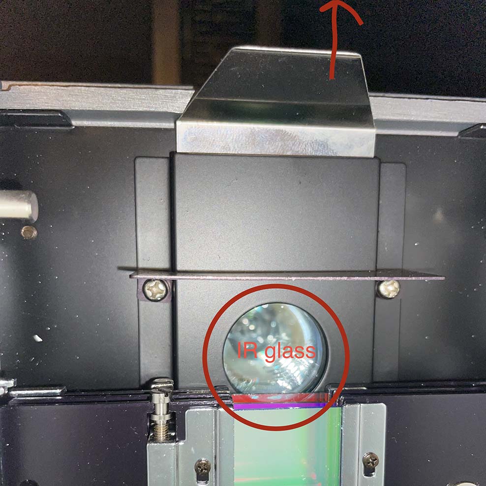

Pull out the silver holder and see if you have the IR filter in place, too.
Wrong. UV filter. Or a single combined glass coating might be involved. But the absence of that would only mean a tiny bit more overall blue. Modern colorheads remove most of the heat itself using a fan system.
And in this case, we're dealing with a small colorhead anyway. The dichroic coating on the bulbs themselves also helps.

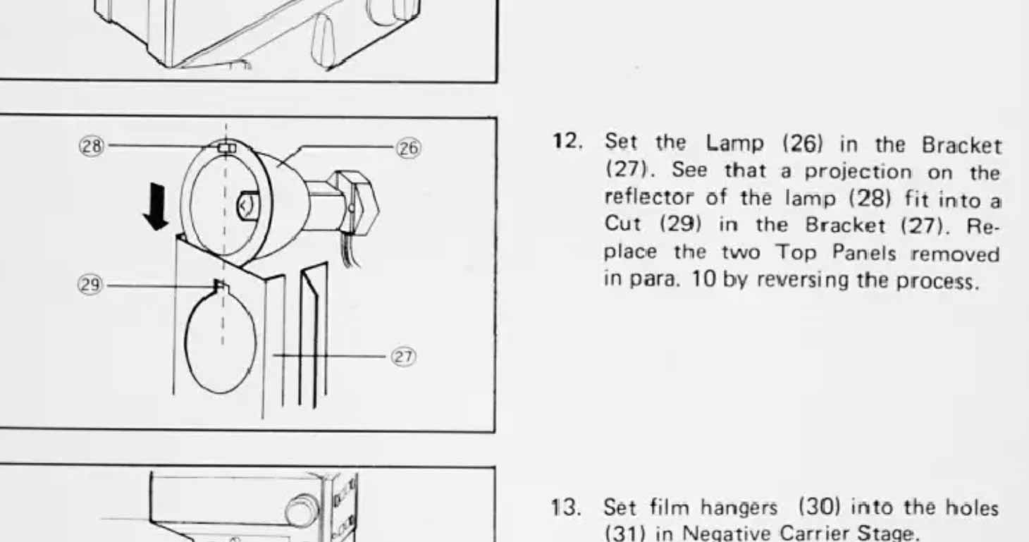

Possible solution found.
I noticed that a tiny notch at the top margin of the bulb was not fully seated in the bracket (as seen in the attached pic). Not at all obvious even on close visual inspection - only discovered when I attempted to switch out the bulb as a last resort. So I secured the bulb, and did 2 test strips: #1 with Y/M both set to 100, then #2 with Y/M maxed out. No gels, and C=0 for both test strips. Both showed a heavy cyan shift. I'm going to try making some more test strips tonight with more reasonable Y/M settings around 70/60, etc and see what that shows. If this solves the issue, then everything may have stemmed from only a slightly malpositioned bulb, possibly loose enough to allow some movement between prints, resulting in unpredictable results. But we'll see tonight.
Oh yeah, this is the UV glass. I have the same. Tried cleaning, etc.

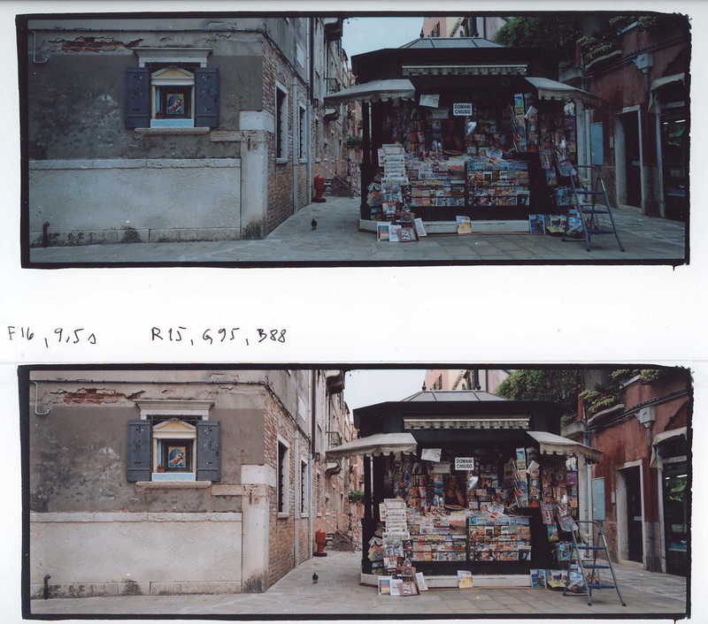

Top - no IR filter, bottom with IR filter. RGB filtration the same on both.
IR means heat per se. Where does any paper spectral chart show the sensitivity curve significantly extending into IR territory? What is posted above is more symptomatic of an excessive amount of UV coming through. But like I already noted, mixing box input filters can potentially contain both relevant coatings on the same piece of glass.
That's much more of an effect than I've seen before. Did you post the offset necessary to make the results match?
Unfortunately, I can't find the non-IR filtered print that matched the IR filtered one.
