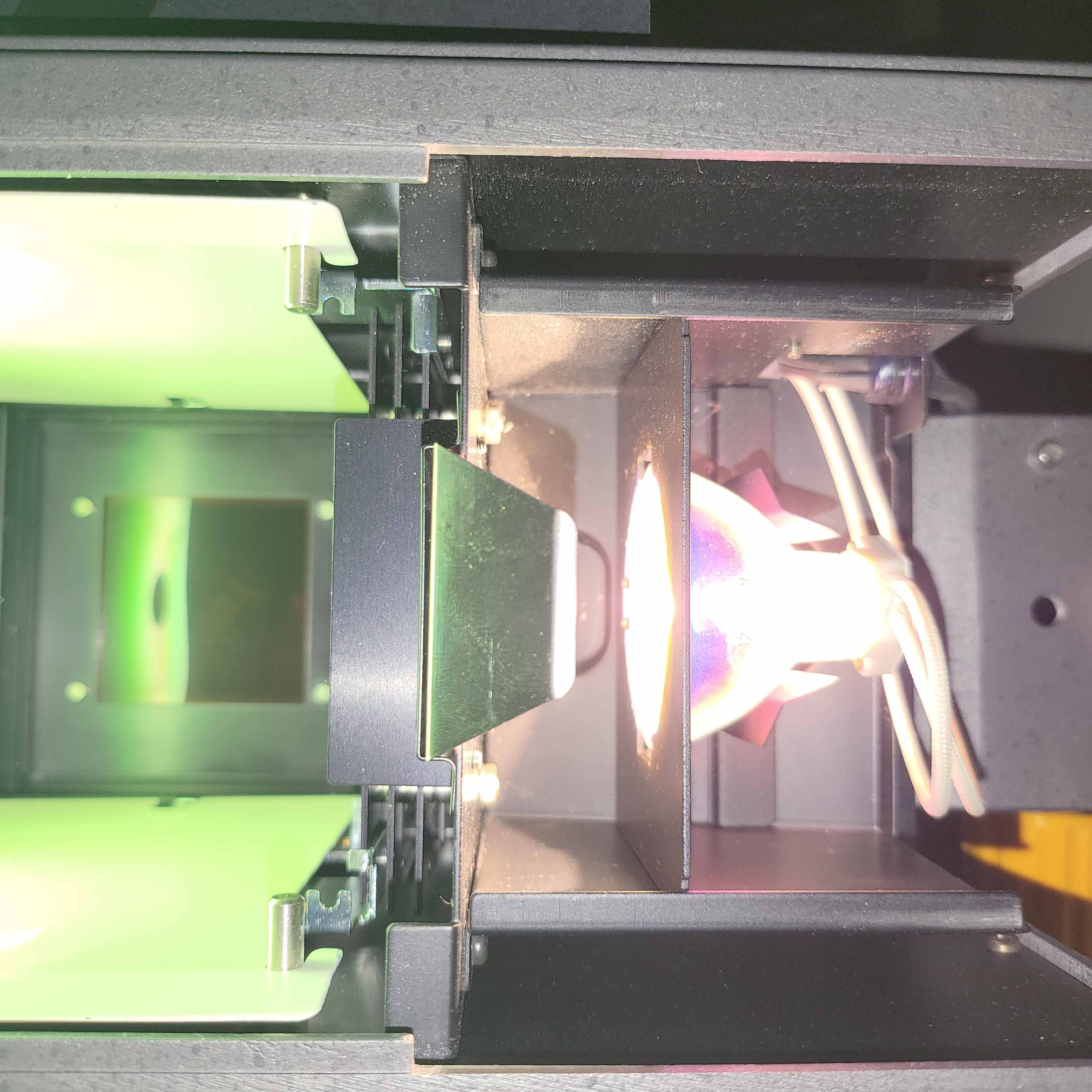

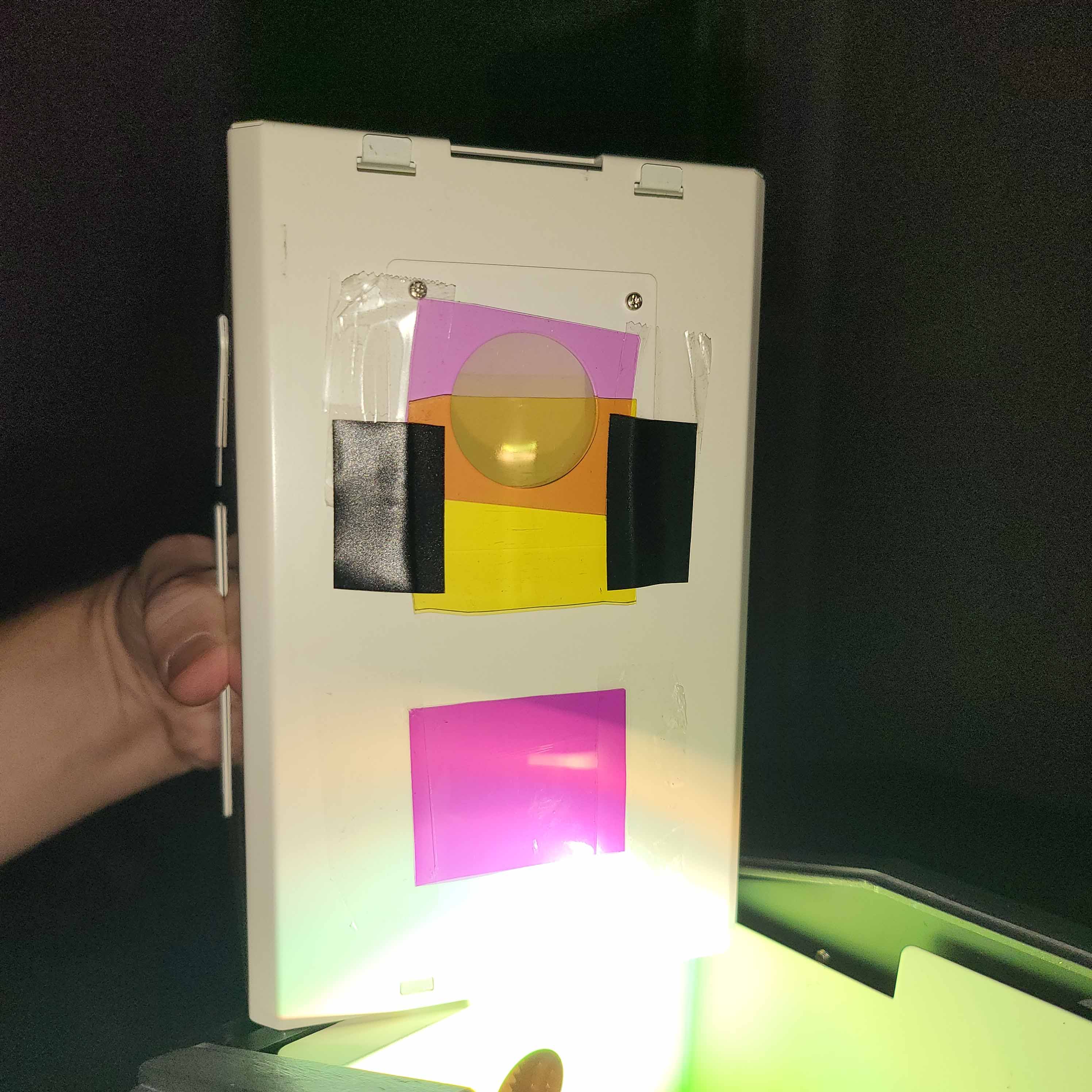

Enlarger is a Saunders/LPL 670 MLX (c7700MX), purchased essentially unused except as a floor model. Problem is that the native dichroic filters (even with M, Y set to max values) offer insufficient filtration, leaving a M, Y cast on the print.
My work around has been to tape color gels over the entry to the light mixer. Sometimes, even a whole gel isn't enough, and I may need a second. But at that point, unusual color shifts start to happen. It's frustrating, time consuming, and starting to deter me from the hobby I love.
Ultimately, I'm usually able to print most negatives, but some are impossible. I've followed advices from similar posts - opened the head to confirm all filters move properly; mixing box interior is pure white; no light leaking into the room and off the walls. Using fresh arista chemistry and Fuji CA paper. Cinestill C41.
Some remaining theories include:
1) light source: is it putting out an abnormal wavelength? It's 100W/20V. Should I bother trying to replace it?
2) light leaking around filters? They appear to filter most of the light.
3) some subtle specs on the filters. Could these be randomly deflecting light about?
4) Is it ever necessary to replace dichroic filters?
5) the cinestill c41 is questionable. But even lab processed color film still has this issue.
Thank you for your help. I'd hate to drop all this b/c of some elusive technical issue.

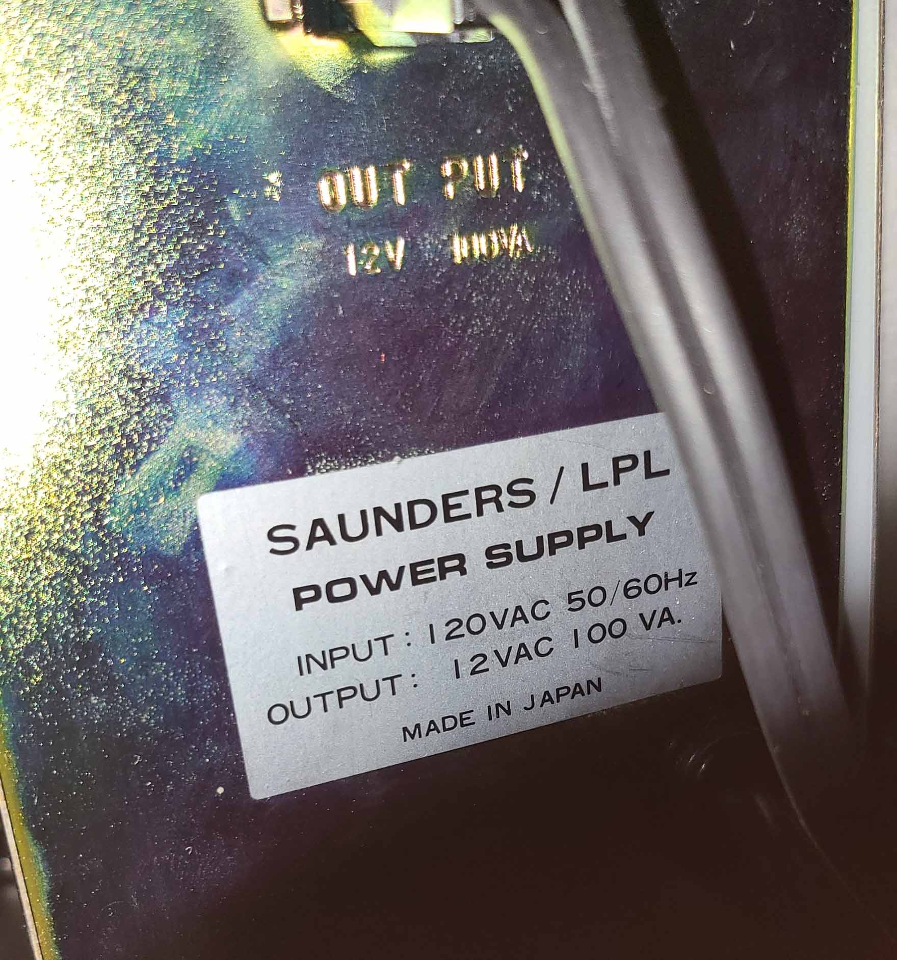

Welcome to Photrio - from an owner of both an LPL 7700MX Dichroic Enlarger and an LPL 7700 VCCE Dichroic Enlarger.
The correct bulb for both light sources is a 100W/12V bulb, not a 100W/20V bulb.
Are you using your enlarger with the LPL power supply designed for it?
Also, I don't understand what you mean by a M, Y cast. Normally, a combination of excess Magenta and yellow tields red.

Thank you for the comment. Apologies - it was a typo on the bulb. I also have 100W/12V. Yes, I'm using the original power brick (back shown).

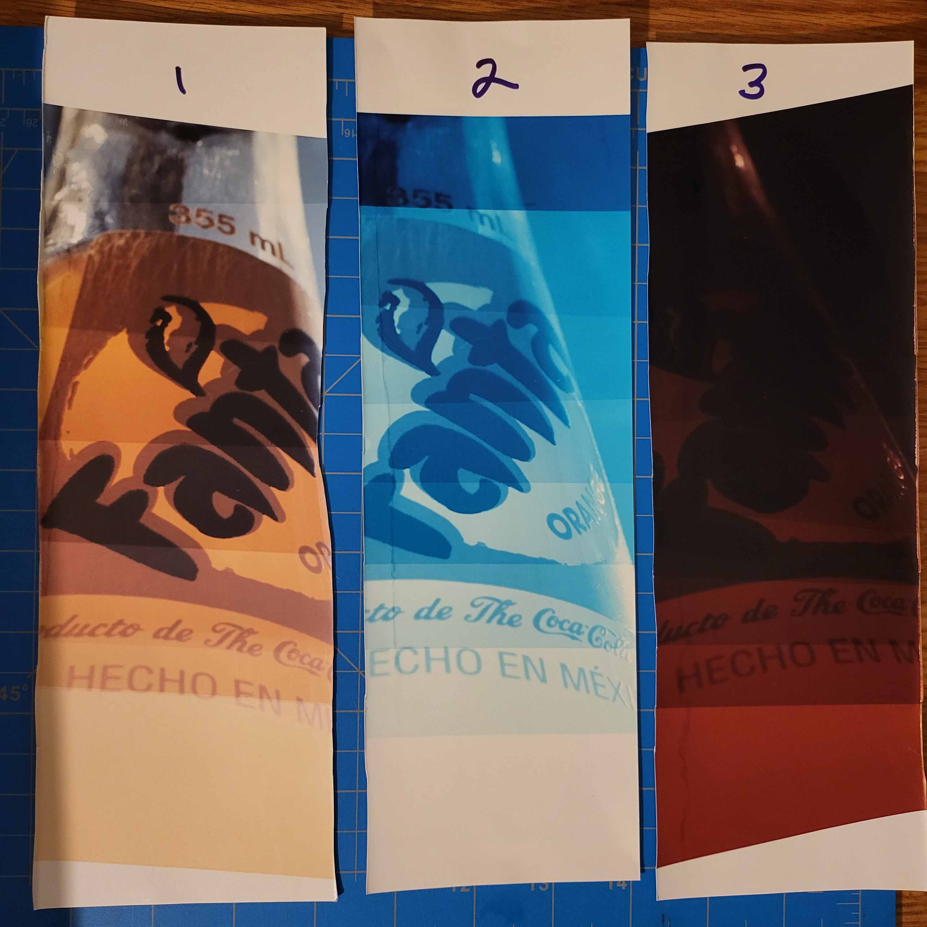

Cast: so when I make a print w/ M around 40ish, there is a huge M cast to the print. If I print w/ M maxed out at 170, there is still a mild M cast. Similar w/ yellow although I have sometimes gotten a barely decent print w/ Y maxed at 200.
I will make some test strips using these 2 settings and post.

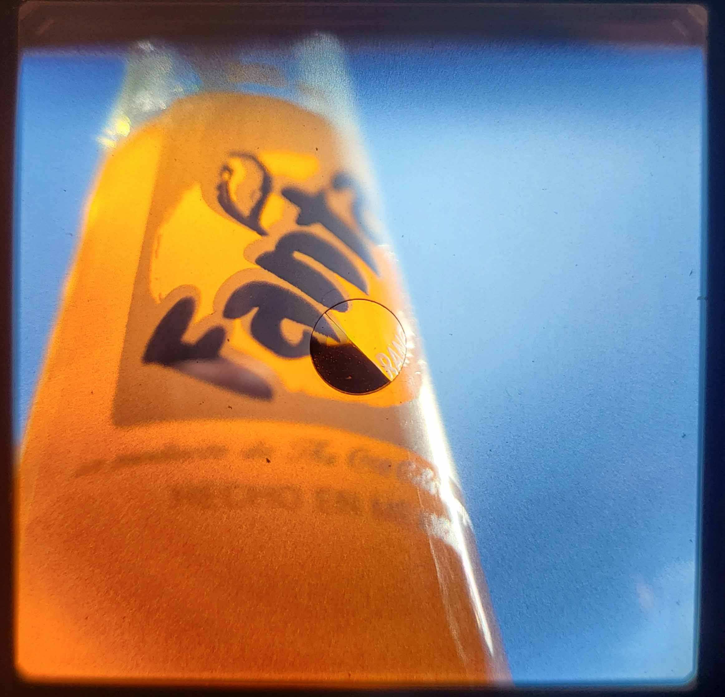

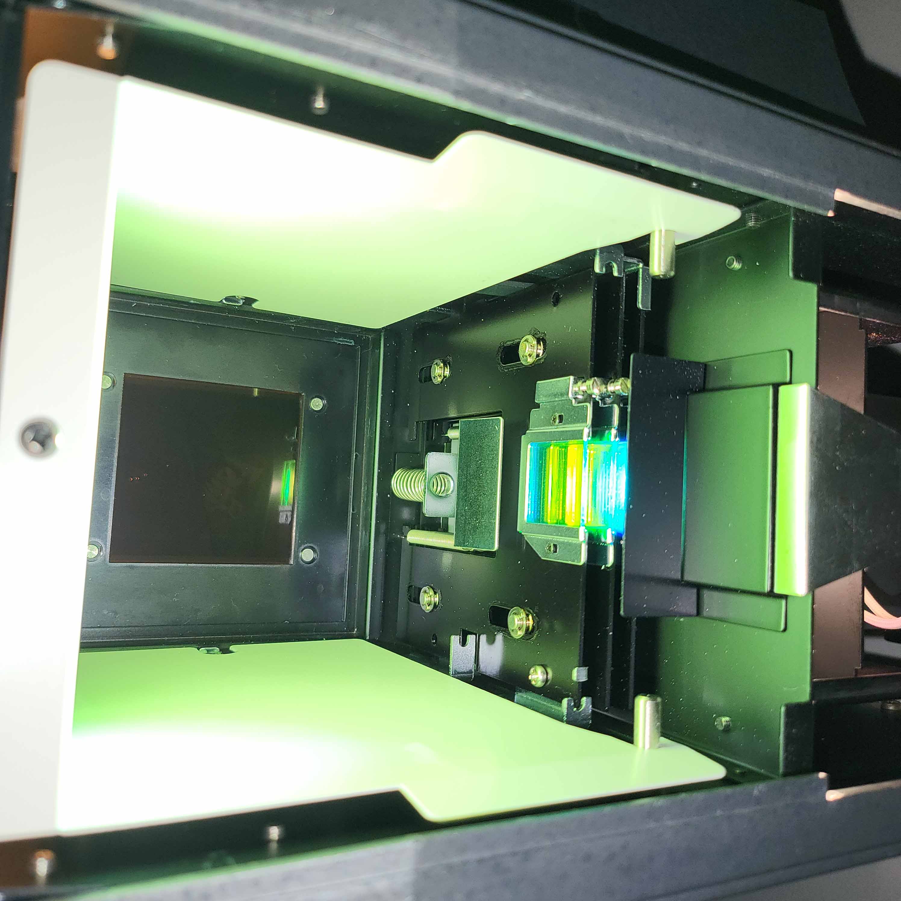

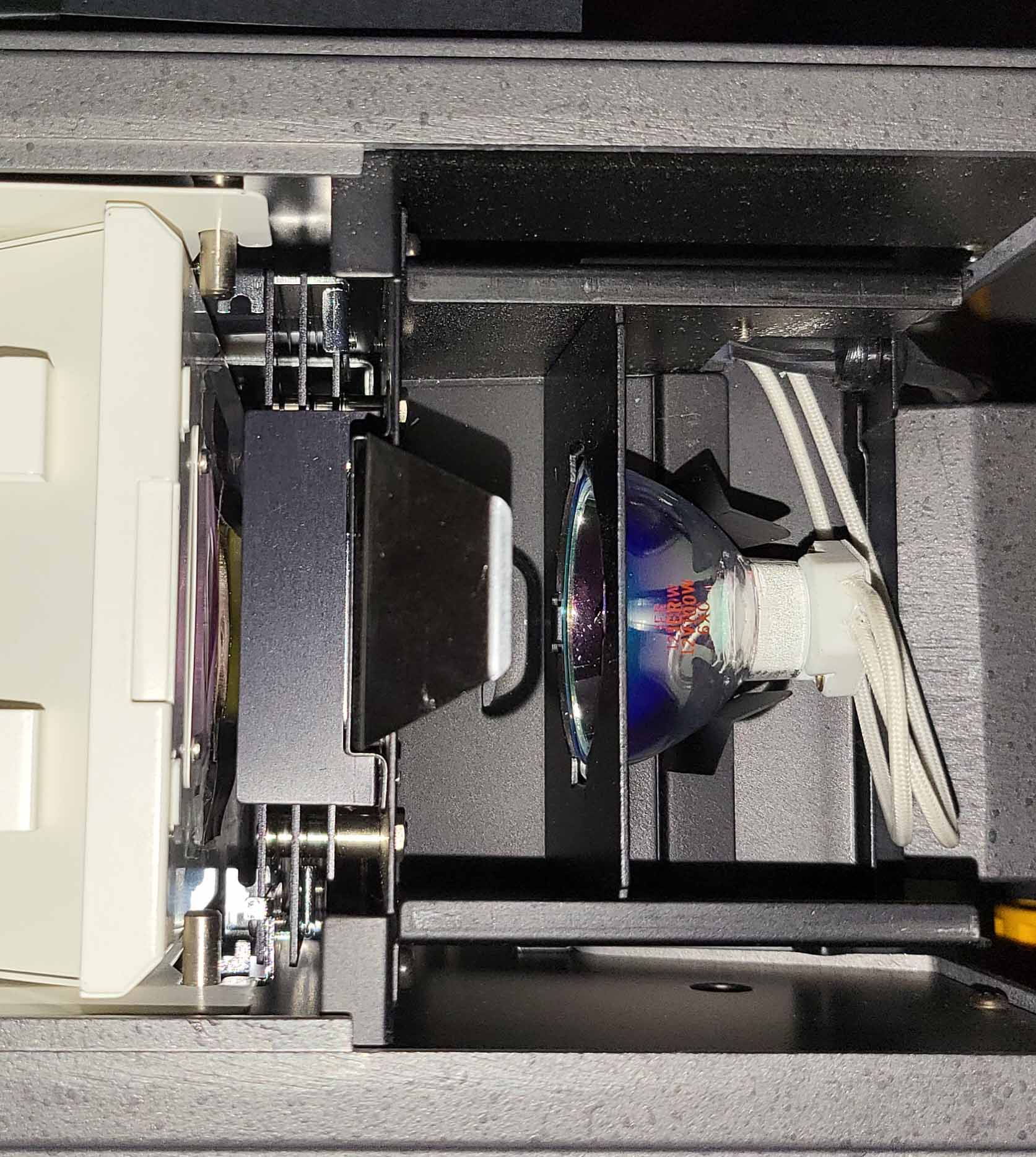

With the color head open and bulb on, I am able to see a very obvious and (apparently) appropriate color change when adjusting the filter dials. Could it be the fuji paper?

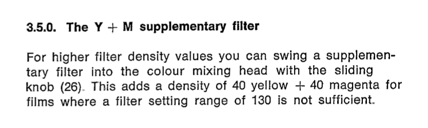

The last generation of Durst enlargers included a supplemental RED filter for such cases. In your case, a similar RED filter somewhere in the light path would be of benefit.

I typically use portra or ektar.
I would expect no such problems with these films, especially if the mode of development apparently doesn't make a difference.

The last generation of Durst enlargers included a supplemental RED filter for such cases. In your case, a similar RED filter somewhere in the light path would be of benefit.View attachment 321886
Yes but isn't the key question: why should the OP need M at max? Is there any reason why max m + supplement should ever be needed except in very exceptional circumstances. The OP seems to have a M cast throughout
Very, very interesting. Perhaps it would be marginally easier using a red filter rather than both M, and Y. I wonder how often the red filter was required.

Also, how does the mixing chamber look: Is there any significant discoloration?
AFAIK, dichroic filters do not fade. Mine developed cracks in the glass, but this didn't seem to affect their performance.
What about Cyan; when Y and M are maxed, where is C typically set? Wondering if this is too high and not moving as it should when you adjust the enlarger's controls.
Cyan is always kept at 0, and I've confirmed everything moves properly when I adjust the dials. Mixing chamber is clean white inside.

There should be absolutely no need for supplementary gel filters. Besides the troubleshooting hints in above posts, it's possible your film exposure or development itself is way out of whack.
$1000.00 (U.S.) to the first responder who can solve this problem. This is not a joke. If you can't solve this, I'm getting a new enlarger. Seriously, I'll venmo you within 24 hours.
Test strip settings are as follows:
1) M = 170 (max), Y = 200 (max), C = 0. PLUS: 10M gel and 1/2 of a 10 Y gel (see pic) taped to the mixing box entry aparture.
2) Exactly as above, but with the M, and Y filter settings decreased to M = 160, and Y = 190. Gels unchanged. Not kidding.
3) Gels removed. M = 30, Y = 40. Like a "normal" color head would use.
The 3rd pic is a cell image through the viewfinder.
If you suggest this might have something to do with the negative, or power source to the bulb, or light leak in the room, you are disqualified.
I've literally wasted 100's of hours, ?# sheets of paper, money, energy, etc on this God awful Saunders/LPL 670 MXL.
