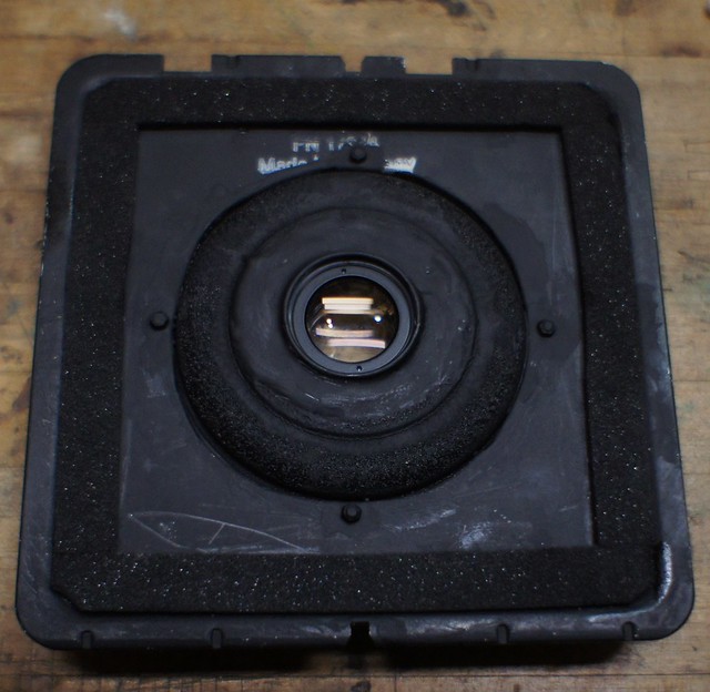

I built this custom Makiflex board a while ago, adding a recessed Durst enlarger plate, to slightly recess my 150mm F9 Apo Ronar. This is an absolutely teeny gem of a lens!
I decided to move my lens to a Sinar Norma board, so I have it handy to use on my Sinar Norma copy stand.
A couple of years ago another 150mm F9 Apo Ronar came along, for like $30 but with no retaining ring. I searched high and low but no luck, this is a very tiny rather rare ring.
So last week I mixed up some JB Weld metal epoxy, and neatly glued the Apo Ronar to the Durst recessed part of the board. Finished with flat black paint and it is ready to use on my Makiflexes. Looks pretty good, eh? :smile:

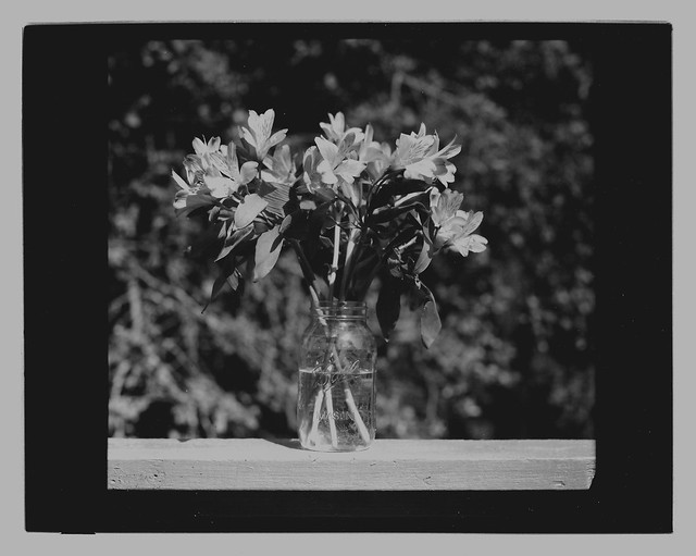

159mm F2 B&L Super Cinephor Test by Nokton48, on Flickr
Plaubel Makiflex Standard, Bausch & Lomb 159mm F2 Theatrical Cinema Projection Lens, Ilford Commercial Ortho 4x5, Graphmatic 4x5 sheet back. Mic-X developer. 8x10 Arista #2 RC paper, Multigrade dev Omega Dii 180mm black Rodenstock Rodagon, Omegalite circuline head
I focused on the front of the petal in the bottom center; depth of field is as thin as a sheet of paper.

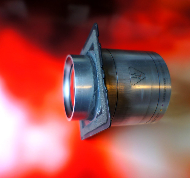

B&L 159.1mm F2 Super Cinephor 1 by Nokton48, on Flickr
Removed from a movie theatre projector (in it's former life) the Bausch & Lomb 159.2mm F2.0 Super Cinephor. Carrying this around will give you a cardio workout. Will focus out to twenty feet (but not further) due to the SLR mirror in the Makiflex Standard.
The rear cell of this beast completely fills the Makiflex Standard Mirror Box when full in. Anything out to twenty feet or so is fine. This is a tricky one to focus.

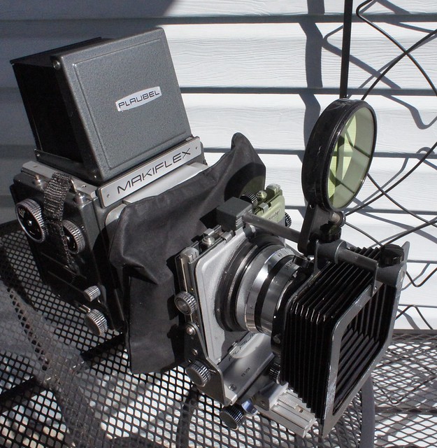

I want to highly recommend the original Linhof Rollex 6x9 Back on the Makiflex. The knobs and the tactile "feeling" of using the equipment combined create a smooth and closely matching sense. And a total "brick house" approach which fits well on the Makiflexes. So I picked up three backs, some extra parts as well. I would like to pick up some 6x6 same Rollex backs but so far none have appeared. Several of the backs needed some work but now all is well.

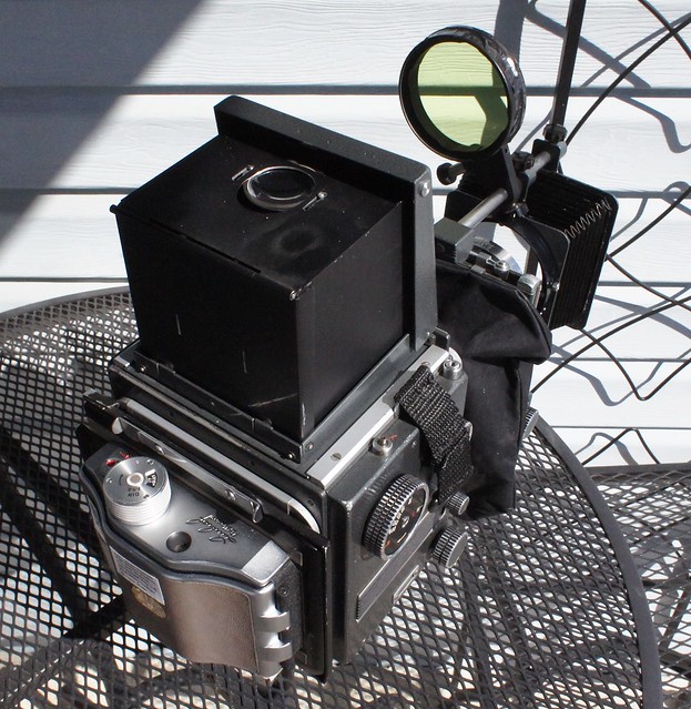

Here is the completed Pecoflex Adapter Back for the Makiflexes. I custom made the bag bellows using one from the Peco Jr View Camera, a lot of brass modeling screws and nuts, Pliobond Cement, and a lot of time spent figuring exactly how best to do it.
Essentially this a Peco Jr Front with bag bellows on an Automatic Makiflex. Extreme movements beyond what is necessary in a lightweight package (could be handheld!) are possible. But I use a tripod with this Beast.
Going through my box of Plaubel Odds and Ends, I found this Peco Jr Filter Holder, which fits the Compendium Hood/Connecting Rod. I have only one Yellow Green Filter which Is from Russia, I have used teflon tape to attach it to the Filter Holder. So something new and useful for the upcoming SPRING shooting sessions around here
