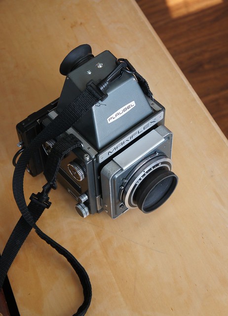

Plaubel Makiflex Standard.

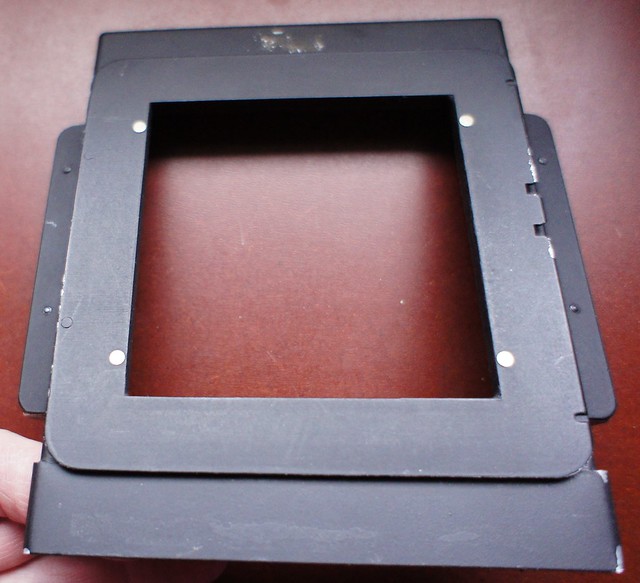

Today I am tuning up the Makiflex to Pecoflex Adapter, on Makiflex Auto Body #2. Getting ready to take this out.
I've put together a kit of mostly Xenars to fully utilize the cameras. The shortest usuable seems to be about 210mm, so that one, plus the 240mm Xenar, and the 360mm Tele-Xenar. All original Plaubel Makiflex Auto stuff.
This rig is fun to use. There are plenty of camera movements in the front, and it's intuitive to use. Need a tripod.
Will be shooting 9x9cm B&W on 9x12cm format film.
^^ The 210mm Auto Makiflex Xenar focused at infinity. Still plenty of room for full tilting, and a large amount of front rise if needed.

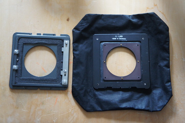

Peco Jr Bag Bellows converted to Pecoflex by Nokton48, on Flickr
Years ago I bought this Peco Jr Bag Bellows for $40 from a local dealer. Always figured I would find something to do with it. Yesterday I started to convert it to fit the Makiflex to Pecoflex Adapter. By removing the smallish front frame (glued to the front of the bag), and orienting it sideways (45 degree turn), it can be used with Makiflex, by using the adapter to the left.
I drilled out the rivits holding the front frame, turned the front plate 45 degrees, and reattached the front of the bag, using micro brass modeling screws. VOILA! Something useful at last.
Needs final assembly and gluing. This is an item I have not seen in the Makiflex catalogs I have. Useful with shorter lenses on the Maki to Pecoflex Adapter.
Maki to Pecoflex Adapter New Bag Bellows by Nokton48, on Flickr
The Bag Bellows for the Maki to Pecoflex Adapter is ready to use now. Final assembly will have to wait, as I wait for more contact cement and #1 and #2 Brass Hobby Model Screws to arrive.
Shown with Recessed Peco Jr Lensboard (which fits Maki Adapter, and decreases bellows extension) YAY!!) and Durst 180mm F5.6 Schneider Componon, lens (shown) focused at Infinity. Plenty of room now for extreme camera movements, Thanks to Bag Bellows. The camera repair Guru Ken Ruth got me started using Componons as taking lenses. Dirt cheap fine Plasmat type derivatives. I have the entire set.
So now this THING is really like a 1960s version of a Fuji GX680.

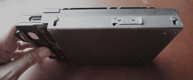

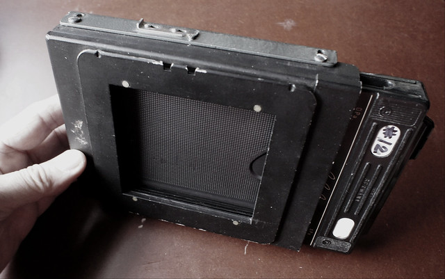

9x12 cm Linhof Makiflex Holder 1 by Nokton48, on Flickr

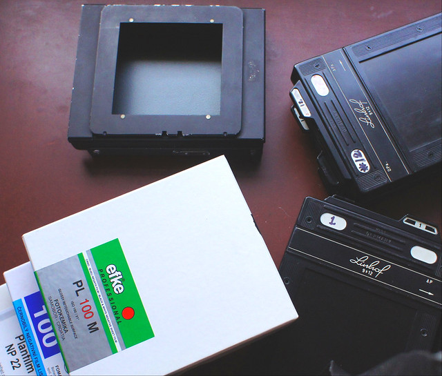

Last week I came back upon my Makiflex Sheet Film Back. This has some interest here I know so I thought I would show you how it works. I'm getting ready to load three kinds of 9x12 cm sheet film. Efke PL100, Fomapan 100, and Orwo NP22.
This holder also fits 4x5" Graphic Graflex and Linhof Holders. Very versatile.

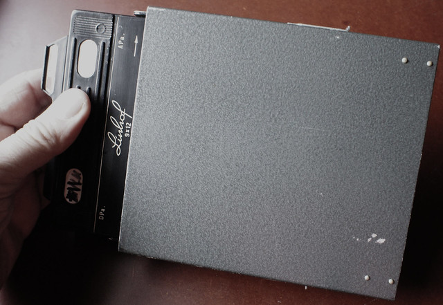

9x12 cm Linhof Makiflex Holder 2 by Nokton48, on Flickr
Here's the Linhof 9x12 back inserted into the Makiflex Sheet Holder. Note the back is fully extended to fit the thicker Linhof holders. You can see the built-in pressure plate when darkslide is removed, some claim sharper results with Linhof PP holders
9x12 cm Linhof Makiflex Holder 4 by Nokton48, on Flickr
Here's a close up of the adjustable lever (in the center) which allows you to go from Linhof, then also, to the thinner Graflex Graphic holders, with a flip of the switch. Spring loaded mechanism and the holders fit very tightly.
This holder puts a 9x9cm image onto 9x12cm sheet film. The rounded corners are just a bonus.
You can also do the same thing with 4x5" Graphic or Linhof holders (both kinds thick and thin)

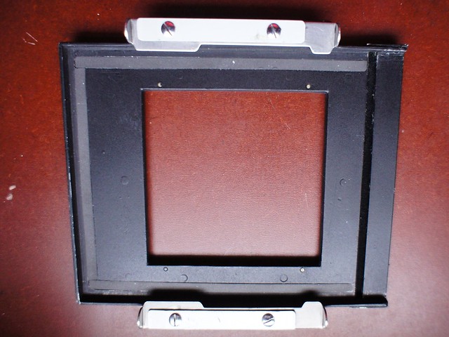

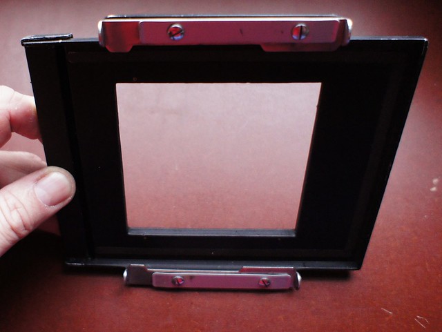

Graflock Back Makiflex Adapter 1 by Nokton48, on Flickr
This is my 4x5 Graphic Graflock Plaubel Makiflex Back. This was in the middle of a bunch of Plaubel Stuff in Germany.
97328 Adapter Back- MX 1/539 $67.00
Accepts following
holders:
1) Linhof Rollex
2 1/4" x 3 1/4"
2) Linhof Cine Rollex
56mm x 72mm
3) Linhof Super Rollex
56mm x 72mm
4) Graphic Roll Holder
2 1/4" x 3 1/4"
5) Polaroid Sheet Film
Holder 4x5"

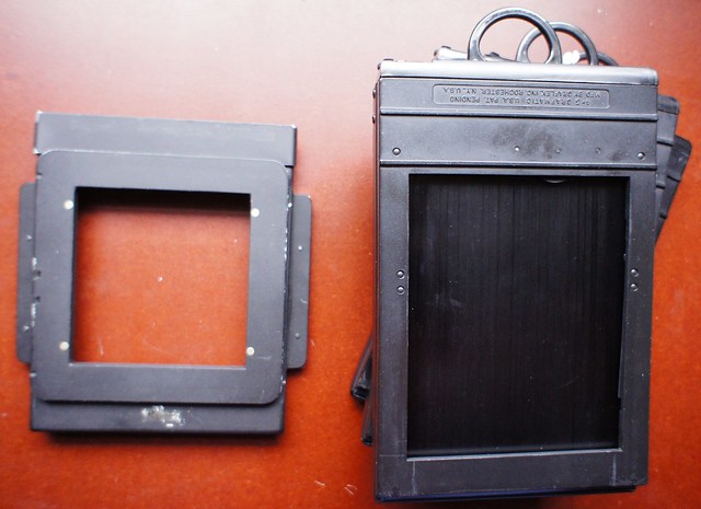

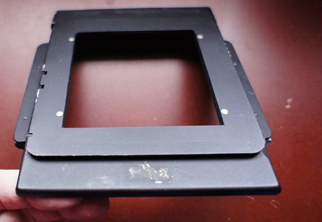

I have been thinking about how much I have enjoyed using my 4x5 Graphic Graphmatic Back with my Sinar Normas. Precise to use, lightweight compared to Riteways or Liscos, Rapid Firepower in a small package. So I -finally- found my Graphmatic down in the studio, and decided to gift myself two more, for XMAS.
With this new stuff^^ I can rack off eighteen 9x9cm exposures, as fast as I can wind, and cycle the holders. Should be as speedy as one can be with a Makiflex :smile:

seems a pretty rare item. thanks God i have the Graflok one (MX 1/539)

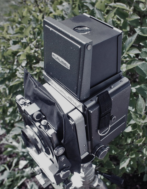

Automatic Makiflex Auto 150 Symmar Graphmatic Porro by Nokton48, on Flickr
I renovated the Porro Finder, note the two screws holding the interior mirror, which I have beefed up. The rubber eyecup is actually a lenshood I bought just for this purpose. Works perfectly.
With the Porro Finder the image is upside down, which I am used to. I enjoy this as a compositional aid. With the Graphmatic and auto iris lens I can shoot six rapid fire shots as fast as I can work the mechanisms.
