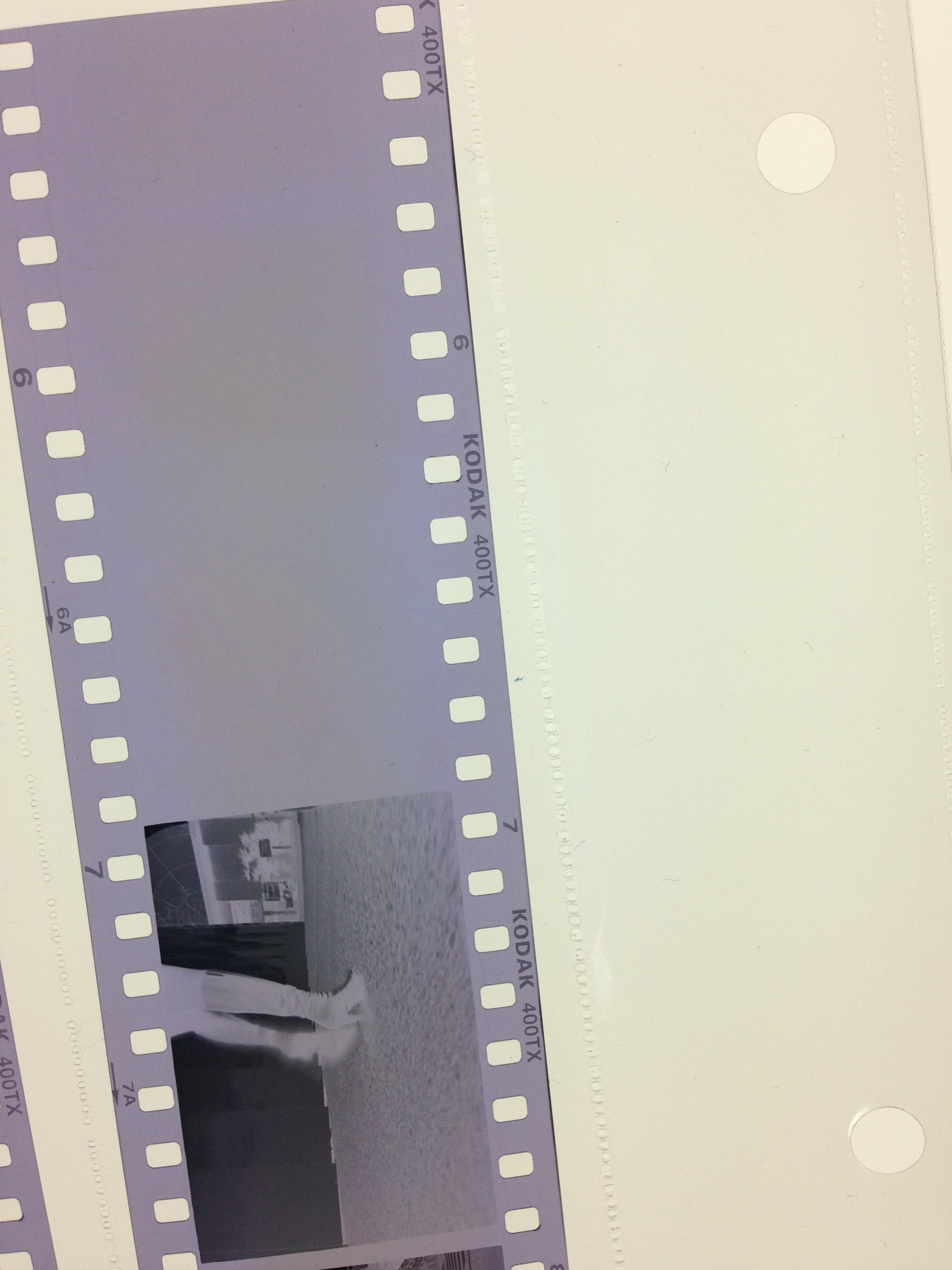

The stain also seems to fade unevenly with time. Two year old Tri-x.

It's probably best to limit the wet time for film to a minimum. The magenta stain is not going to harm anything.
I - like Eric - just soak the films. Only with Kodak I have this purple stain and while I didn't care in the beginning (and have a lot of purple negatives) I started soaking the films for 20-30 minutes after the Ilford wash (5-10-20-40 inversions and a fresh water change in between).
The result is always a perfectly clear roll of film. I am happy with this result, especially that it doesn't waste extra water.

I discussed this with a former EK engineer and one of the inventors of the layered dye technique which seems to be the culprit here. It was not a problem at one time, so if it is one now and getting worse, I suggest that there be a conversation between customers and Kodak. But, there appears to be a solution such as the long wash Ben mentions above and others I have heard such as soaking in Sodium Sulfite solution.

It may be worth noting that my problem was completely resolved by switching to two-bath fixing. No extended wash times, no additional clearing step, just 2 bath fix and then straight into a wash.
Interestingly, the 1st fix bath comes out barely tinted pink while the second fix bath comes out electric neon Barbie pink. I've never seen something like this before where the majority of the chemical to be removed "washes" out in the 2nd bath. I also find it interesting that the pink color in the fixer vanishes by the time I use the fixer again a few days later.
The dye is rapily destroyed by sulfite and oxygen both. It can be oxidized and reduced depending on conditions.

That is very interesting indeed. I use fresh fixer dilution pretty much every time, but only one fixer bath of 5-6 minutes.
I haven't noticed that removing the dye. I'll see if a two batch approach makes a difference. Would be nice to cut down on the soaking and washing time.
This problem was happening occasionally with Pan F. I just developed a roll the other day that had a slight pinkish cast. Since we had an overcast day yesterday I taped the archival sheet to the window. After about 8 hours of indirect light compounded by filtering thru a fairly heavy overcast, there was little change. Then the sun broke thru with some dappled light and was at an angle to directly hit the film. In about five minutes the pink was completely gone.
Another roll was developed several weeks ago and has just been sitting on the table. I checked it and it has cleared, as well.

I haven't gone through the whole thread, not having been on APUG for a long time but I stopped having magenta stain problems with a 10 minutes running water wash rather than using the old 'ILFORD' method of a process of exchanges.

Quite. I noticed it recently with Tri-X developed in DD-X mostly because my usual dev of choice Rodinal seems to get rid of it. I did a little test just like others where I left some film on the window sill for a day and that was enough to remove the pink stain even given our recent lack of sunshine for about the last 4 months.
