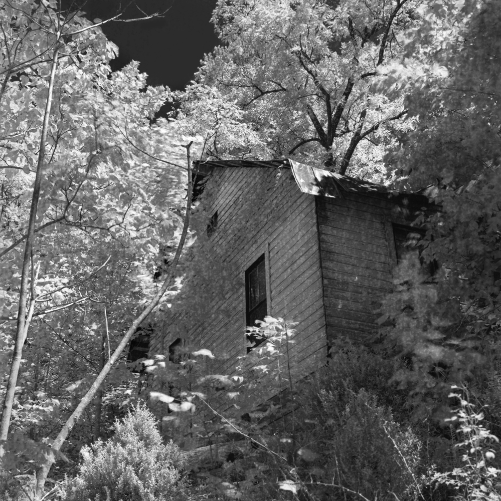

Well, the reason I asked about foam in the Photo-flo (Post # 51 above) is that I usually stir the photo-flo tank before immersing the film reel in it. It's worked for me for 40 years so when I got out a roll of film with nasty mottling in it, I wondered if that final step may have been the culprit.
The scan below shows the effect in the siding of the house. (I photoshopped it out of the sky area.) It's on Rollei infrared film, which I've been using for years.
If you've seen anything like this from any cause, I'd be interested in the story.

That’s 120 backing paper mottling. No fault in processing or drying.
