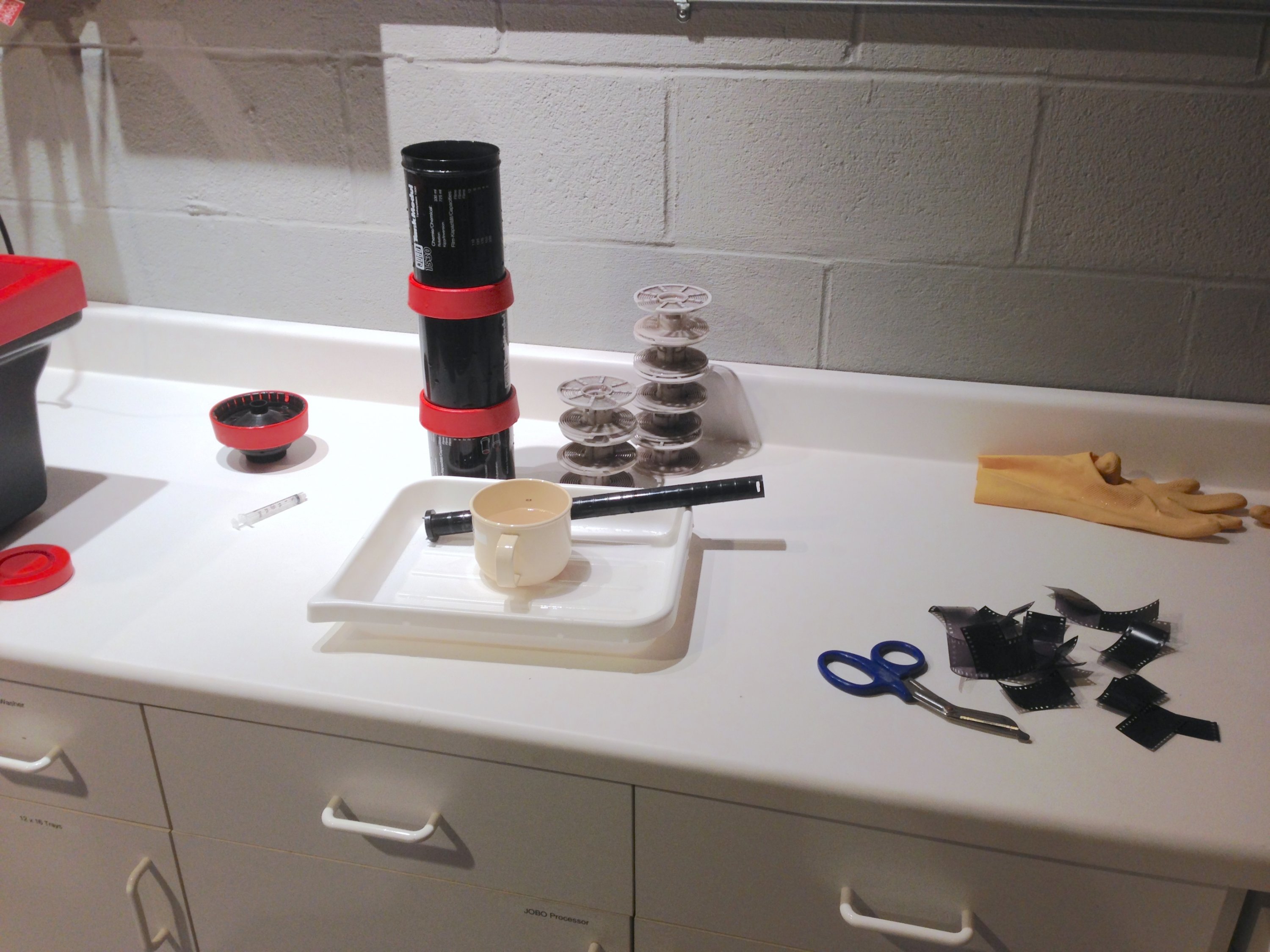

For 30 years I have held washed 35mm film by clips at the ends and dipped in PhotoFlo. Start with one end in the photoflo and scroll it through and back again (2 passes) and hang to dry. Works every time.
View attachment 227692 View attachment 227693

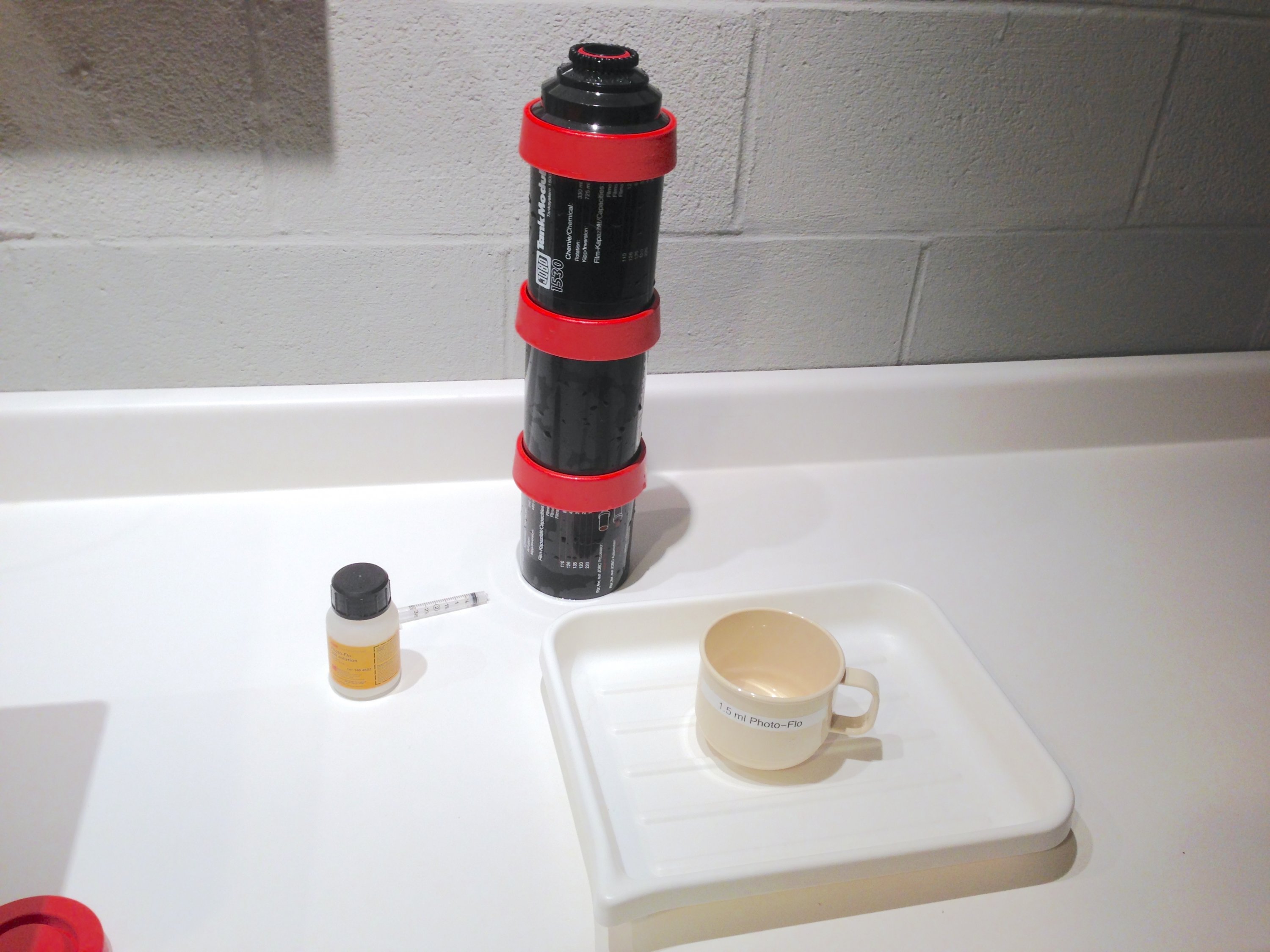

What's your solution mix? This sounds like a good idea. Cup says 1.5ml, into how many ml of water?

200:1 which comes out to 1000ml [1 liter] to 5ml PhotoFlo. This worked for me in the Los Angeles area and the Washington DC area water.
