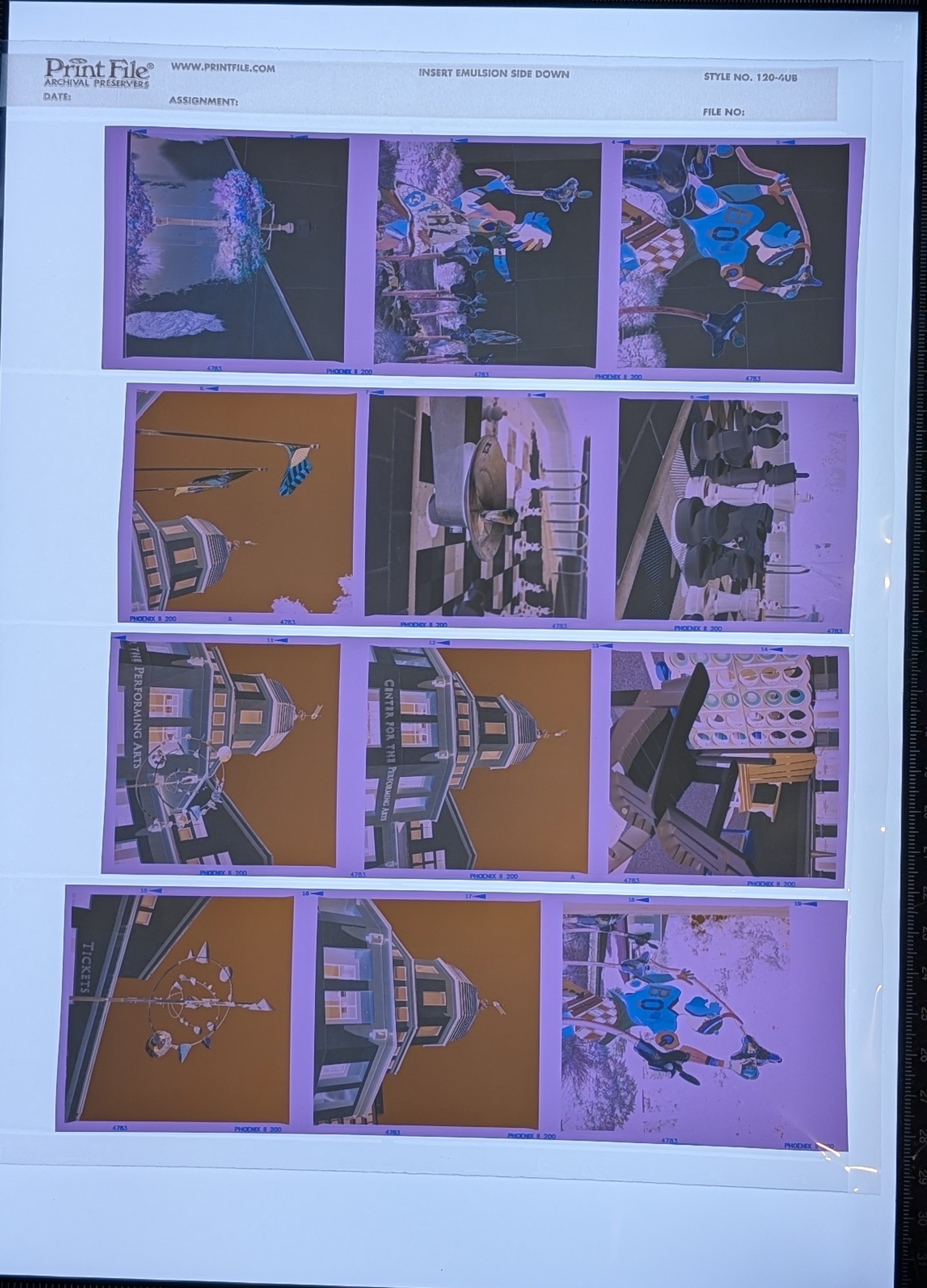

This graph is absent from the official Phoenix II datasheet, but the formatting is consistent with Harman / Ilford's style. Unless I'm very wrong, this indicates that Phoenix II has a serious magenta/green crossover problem.
Not just that; red and blue also part ways. Of course, we don't know for sure if this chart is official. If it is, it doesn't really surprise me since this is still a halfway-house product. The partial masking situation @Lachlan Young has commented on extensively probably explains this pretty well.

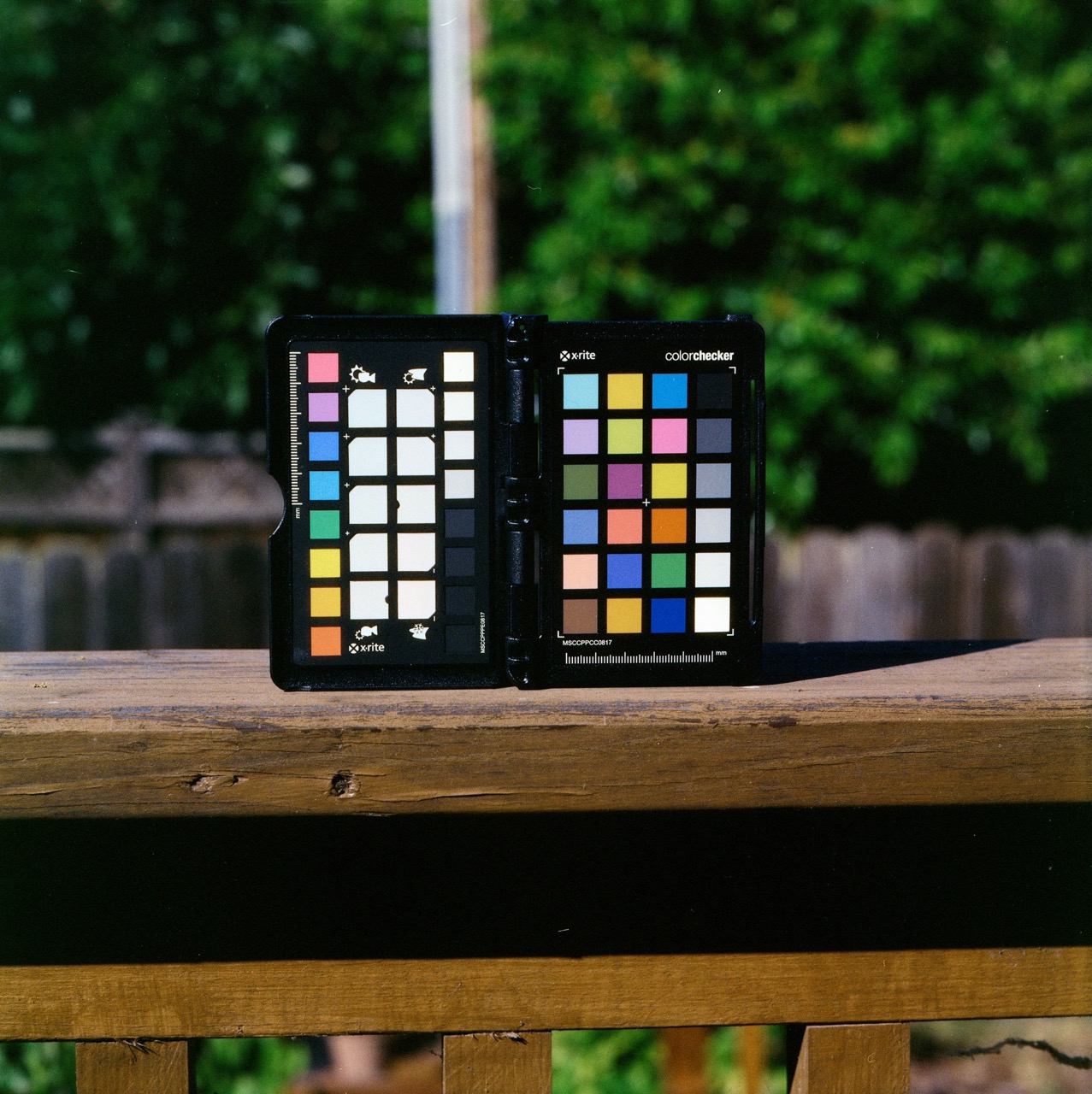

Okay, I have shot, and made my first RA4 prints out of Phoenix II. First impression is that the film is still quite contrasty, although noy to the level Phoenix I was. It needed almost maximum yellow filtration of my enlarger, and quite a lot of magenta, It seems to have an issue with magenta dyr, as you can see from the color chatt. The picture above is the original color chary, and below is an RA4 priny og the same chart, shot on Phoenix II, and printed in my darkroom to Fuji DP II paper. Second picture is the historical presidential palace in Kaunas, above on Potta 160, and below Phoenix II. Third file is St. Gertrude's church in Kaunas, on the left on portra 160, and on the right on Phoenix II..

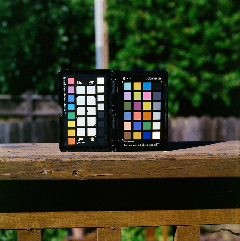

And my color checker using my usual process: Kodak C41 kit home processing, Epson V700 scanned as slide, Negative Labs Pro conversion natural. The red is more like orange. Blue and green are slightly different from Phoenix I as well. Contrast is still quite high, grain is a bit smaller.
Oh, not even close! This is far more muted than I had imagined it to be. In a way, it's a pity - the interesting thing about the first version was its through-the-roof contrast which could be used to bring out dramatic textures from very muted scenes. It looks like PII is more like a regular C41 film, just with...well, very muted and idiosyncratic colors. Your color checker shows that it really struggles with primaries. Lots of work ahead for the guys in Mobberley.
the base is still a bit purple.
Going off the purported curve shapes, and the colours of masking couplers (and those used for colour correction) as shown in the structural diagram in Shanebrook's 'Making Kodak Film' 2nd Ed., p.22-23, that's what it should be.
It also gives an idea of what other couplers etc still need to be added and where they'll start to shove curves into their correct relationships and gradients (which will sort out contrast and colour reproduction). What may look weird now is a lot more logical than it seems.
