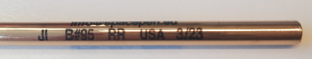

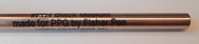

I received my Fisher Space Pen and it writes on wet paper quite well; the backside of both FB and RC paper seem to take the ink easily. However...wet emulsion, no luck whatsoever. It just dents the surface; no ink flow at all.
These are the markings on the filling in mine:
Sounded a bit too good to be true - and apparently, it is.
I tried it on Fomatone MG FB paper, Fomaspeed RC and Fuji DPII color. Behavior is the same; the pen dents the wet emulsion and picks up little flakes of emulsion, but puts down no ink. On dry emulsion, no problem, but I can write on a dry emulsion with many pens/markers...

Hmm, I wonder if it is because you have a new pen and the roller ball is a bit on the stiff side.
I'm on the road at the moment, but will investigate by trying a brand new refill unit (still in the bubble wrapped packaging) when I get back home.
I've used my current pen, refill that is, for around 5 years, so it has seen a bit of use. I know that they tend to deposit a little bit of extra ink when you are starting as they get older and exude ink more readily. If you look at some of my markings you'll see splotches of ink at the start of my writing, which cleared up almost instantly.
I use (almost exclusively) Ilford MG RC paper, so that is my main experience. I have also used Kentmere RC paper, but I cannot remember if I've written on the emulsion side. I certainly know I've written on the rear underwater in a washing tray, but not the emulsion side.
I have also written on the emulsion and rear of RA4 paper, both Kodak and Fuji when underwater.
Frankly, I mostly wonder whether we're using the same product. If you could check the type markings on your filling, that would be most useful.
Tried it again the other day, but it really doesn't work. Went back to the felt-tip markers I used before; if I have to dry the emulsion anyway, I prefer the ergonomics (I've never been a ball point guy) and bold lettering of the markers to begin with.

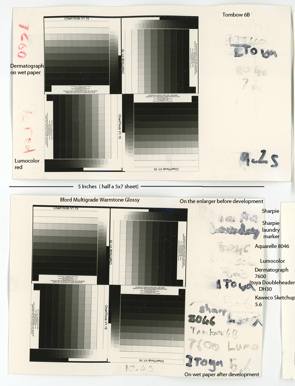

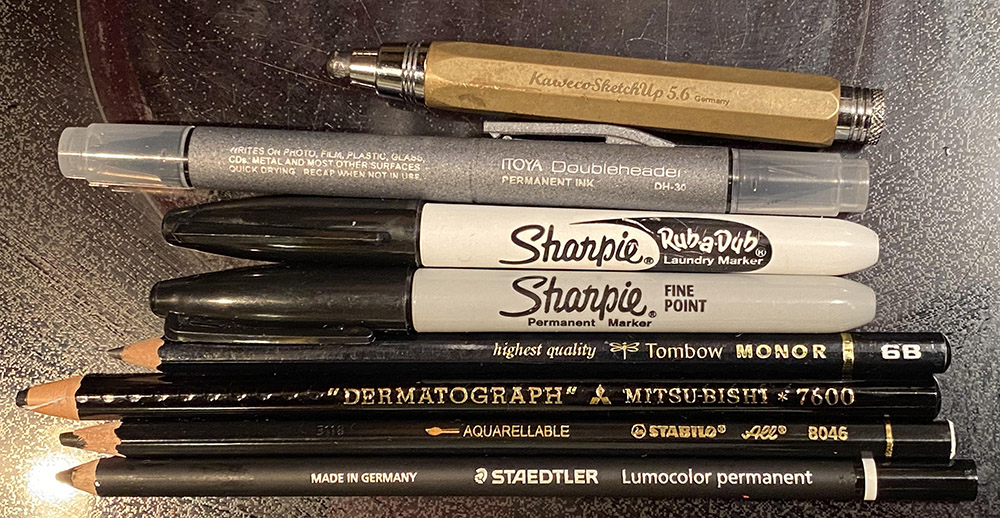

Here's a test of the markers and pencils I have. I would call everything except the Itoya DH30 a failure, and sadly that appears to have been discontinued. I found these:
and these:
online last night and bought a pack of the Milwaukee Inkzall pens.
My main use case is to be able to record the details of a test print before I forget them so its best recorded before I develop it. The Kaweco 5.6mm makes a smallish clear line that makes it through developing, but it is invisible in safelight red.
Kaweco Sketchup 5.6
Itoya Doubleheader DH-30
Sharpie Rub-a-Dub Laundry marker
Sharpie Fine point
Tombow Monor 6B
Mitsubishi Dermatograph 7600
Stabilo Aquarelle 8046
Staedtler Lumocolor permanent

@Graham06 and @Fatih Ayoglu thanks both for sharing your test results - this is very helpful!
It seems that on still wet paper (after squeegeeing off excess water), the pencil-type markers as well as the Pentel felt tip marker should work. That's encouraging. The Pentel marker has the advantage that the markings may remain even after the paper is rewashed (?)
