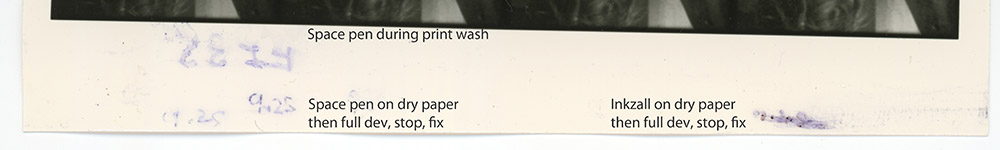

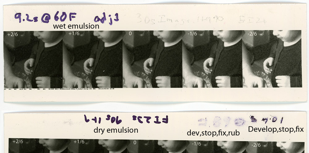

Here is a test of the Milwaukee Inkzall markers I tried. $3.50 for 4 made it worth the experiment. They write well on wet emulsion, and marks mostly make it through development but they can easily be wiped off ( e.g if you accidentally touch the text ). Wiped text does have a faint ghost image that remains. It's a finer tip than a fine sharpie, but still a bit broader than I would prefer. An early test testing marks through a token dev , stop, fix with a bit of scrap worked great but I didn't use the full times.
Close to the best result so far. I should have made marks with the other top contenders, but I forgot. Bought a broad black space pen refill; maybe it will work for me. Thanks @Mick Fagan for the tests.

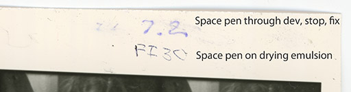

I bought a Space Pen refill #SPR4B (bold black) https://www.amazon.com/dp/B000FTGCFI and have just tried it, and it works the best so far. It writes nicely on dry paper under the enlarger, and the text washes out a bit during developing, but is still clearly readable (better than any other pens and markers) and the broad point is still finer than the finest markers I tried.
I pulled the print out of the wash water to write the time it took the image to emerge and the line is broad and smudgy but is still clearly readable. Not perfect, but good enough. Paper was Ilford warm tone glossy.
I also wrote the same info using the Inkzall as insurance and that washed out enough to be illegible. I also tried a 2B 0.7 mm clutch pencil and I couldn't even see where the marks were. The location is in the attached images somewhere. The fat 5mm pencil I tested earlier works much better.
Given that success, I bought a pen to hold it: a stainless Parker Jotter. The SPR4B refill comes with and attachment to allow it to fit into Parker refill pens
So this is recommended by me and at least two others on this thread. @koraks bought a medium refill and it didn't work for him. I don't know if a broad point works better, but I thought it would give me the best chance of success.
I think this is the end of this small side-hobby. If you find something that works better please post exact model details and perhaps purchase links, but I'm going to be happy enough with this. Thanks to everyone who posted recommendations and tests.
